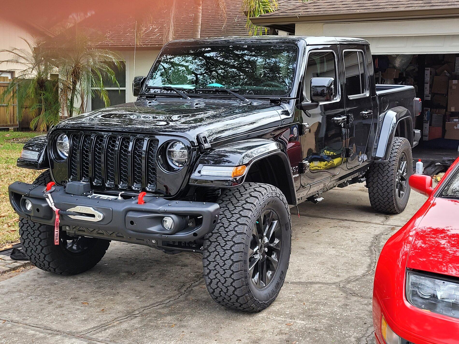

I run 33's on my Sport (285/70).
You can put 33's no lift but will likely need to remove those air foil pieces end of your bumper. Or swap out completely the bumper. Plenty of take offs available. If you use spacer lifts 1.5 spacers are about the max you'd go before you get into longer parts, hence complicating everything.
Another method is Rubicon fenders.
This is my Sport before and afters
Jeep Gladiator 2021 GLADIATOR SPORT LIFT ALIGNMENT SPECS 6343F9D5-E3BB-47CB-B2CA-EE94C2F19E69
