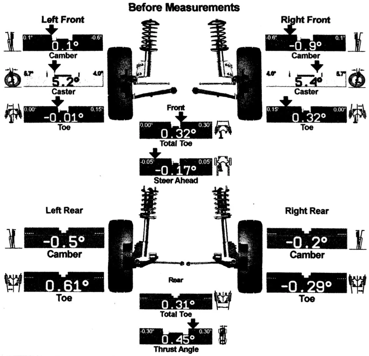

Got an alignment done post MOPAR 2" Lift and front & rear adjustable track bars installed.
Jeep Gladiator Teach me about my Alignment specs post MOPAR 2" lift Befor
Post Lift Install/Before alignment
- Camber is fixed.
- The Mopar Lift Caster is slightly above spec.
- Toe slightly out.
- Thrust Angle is out of spec.

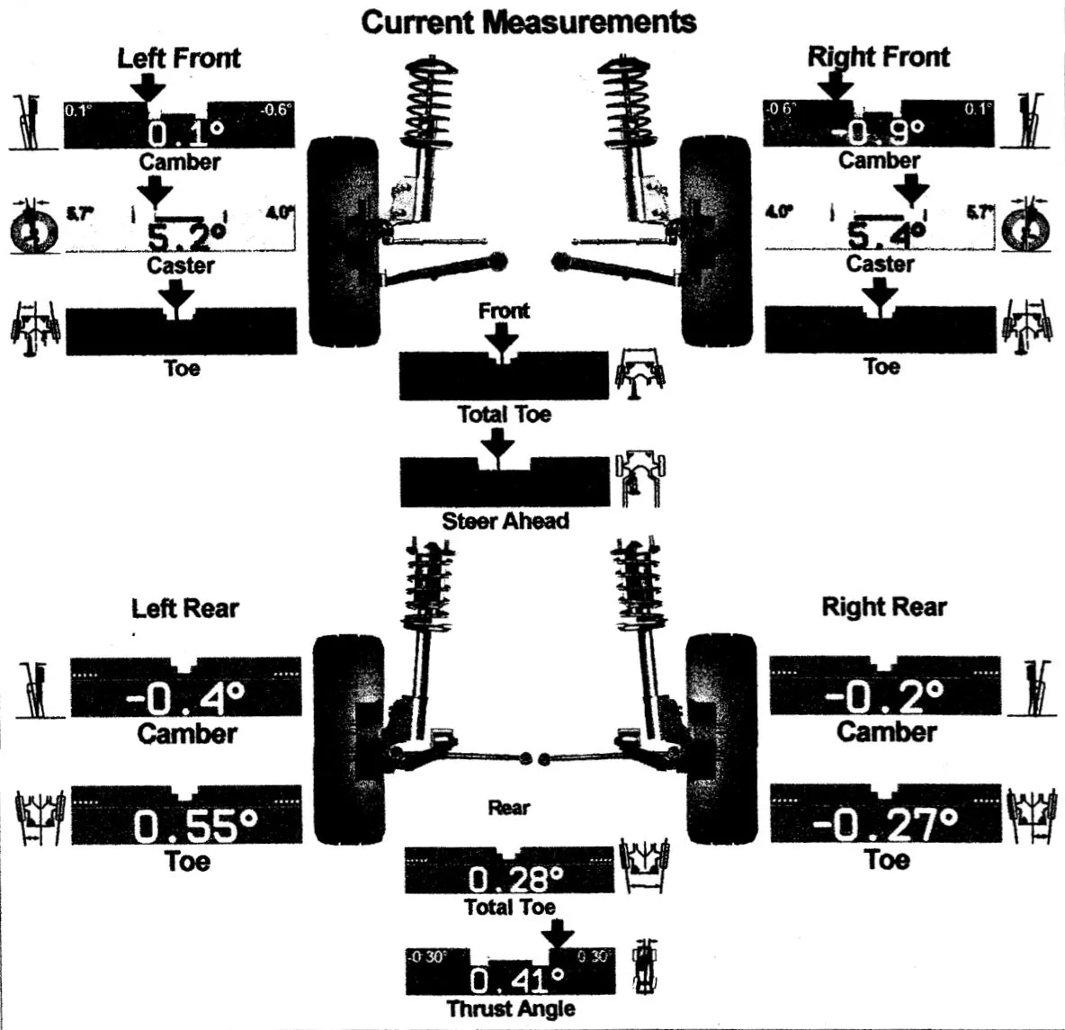

Jeep Gladiator Teach me about my Alignment specs post MOPAR 2" lift After
Post Alignment
- Camber fixed.
- Can't adjust Caster since the MOPAR Lift has fixed length lower control arms.
- Toe is pretty much straight ahead.
- Thrust Angle basically unchanged.
I have two questions...
1 - Should I get shorter control arms to get my Caster within spec or leave as is?
2 - Is Thrust Angle worth chasing?
All that being said, IT'S A JEEP not an F1 car. I felt no difference before and after the alignment.

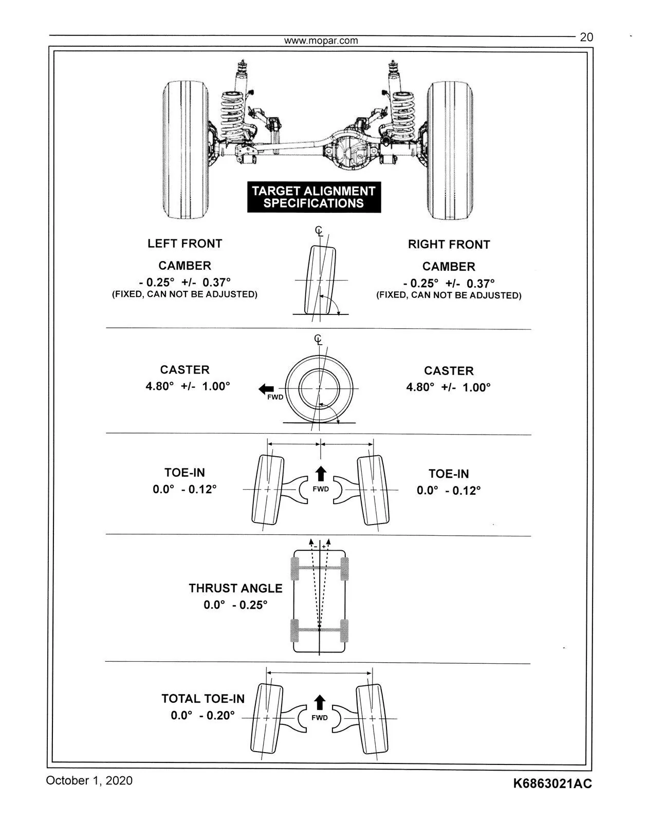

And yes, I did give the Alignment Shop the factory specs.

Negative toe means the forward edge of the tire is pointed outward and positive means it's pointed inward. Positive left and negative right like you have means your axle is slightly out of square with the vehicle centerline and the right side is likely very slightly forward of the left. The thrust angle is deviation from the centerline or basically half the left toe minus right toe. Those measurements are not that terrible but are pushing the limits of what I'd consider acceptable. Generally you need to be pushing toward a full degree of thrust to have it be noticeable and while I wouldn't buy parts to fix it, I would try to get that closer to zero on my own truck if I already had adjustable arms.
Front caster should be >5 degrees with a lift because it increases stability. Honestly I'd dial in anywhere between 5-7 degrees depending on how bad that throws out the pinion angle.
With solid axle vehicles, the only alignment things that change with a lift are axle centeredness (tends to shift driver side without a longer track bar) and steer-ahead. Total toe (which impacts tire wear) will not change but your wheel will be crooked as the drag link will typically be set too short. When people get alignments after a lift, it's either to properly set adjustable arms and track bars or they're really only fine tuning the drag link to get your wheel straight.
