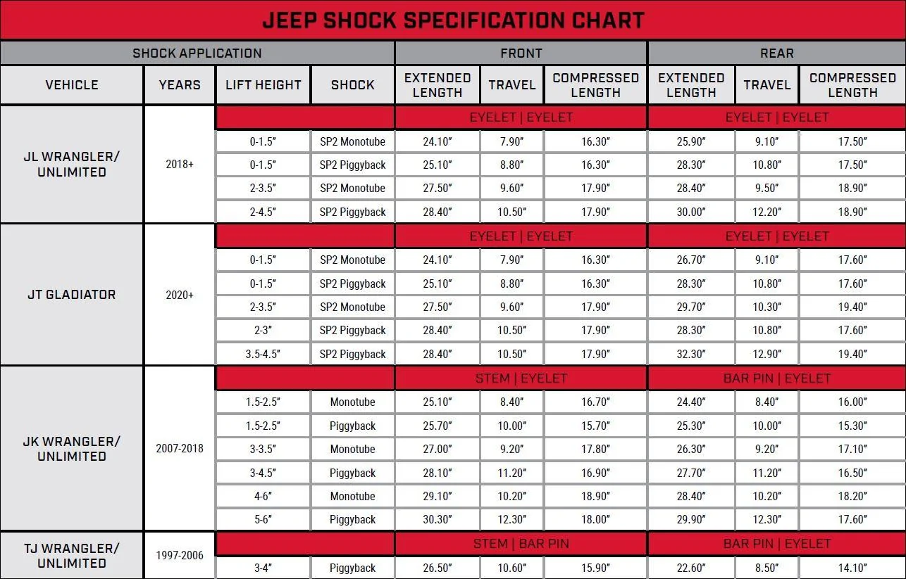

Was recently in the same investigation. Did you see this forum thread? I am going with a teraflex st4 lift and their sp2 3.x shocks. I really couldn't find the info on their site(s) about the total travel said shock. Fingers crossed they have made sure that front driveline isn't and issue. I have faith they do include spacers for the rear driveline so...
EDIT: to save you the reader having to read that thread, the magic number for shock travel from thread
If your front shocks extend further than 28.5”, you will need a new front driveshaft if you plan on off-roading and flexing the vehicle

I have specs of their shocks… and now you do too
Your awesome! Wow so literally just two tenths off of being in the red zone for driveshaft issues. Looks like teraflex are well aware of the issues. I guess it kinda sucks if a person wants the maximum flex, but in my case seems good enough I'm mostly street and trail so uh ST really is what I'm looking for :)

Thanks for the replies and info! So a shock length over 28.5” (specifically for drivers side) requires a new front driveshaft. Got it.
Now if I’m understanding this (and that chartcorrectly:
Stock travel is likely right around 8”, and can safely be increased to about 10.5” with a longer shock before driveshaft issues. (And the appropriate coils so the coil doesn’t drop out).
In theory lifts like Mopar or Skyjacker with the right shocks and coils can increase travel by about 2” before driveshaft issues. But to achieve more = new driveshaft.
