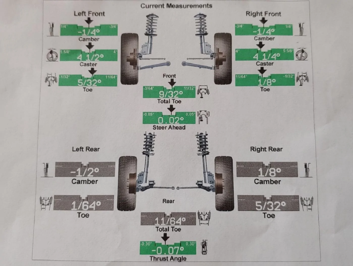

This is my one remaining problem with the mopar lift: pulls to the right, especially on crowned roads. I get a little left pull of road banked to the left, but LOTS of right pull the other way. Also tends to “bounce” to the right over dips. Caster is (and has been) symmetrical at 6.2, which I thought was odd not to dial-in some left bias to eliminate that.
That's almost describing mine. A bit of a pull to the right on crowned roads - almost a pull to the left when in the left lane. But if you are on a crowned road it does want to "lead" that way.
On a perfectly flat road it does go straight and the steering wheel is straight.
But since most of our roads have a crown to them or lean to the right.............
Oddly, my alignment indicates it shouldn't have any pull at all. Well, it doesn't when you are on a FLAT road.
