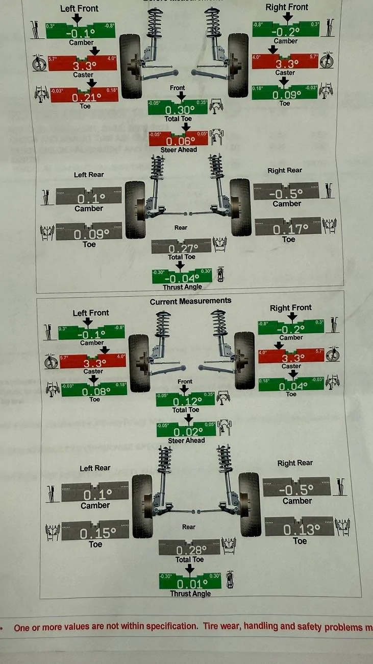

Camber is the tilt of the tires. Positive camber has the tops of the wheels tilted out further than the bottom. Vehicles pull to the side with more positive camber.
Caster is the imaginary line drawn through the upper and lower ball joints. The tilt forward or back of that line is degrees of caster. Negative caster tilts forward, positive caster tilts rearward. Vehicles pull to the side of more negative caster. Positive caster is what whips the steering wheel back to center after a turn and keeps you tracking in a straight line. We generally want positive caster at all times as drivers.
Toe is how the fronts of the tires point in or out. Like "pigeon toed" people, toe is usually slightly positive, meaning it points inward. Vehicles generally pull to the side of the least toe compared to dead straight 0.
Thrust angle is the imaginary centerline created by the rear end. It's not always the actual vehicle centerline. Vehicles tend to pull opposite the thrust angle.
From your readings I see no reason for a left pull. I'd assume it's a tire issue maybe.
I concur, based on the Toe measurements, you should be good. I know with my JL and JT it's the crown in the roads that cause it to "pull" persae.
I've spent plenty of time working with Hunter Alignment racks and everything looks normal for a Jeep

To clarify, it pulled when I picked it up after having the lift installed. The caster was less than 5 degrees, so the shop that did the lift suggested to do inserts to correct caster and camber...it still pulled. The rear axle wasn't square, so I corrected that. Still pulled. Took it to another shop, they found that all measurements (caster, camber, toe, SAI, etc.) were within spec and that it was pulling because of the tires. I cross switched all the tires, and it still pulled. I put the factory tires and wheels back on, and it still pulled. Took it back for another alignment check at a different shop, and they also confirmed the measurements and couldn't explain the pull. Eventually I found out about the pull compensation and it corrected the pull.
40,504
54,031
But the lift itself didn't do that, something the shop did wrong or some other factor.
A lift won't change any need for "compensation" unless it's done incorrectly.
So where/how did you hear about that compensation (which should not ever be needed with any lift)
Inserts to correct caster and camber? A lift can't change camber - it's impossible, so if it needed correcting it was off from the factory.
Something still is fishy here.............

I understand that the lift didn't make it pull, sorry if the post title is misleading. The only thing fishy is the shop that did the install. I had even called and talked to Clayton Off-Road about this issue. I sent them a picture of the alignment sheet, and they couldn't see anything to make it pull either.
In the end, it was a poor installation that caused the issue. But, again, I figured if someone else had a similar issue, I would pass it on. I found out about the pull compensation from AI. After an exhaustive internet search, I put the symptoms into Chat GPT and asked for analysis. It asked if the pull compensation had been recalibrated. I then checked it on Alfa OBD...
