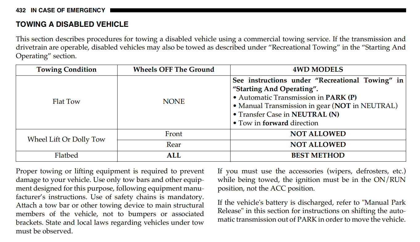

250
40,609
54,303
Good call. According to the manual, JTs can only be towed by 2 methods: flat or flatbed. p380 of the manual (382 digital).
No dolly or wheel lift where it's 2 wheels on/2 wheels off.
Wonder why your page numbers are so off or different??
432
The pages you mention are for crossing ravines, logs, getting high-centered, etc.
In any case, the page number doesn't truly matter - just wondering why so different - the end result is NO DOLLY and no "2 wheels up" towing according to "the book".

250
40,609
54,303
Wierd.
I'm looking at the '21 digital copy. Maybe different MY?
Must be model year - mine is a 2020 so I haven't bothered with a 2021 manual - I see no reason since it will cover things not even available in 2020 MY and mine is the latest release for the 2020 MY.
I bet that's it.
Oh well - fact is it was pointed out that the info is in the book.
