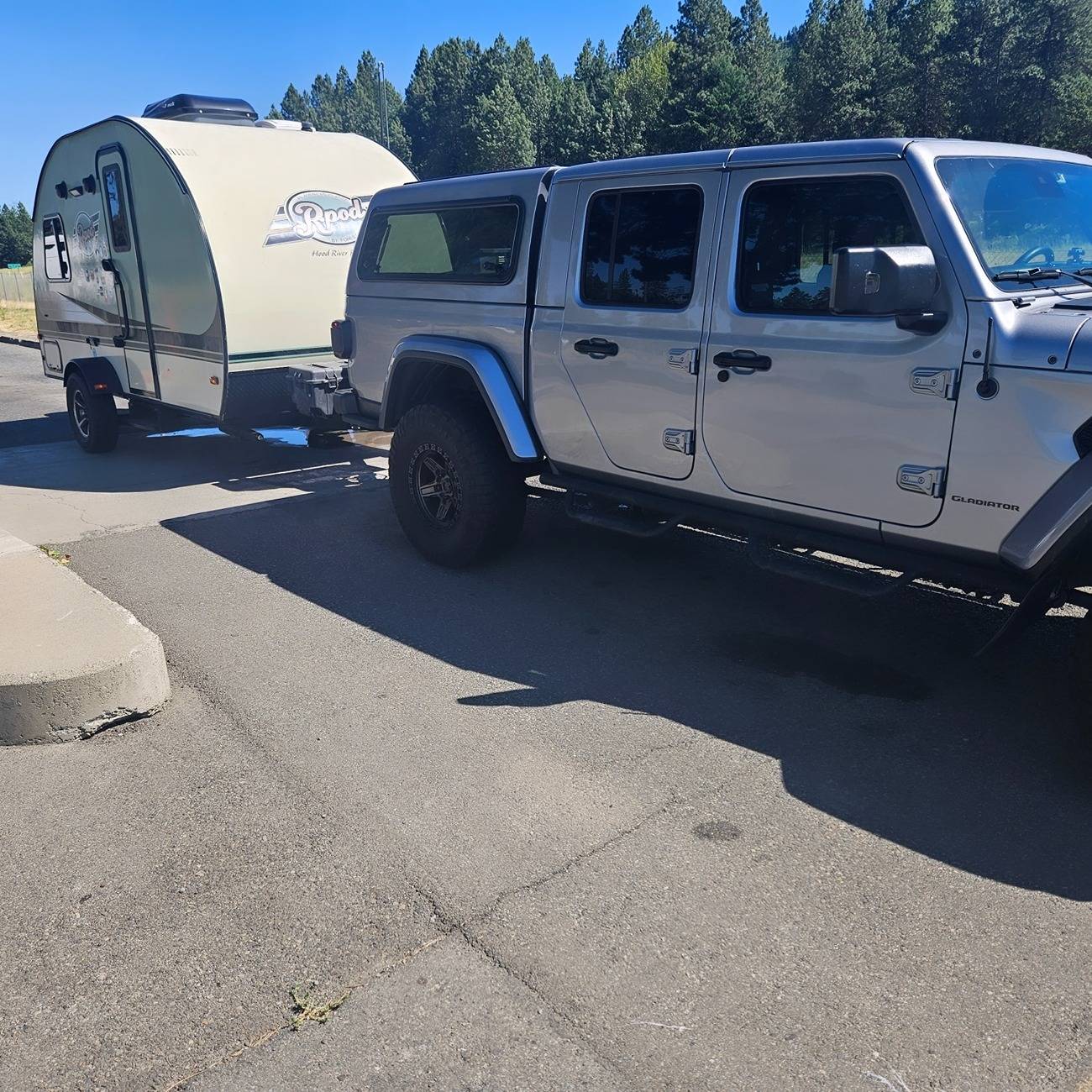

I tow our Rpod 172. Zero issues aside from the oil temp (2021 diesel) if dragging up the mountain passes if it's hot outside. Redarc brake controller is fantastic and adapts/learns as you drive. I do have rear air bags and it makes a noticable difference when aired up to 10psi.
I don't use a WDH and have never had any issues. Used to tow this same trailer with our Q7 TDI and was not able to use a WDH with the vehicle.
… what brand of cap is on your truck?

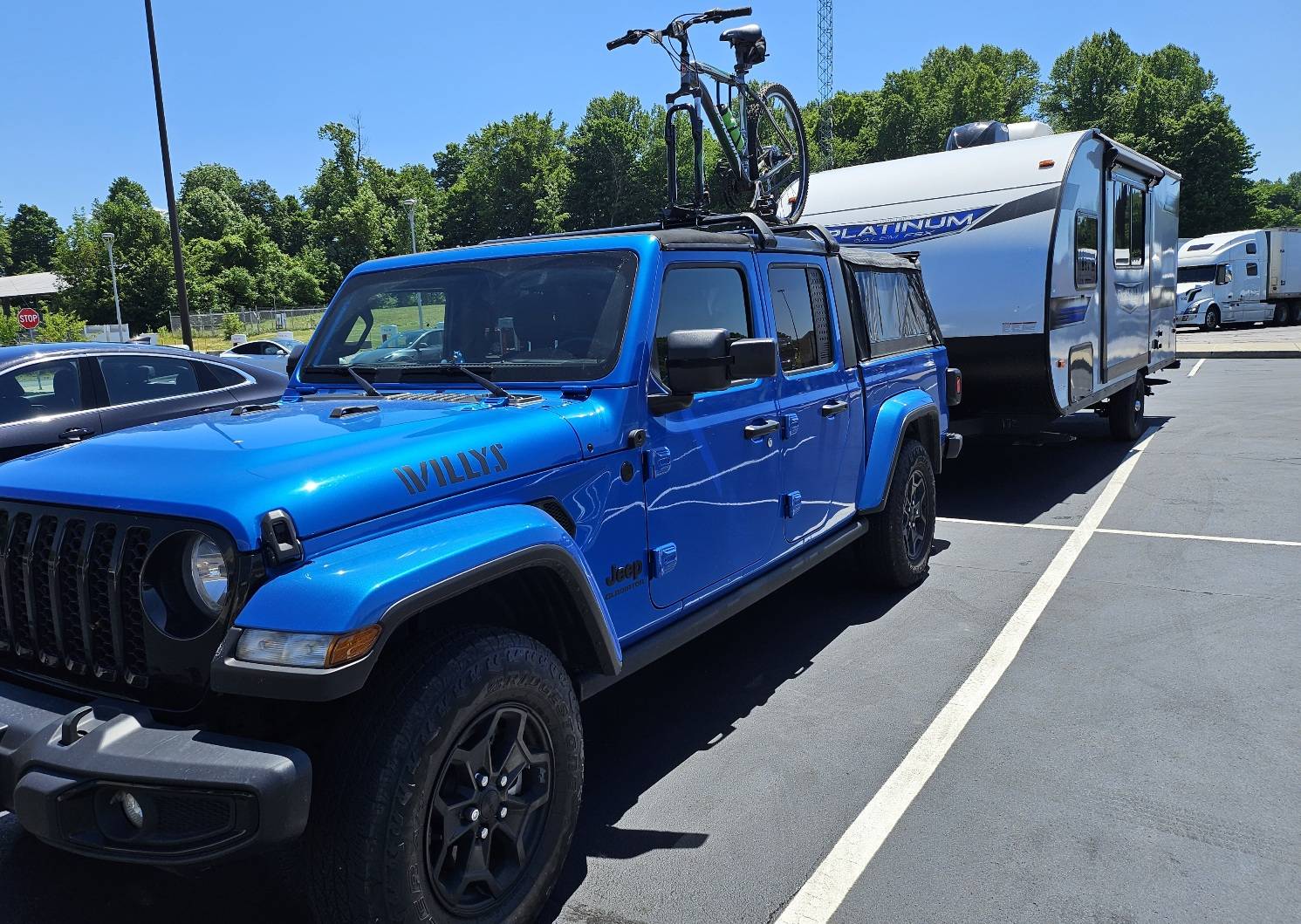

About 4200 dry and my 21 willys with tow package pull it well. Been thru Poconos, up to Maine, never felt it was too much.
Have the mopar brake controller and it works very well. Have e2 wdh which has friction sway control. I'm happy with the setup. Hoping to do a pretty nifty rear camera setup this spring when it finally warms up. Have consider air bags but so far I haven't felt it was necessary
Jeep Gladiator Gladiator camper hauling add ons?? 20240614_135650

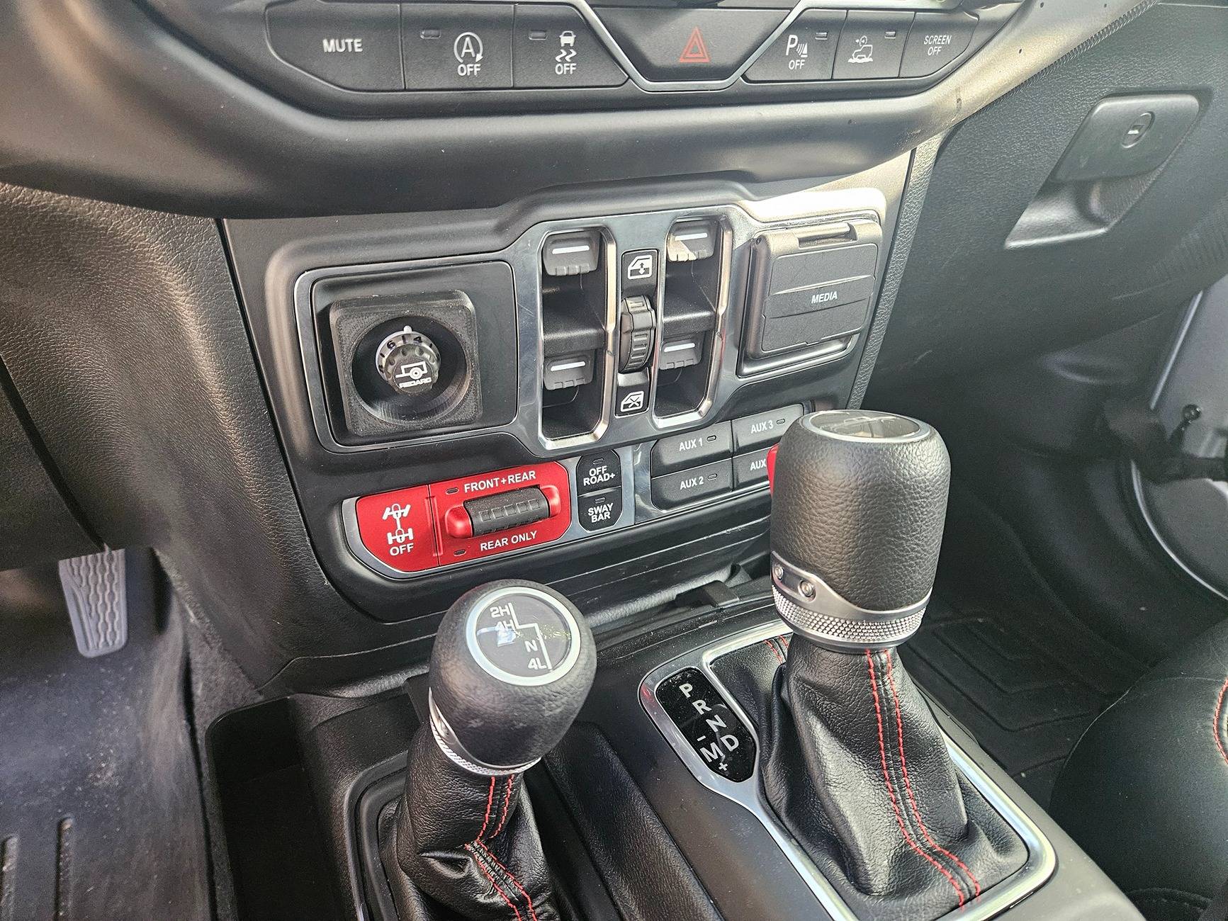

I've got a '22 gladiator Rubi, I replaced my 12v outlet for the factory break controller, it's a y plug so you could relocate the original 12v plug if you thought about it. The brain box for the factory break controller probably is meant to be installed before the driver front quarter panel and dashboard is installed, it's about a 4x6 or 6x6 box, I found the mounting holes but there's about zero chance you can get it in there or a wrench on if. The module fits very nicely in between the supports under the steering column though, like a glove
