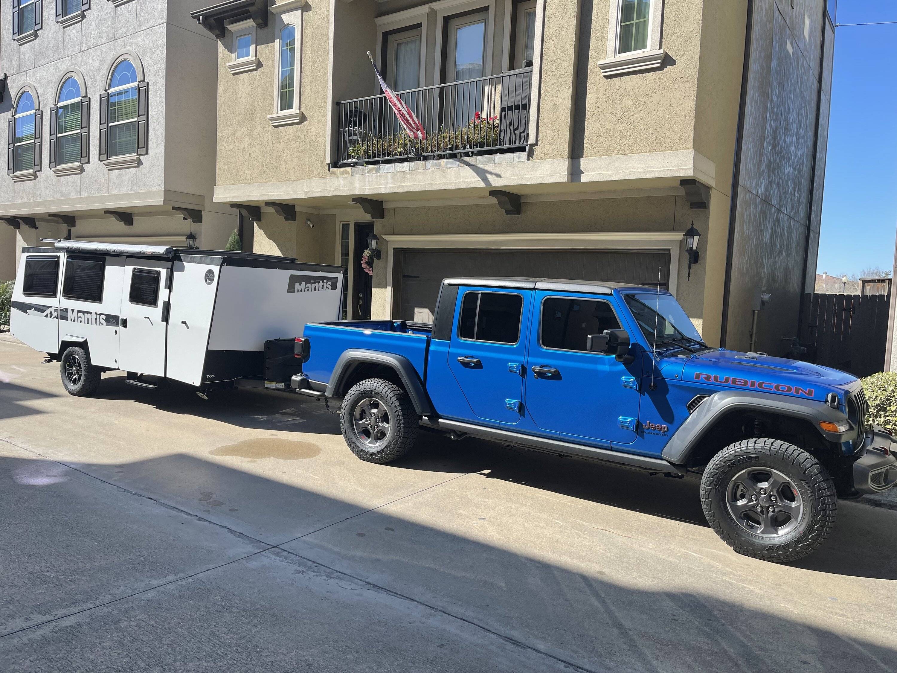

love any kind of camper talk. Im not with the big boys yet, just got a free pop up 2 years ago and was my first experience towing/backing a trailer up but looking at travel trailers now, seeing as Im sure mice destroyed my popup canvas, but anyways. May not be completely relevant to this thread but saw this the other day and had me wondering why it hasnt been on a range of trailers before...that I know of. An ABS system. https://www.lci1.com/products/rv-supplier/abs

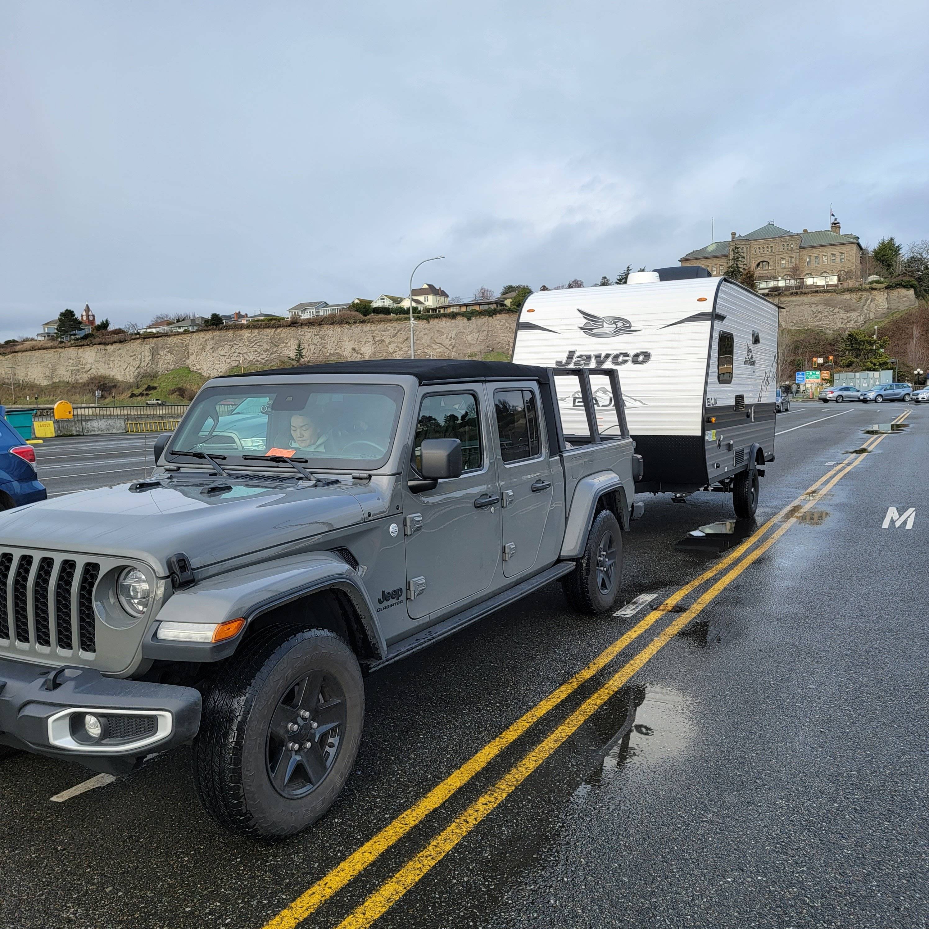

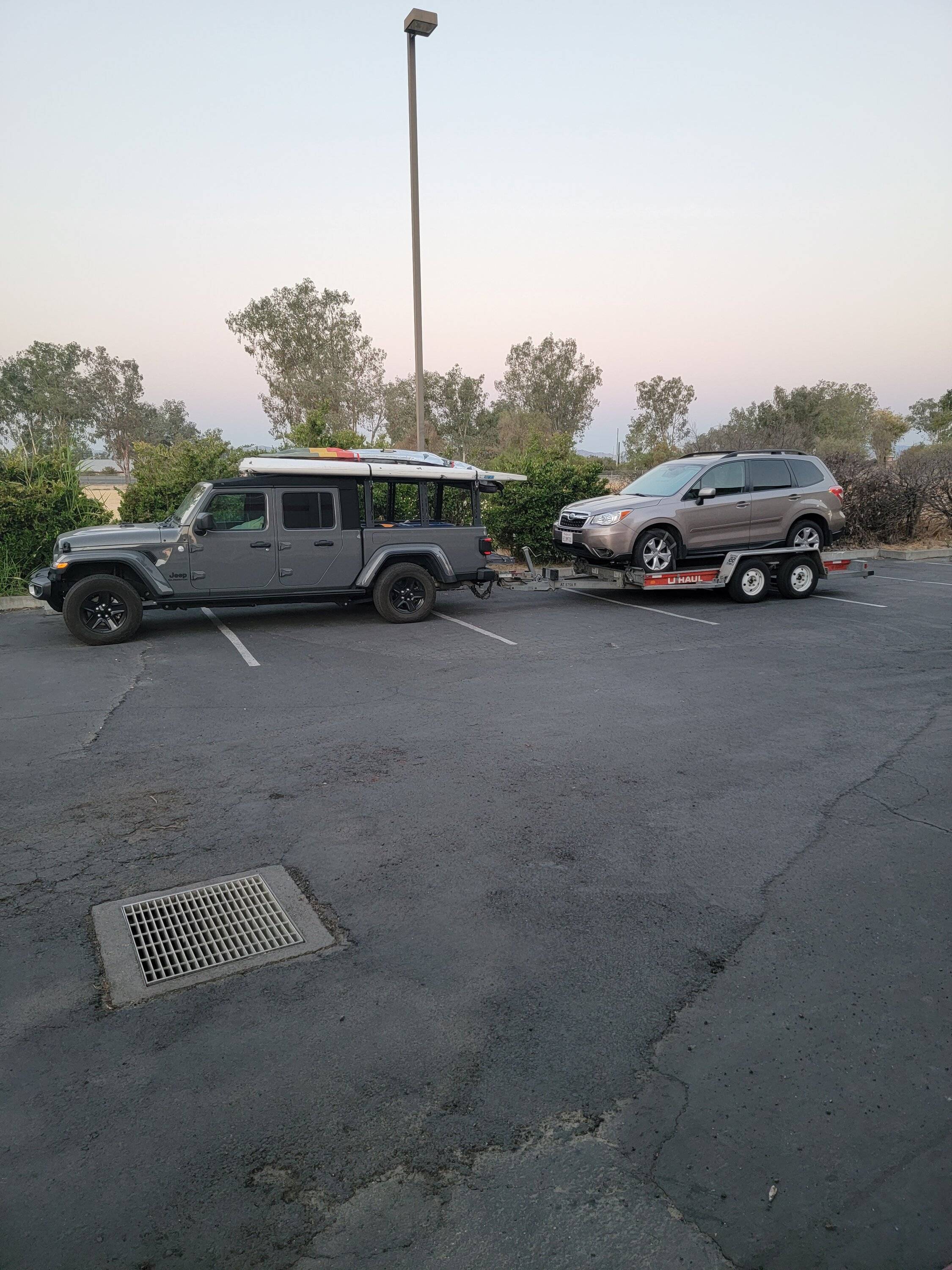

I experienced the same. Felt easier pulling 6500lbs (u-haul car trailer + loaded up Subaru Forester) than to pull my 3600lb Jayco Baja.
My simplistic brain computes the air flow moving over the top of my jeep hits the trailer vice continuing to flow over the car trailer.

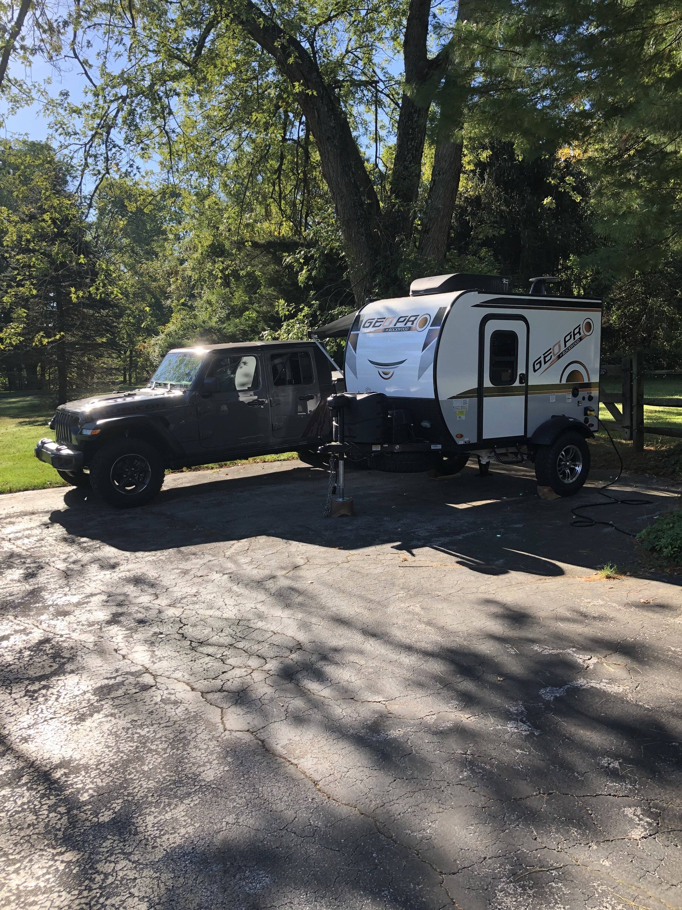

I’m getting ready to add AirLift 1000 bags and a Curt Echo to my JTR. My mileage isn’t too bad pulling my GeoPro 12RK. When my Sunrider is open it seems to redirect drag somewhat, maybe ? that’s why?

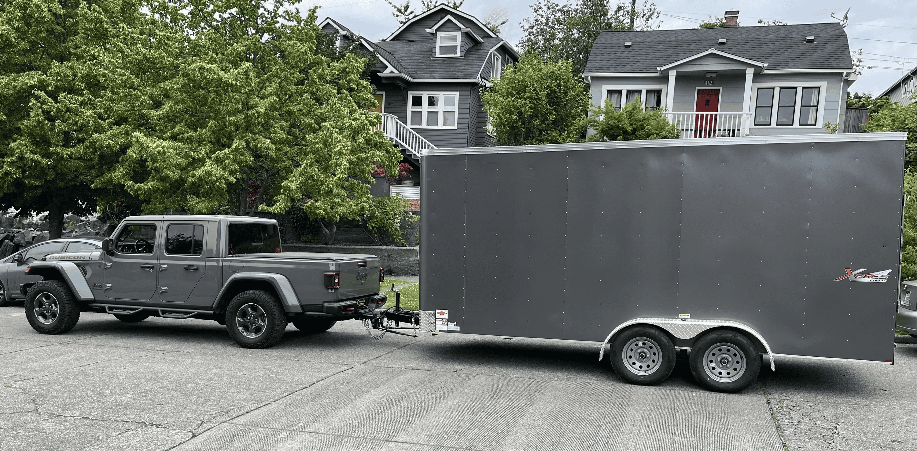

My Nephew-in-law(!) moved from Seattle to the Central Coast of California last June. I towed his 16 foot enclosed trailer that weighed 4500 lbs loaded. Took it to a commercial scale so I know that's accurate.
I used the Curt Echo - worked great! - and I even bought rear bags but ran out of time to install them before I left California
Jeep Gladiator New camper specs tempImage7yMwcY
. So you can see a slight squat but not bad at all.

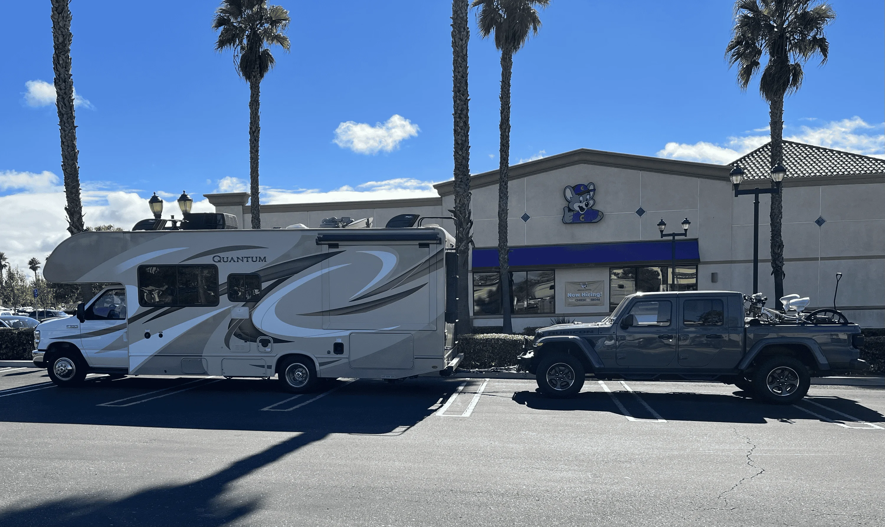

It towed just fine well over 1,000 miles. I would CONSIDER towing a travel railer if I had one but I own a 26 foot Class C RV and tow my Gladiator with it!

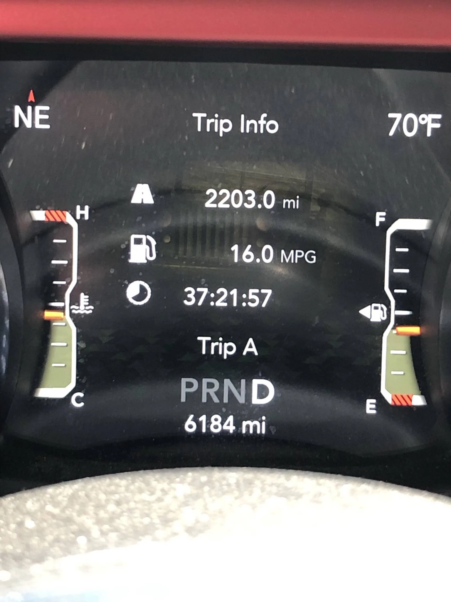

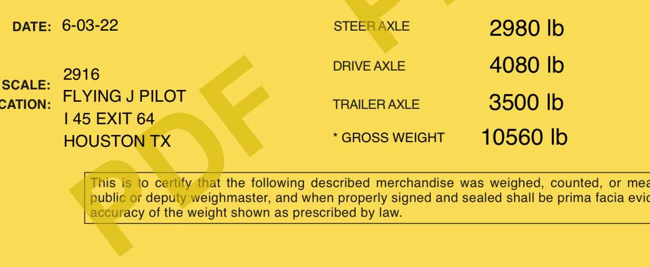

taxa outdoor mantis, 4,000 miles trip and average 19 mpg , I have the ecodiesel with the mopar trailer brake controller.
on the scale was fully loaded.
