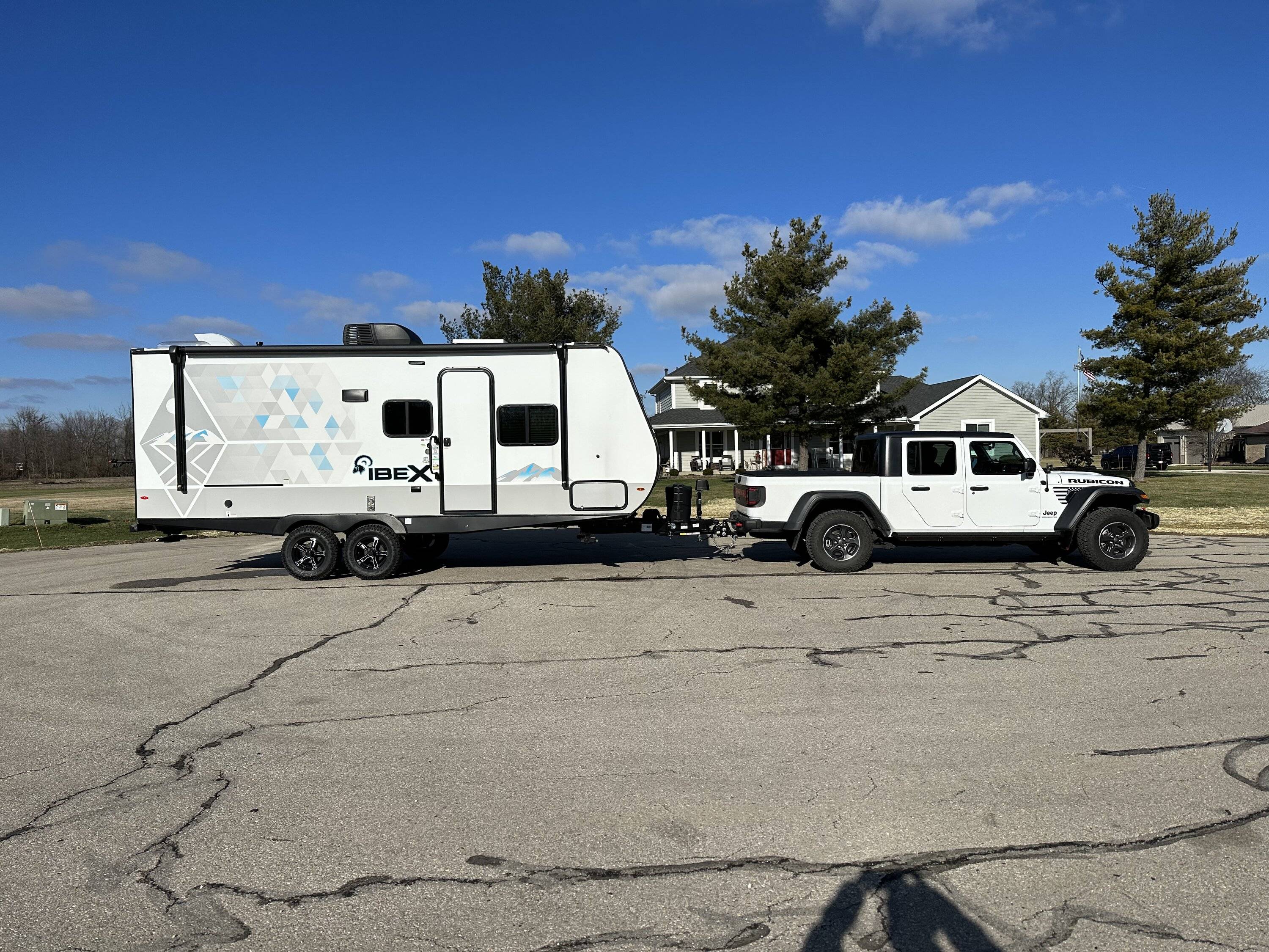

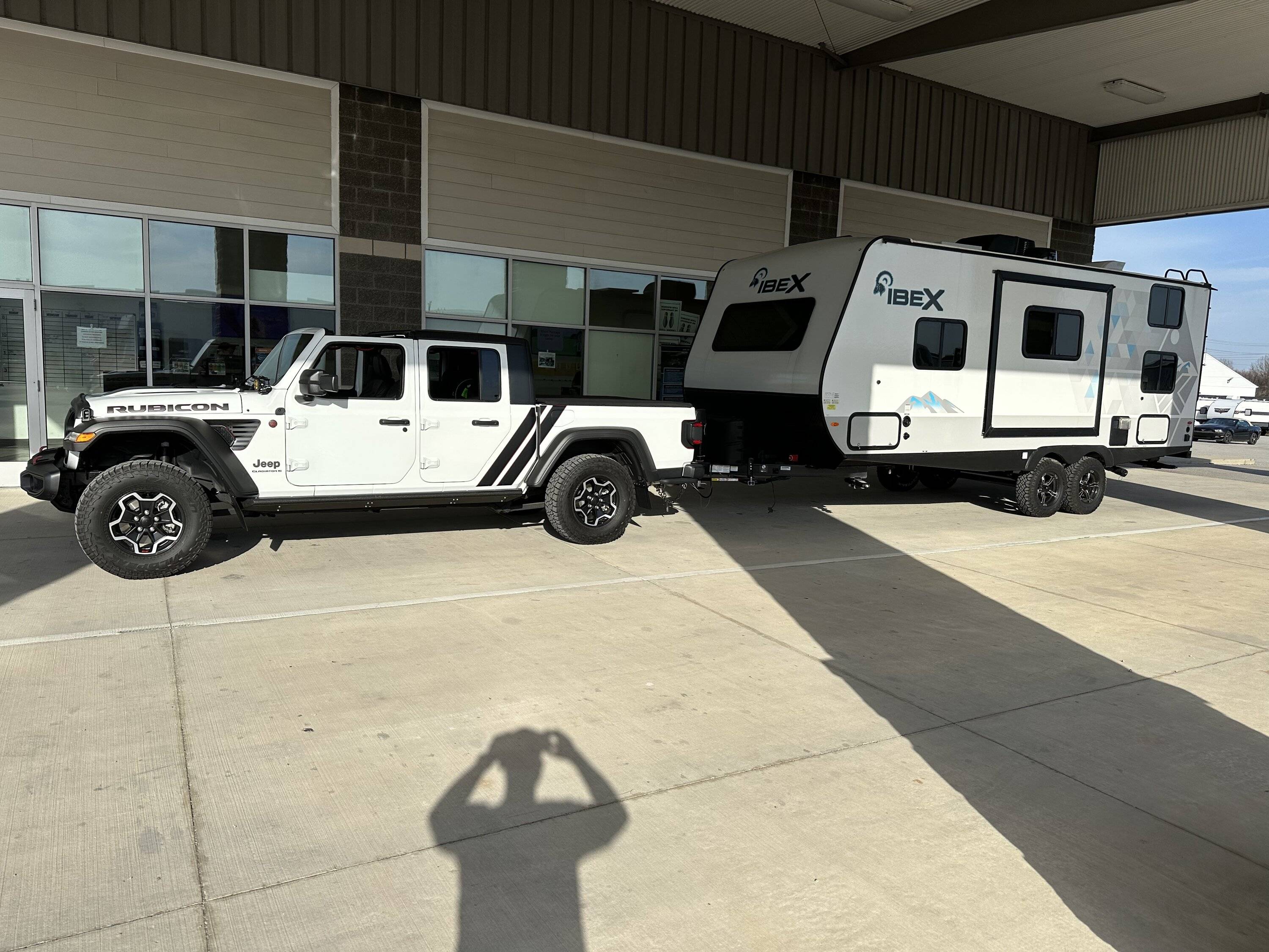

I just pulled my setup for the first time and am very happy with how it pulled. like others have said, a good WDH and proper setup are key. My trailer tongue weight is 510lbs with an unloaded weight on 4500lbs. I’m estimating being closer to 600lbs tongue and 5500lbs loaded. Manually shifting helps a ton and don’t be afraid to let it rev out when it needs to. I got 9.5 mpg in decent winds pulling on the highway and in heavy traffic going 65-68. Don’t be in a hurry and I think you will be just fine

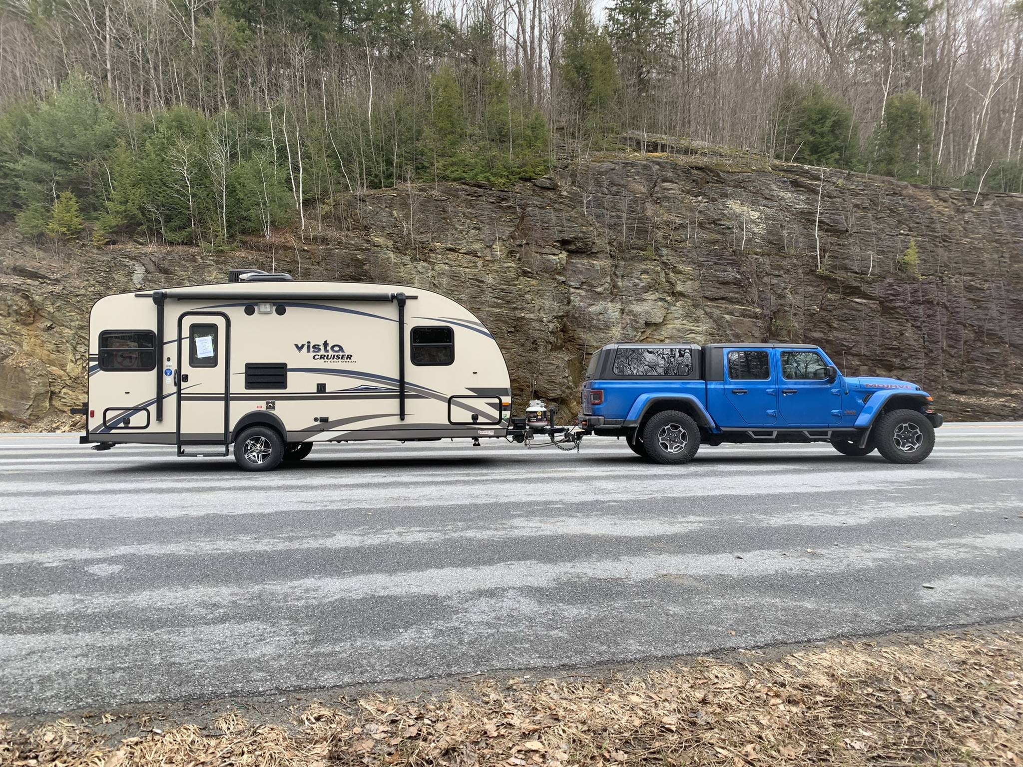

Top of the ball is supposed to be about 21”, dealer told me that and he was right. Your WDH should have adjustable height, install the WDH and don’t tighten bolts up until you get height right. Facebook can be your friend for getting a WDH, I got a Blue OX Sway Pro for $200, like new works great. Also when setting your camper up, the rating of the bars should not exceed the actual weight by too much, in my case my 24’ camper has a 380 lb. tongue weight but that used hitch had 1000 pound bars, found a set of take off 500 pound bars at my dealer for cheap. Blue Ox factory receptionist even knew all about the hitch, said that the Sway Pro pro relies on the bar being under tension and a little bent for the sway prevent to work, and it works great. I just bought a used 8,000 lb camper to set up on the Bay in Delaware and guy gave me the WDH that he used. Look around there are a lot of real nice used hitches for sale…..Jack

Use you tube or instructions to set it up but this is how mine looked after a quick hitch up at dealer in Vermont for ride back home to Pa. , 7 hours. Measure the height of your fender front and rear before and after setting up hitch, the rear should be closer or just a little low and front should be about the same but not higher. Your Jeep can tow that camper but will know it is there, mine has a curb weight of 3100lbs.and GVWR of 4100lbs. It is comfortable to tow and Mojave handles it great….
