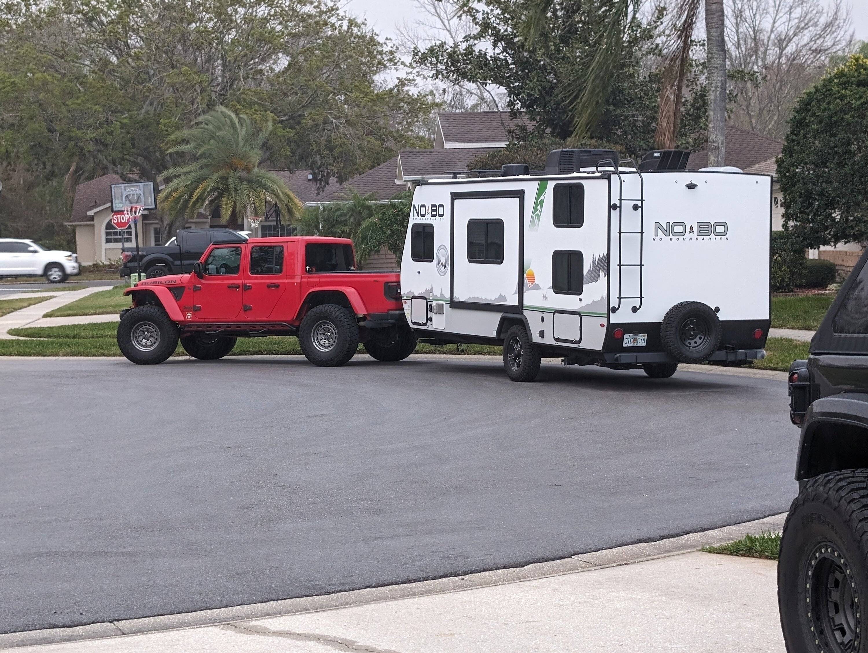

So I picked up our new camper today, a No Boundaries 19.8, and of course the weather decided it needed to not cooperate. Drove the 3 hours home in 25-30mph sustained winds and 50+ mph gusts. Surprisingly with the blue ox 2 point, not a lot of drama or real issue with the tail wagging the dog.
Power was a bit lacking in to the head wind but I expected that. Overall really happy with how drama free it towed in what are probably some of the worst conditions I'd normally be facing.

Yes, the Clayton's are a triple rate with a higher spring rate of 159 for stage 1, 280 for stage 2 and 360 for stage 3. The 3 stages really help with heavy loads and limit squat very well. I carried 1600 pounds of tile on a very short drive home with 700 pounds of people in the car and still had a few inches of space between the rear bump stops and the plate.
Some blasts moved the truck and trailer but it was always as 1 unit, not a case of sway or ever feeling like the trailer was trying to do it's own thing.

They're d rated falken wild peak RT's. When towing I have them around 40-42 in the back to up their stiffness. Didn't notice any tire squirm like I did when I had 34.5 pmetric tires on my ram 1500.
