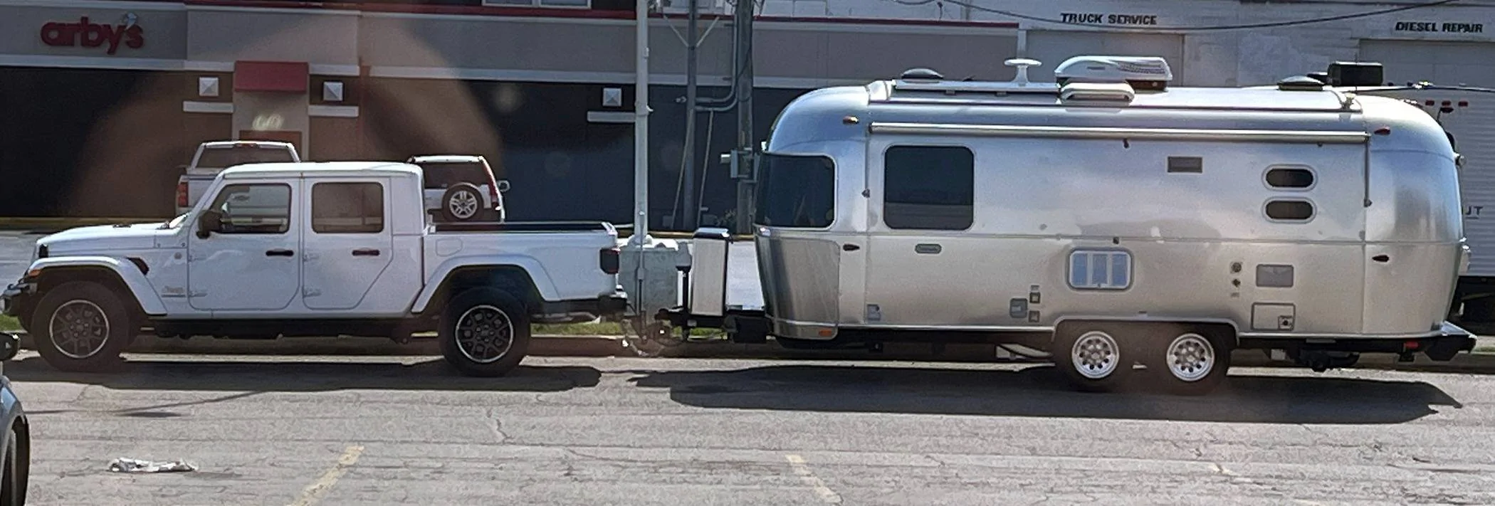

This is my first post here. I'm a little late to the party, but I only recently traded my '16 JKU Rubicon for a NOS '22 Gladiator Overland. I picked up an Airstream Globetrotter 23FB last week and towed it home to eastern Iowa from Columbus OH. I have the stock FCA brake controller installed and the GT came with a Blue Ox Sway Pro. My Overland has a 6k tow rating. The GT is 5300lbs dry with a 590lb tongue weight. I've been towing with all kinds of tow vehicles and trailers since 1987, so I'm conversant with the subject. I've towed a Scamp 13 with an '81 Scrambler (both new in the day) to a '94 34' Airstream tri-axle behind an Excursion. Here's my observations of the Gladiator/Airstream/Blue Ox SwayPro:
I left the Airstream dealer, hit the freeway and almost immediately encountered the onset of a sway event. Knowing that the tongue weight on the GT is only 9% instead of the desireable 12-15%, I headed back to the dealer. We aired the rear tires up to max (only 40psi,) dropped the hitch ball on the drawbar one hole, and cinched the chains up one link. Dropping the hitch ball was to try to increase the effective tongue weight, dropping the chain link was to put more weight on the Jeep chassis, and of course airing the tires up was to make the sidewalls more stiff. I stopped twice more on the 500 mile trip home to cinch two more links up on the hitch. I should mention that I drove home in 30mph side winds with gusts to 45mph so they were about the worst conditions you can tow in. The truck had plenty of reserve power and the OEM brake controller was remarkable in its seamlessness.
The end result is that I could safely do about 58mph max, but I got it home just fine. I like to tow at about 65mph normally, so it's do-able at 58mph with the SwayPro. I have options. I could continue to try to find the sweet spot for the Sway Pro, abandon the radials it has on it for 8ply truck tires, and try to pack the trailer for more tongue weight. (I was also winterized, so the trailer didn't have it's load of 39 gals of fresh water on board which I've read on these trailers helps.)
I opted for the "easy button" solution. I bought a ProPride 3P hitch I found used locally for $1200. I'll get it set up and in play and report back what the difference is.

Sway is mostly controlled through tongue weight so I'd think getting that up will help a lot. The 3p hitch will help the truck move as one for the semi-suck and wind blows but a badly loaded trailer will still try to sway and move you around. Also make sure you aren't over distributing the weight forward or you will take too much weight off the rear tires. In the picture it sure looks like you might be a bit over distributed but it could just be the angle.
I noticed that I may have been a tad over-distributed in the photos too. The ProPride will extend the tongue about 14" and add a couple of hundred pounds to the hitch weight. It'll work out.
