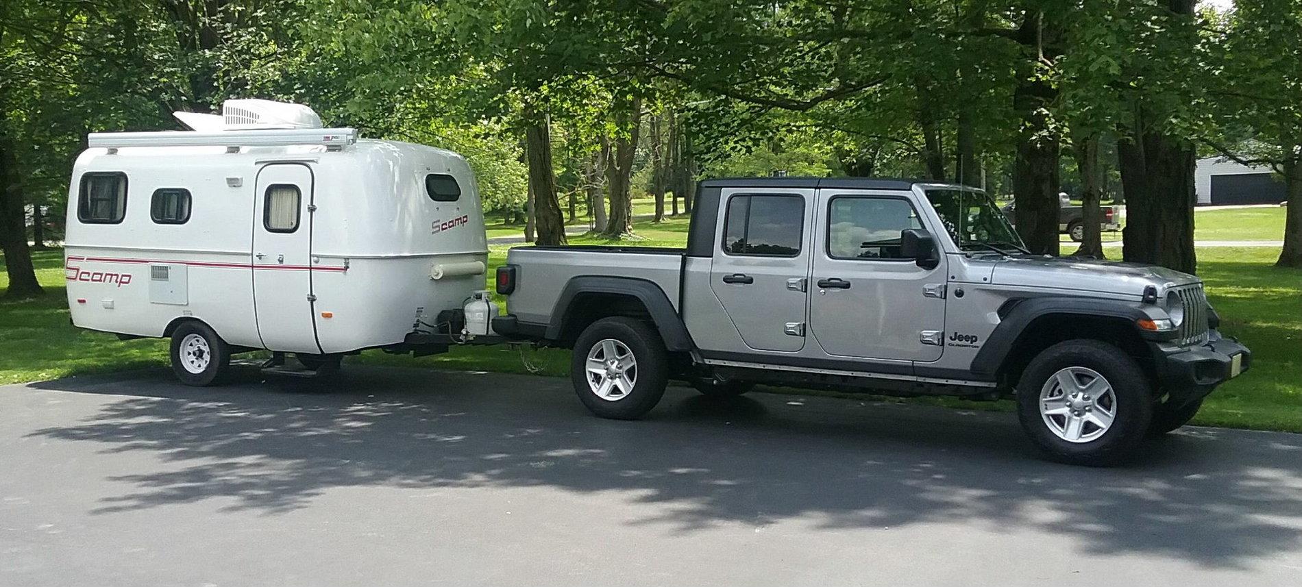

Here is what I tow and I chose the Max Tow option:
Jeep Gladiator New to towing, never towed in my life. Need help JTScamp1.JPG

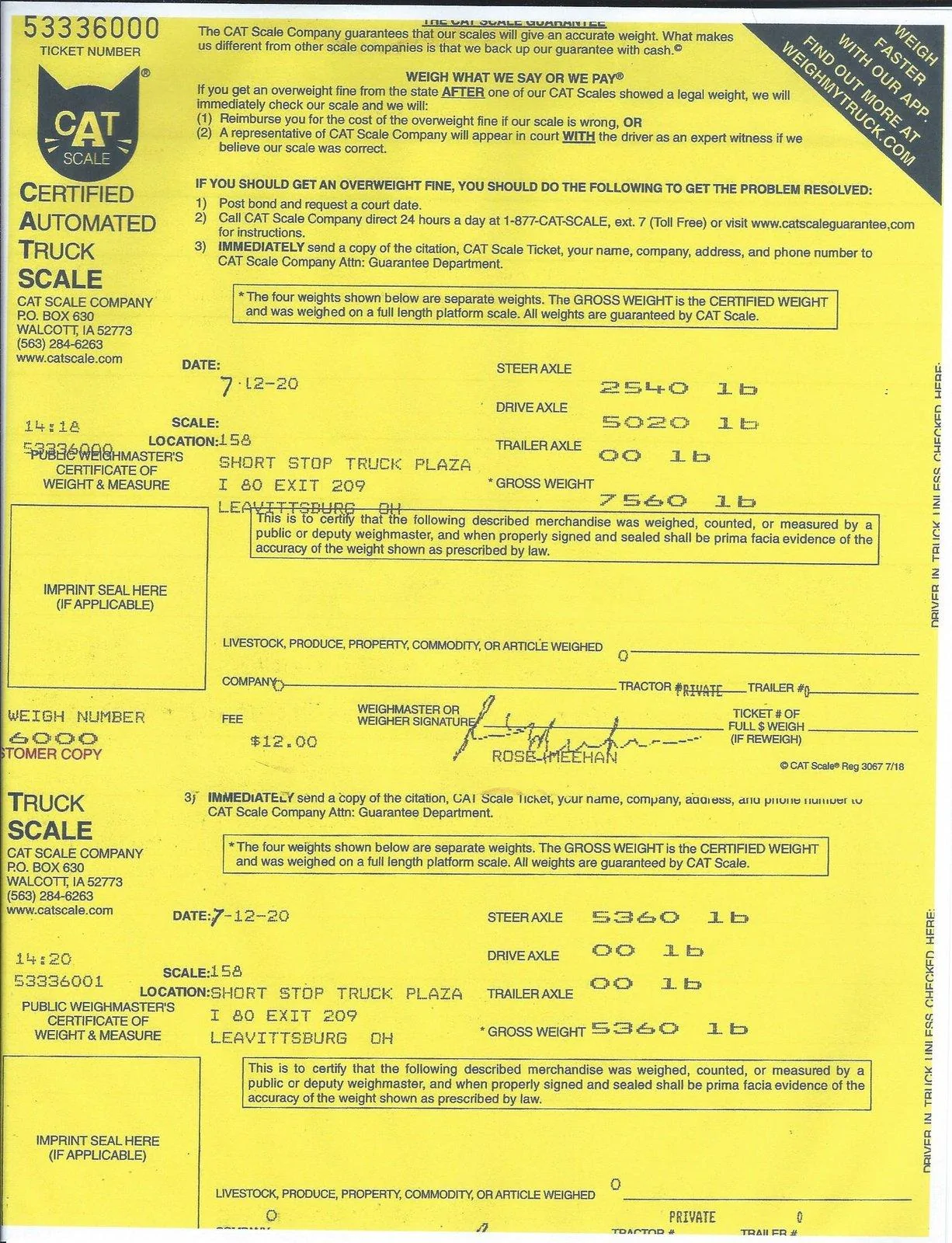

Here is the Cat Scale readout with truck loaded for camping:
Jeep Gladiator New to towing, never towed in my life. Need help CatScal
First half shows the total weight 7560# The second part shows the truck disconnected weighing
5360# So the trailer weighs 2200# and the tongue weight of 240# is included on the truck weight of 5360#.
It's a fiberglass Scamp 16' trailer. No WDH needed, it has electric brakes, crapper, fridge, hot water heater. EZ to hook up and go. I get 18+ MPH on flat. It is good for just the two of us. It's not an off road trailer.
