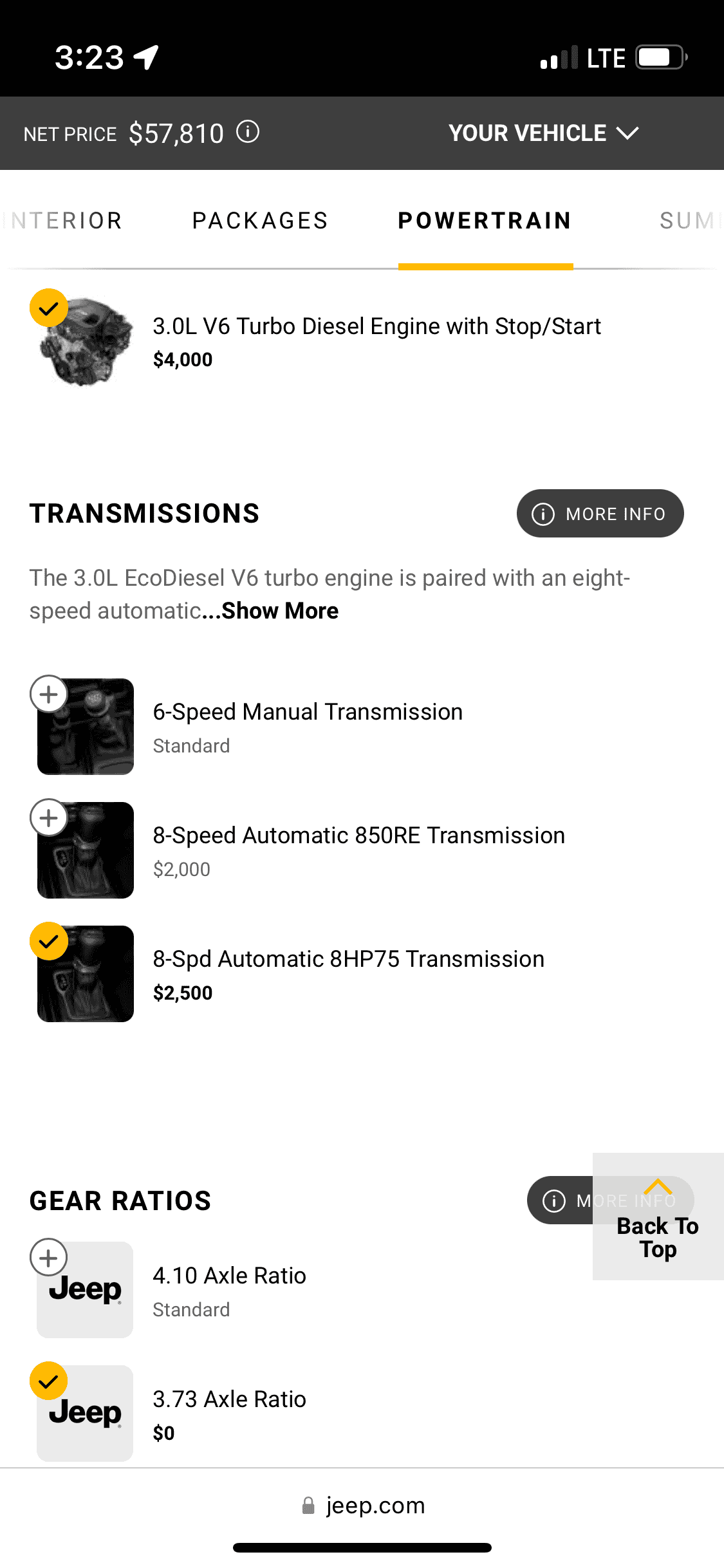

Jeep Gladiator Gladiator Engine Choice F91E8088-412B-4BEA-BA51-7D4BB03FE570
I’m not saying your wrong but since the Ecodiesel has been put in the Gladiator it has only been offered with 3.73. Even when you build a 2023 Rubicon it forces you to 3.73. Just may want to check on that with your dealer.

FYI, the EcoD will not come with 4:10's no matter trim, the build website is goofy. All EcoD's come with 3.73 gears period.
