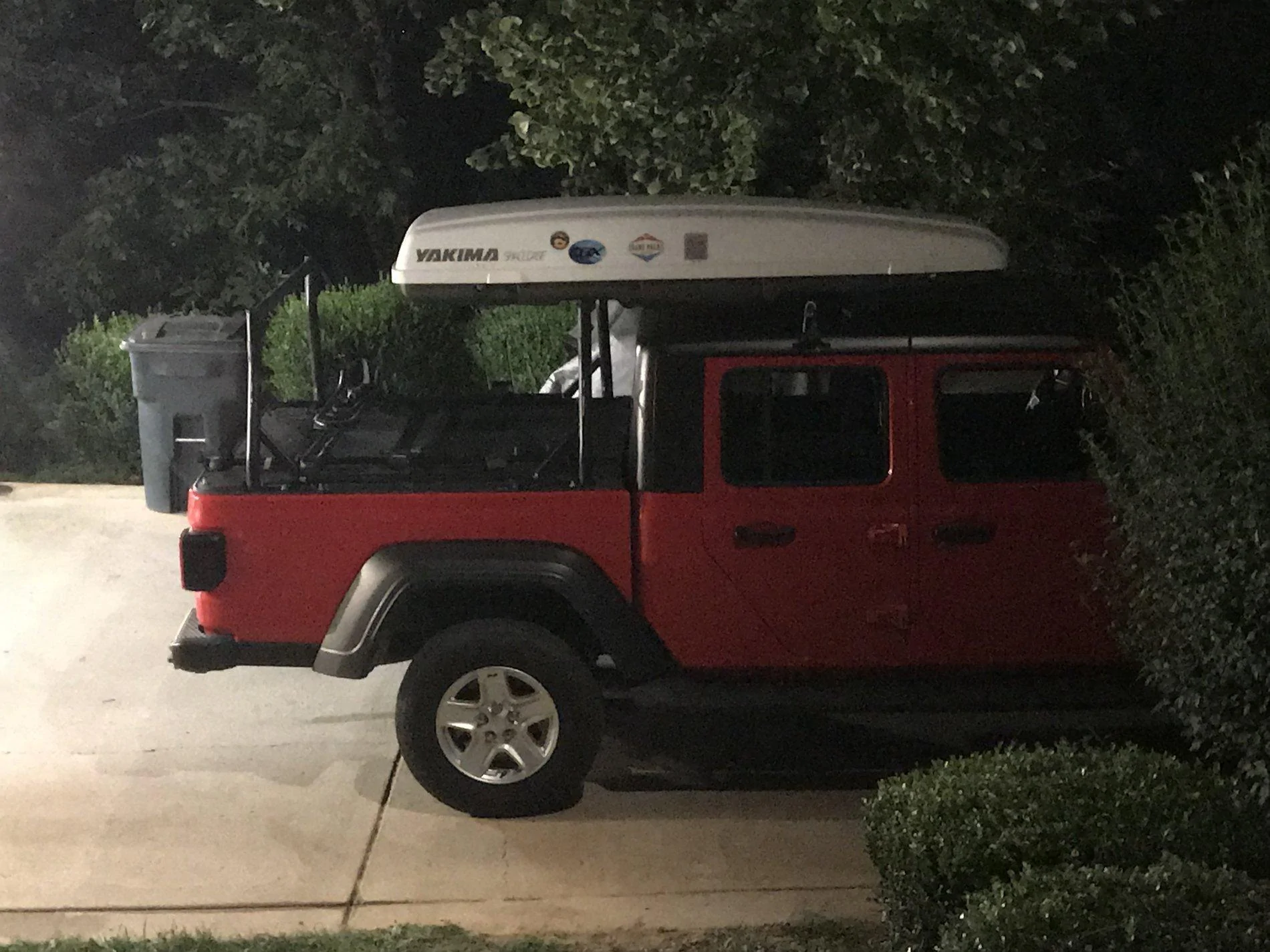

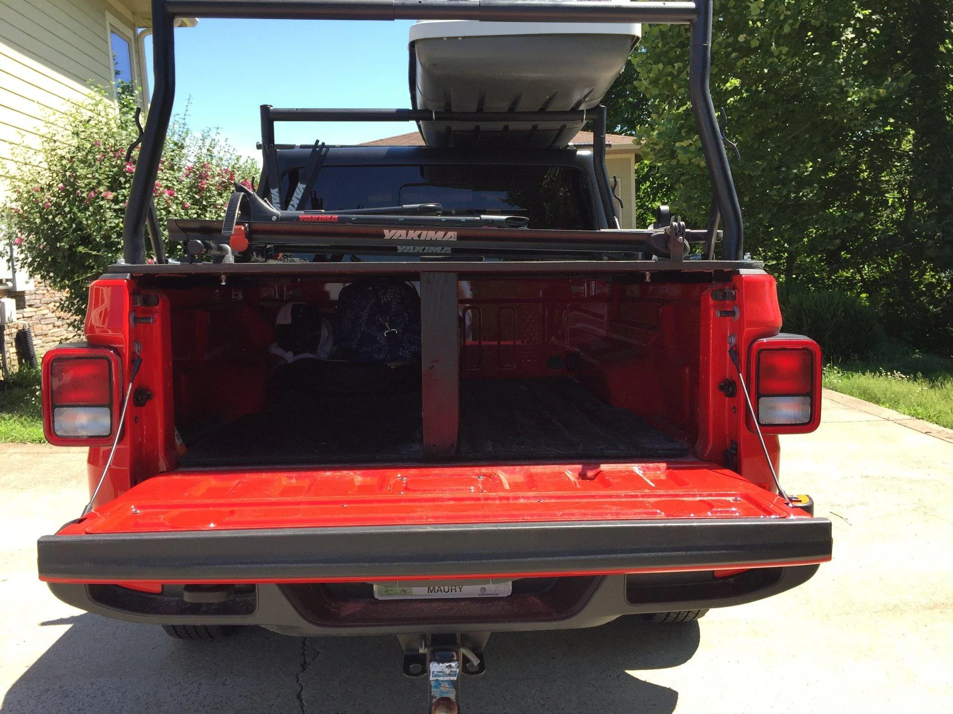

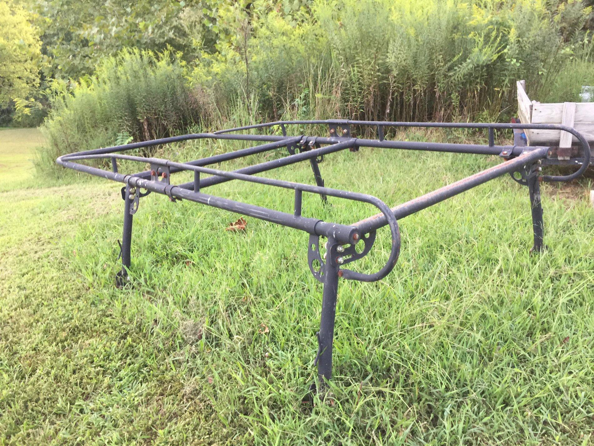

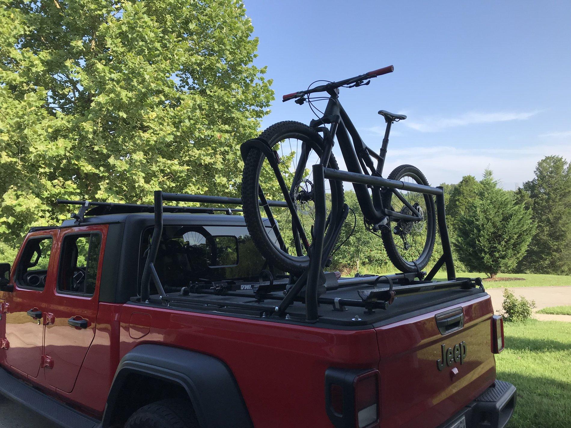

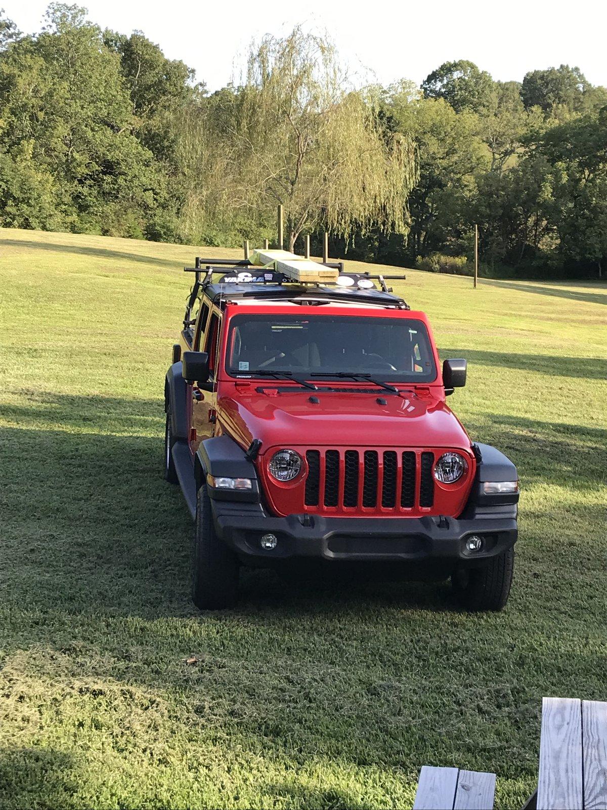

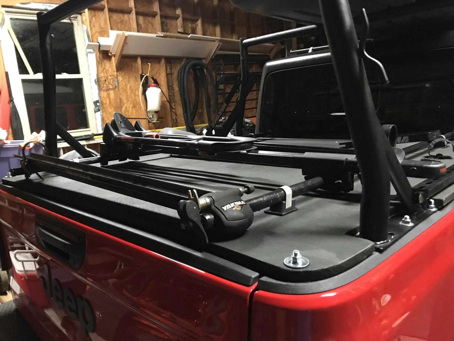

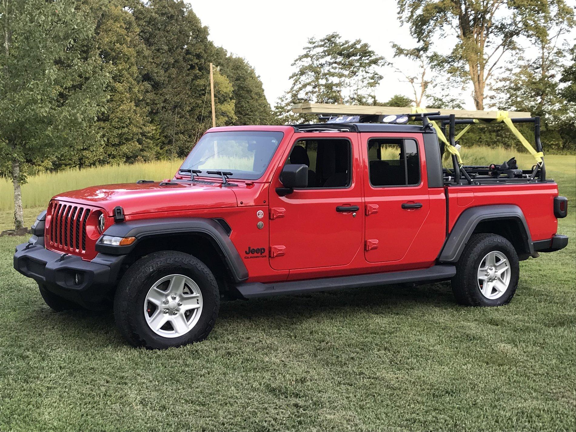

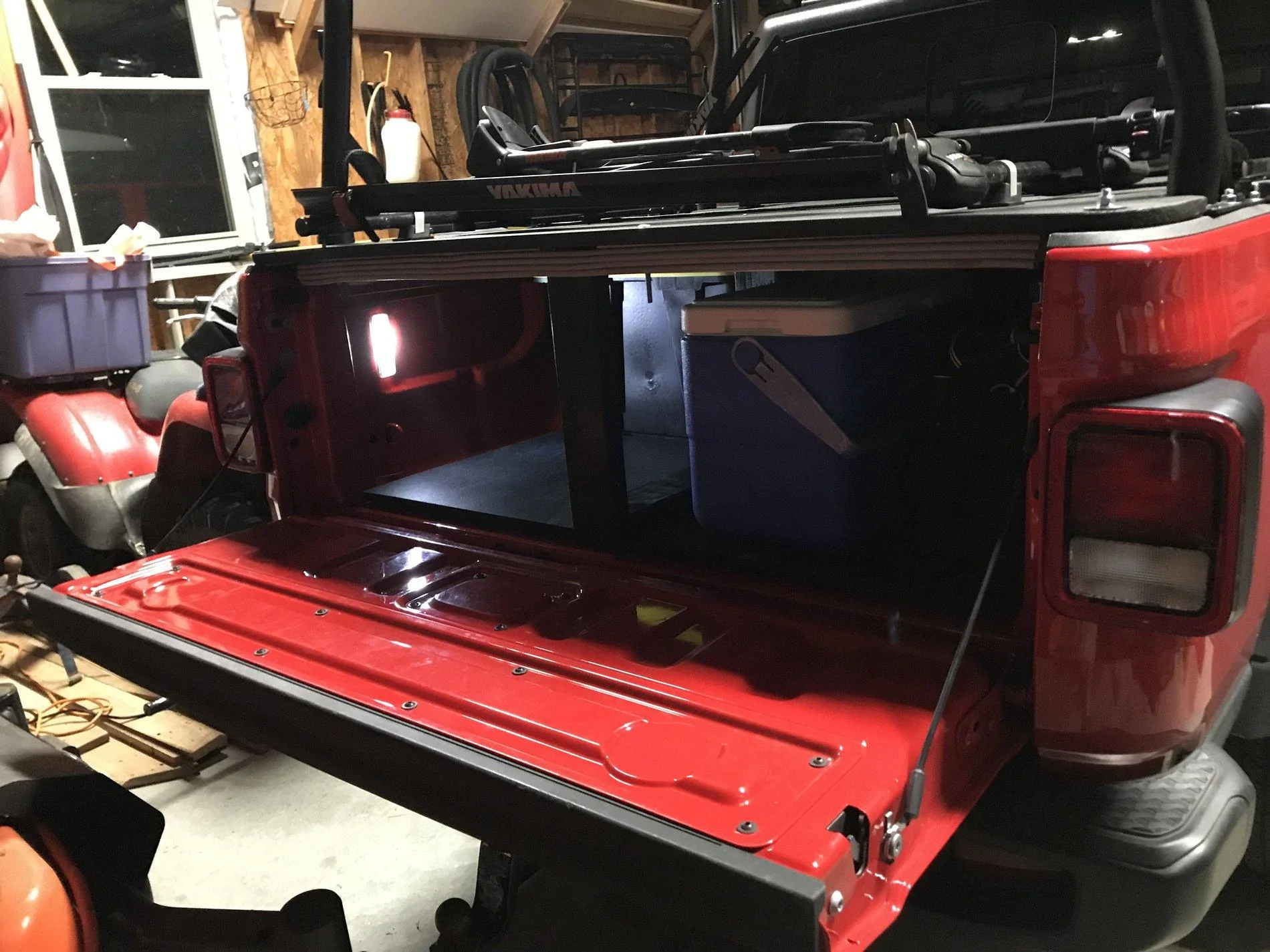

So far this works for me and was very inexpensive. I want the leitner rack but back order prevented me from getting it. So made my own. Still working out the drawers. Right drawer will have fridge in slide out with drawer behind it (right side, passenger side, has the hole and mount for plug. I am putting a large inverter in the cab behind the seats with extension to bed for fridge etc. Left side will be drawer slide. Roof top tent goes forward on cab of truck with bike rack on my hard bed cover. I will completely redesign this over the winter. I also want to be able to have a soft top in the summer that works with the rack.
The big rack (the 6th pic) will be modified(heavily) to reach a front hoop with rubber isolators that attach rack to that windshield hoop. This will allow the minimal flex of bed vs cab. I will purchase a hard trifold cover that mounts inboard of the bedsides. Right now I’m using plywood covered with textured deck paint.
What I have now is sealed and with the Yakima bar and bed mounted bed rack I can do all sorts of stuff. I have $300 in current set up ( I had all of the Yakima mounts and the bed rack someone gave to me)

Nice, great solution.
