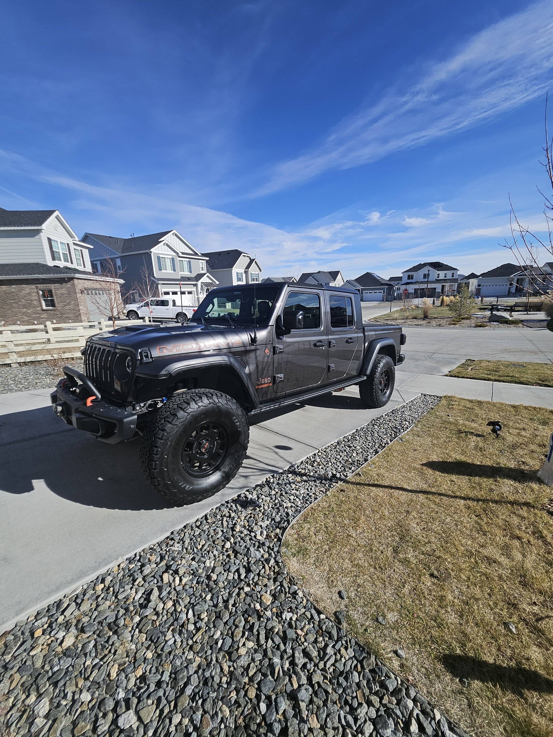

2021 Mojave, 2" AEV Spacer plus geometry correction bracket, 37" BFG KO2 (32psi for daily driving) on Method 705s with 25 offset ... I do have Mopar steel front and rear bumpers and a winch up front that lowered me less than 1/2" ... wheeled with full flex and no rub with front sway disconnected ... height just under 75" ... I also beefed up the steering (see signature) when I installed the lift ... before the winch, it rode at least as good as stock except in very high crosswind ... with the winch, I got into the front bump stops a little more often (usually when I was playing and knew that it was coming!)

Thanks this is really helpful info! Also, what front bumper is that?

Glad to help! It is the Mopar steel front bumper for the gladiator

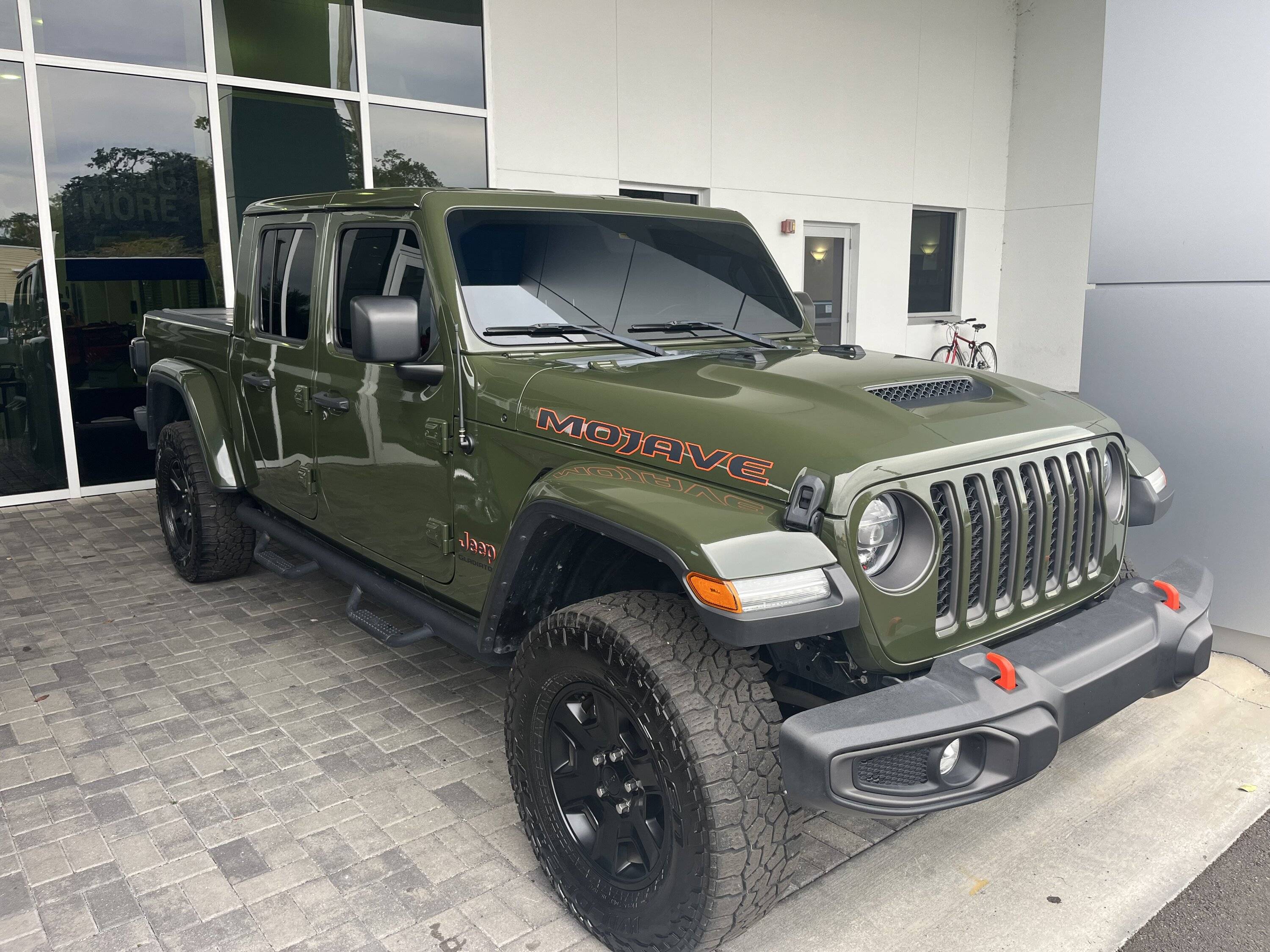

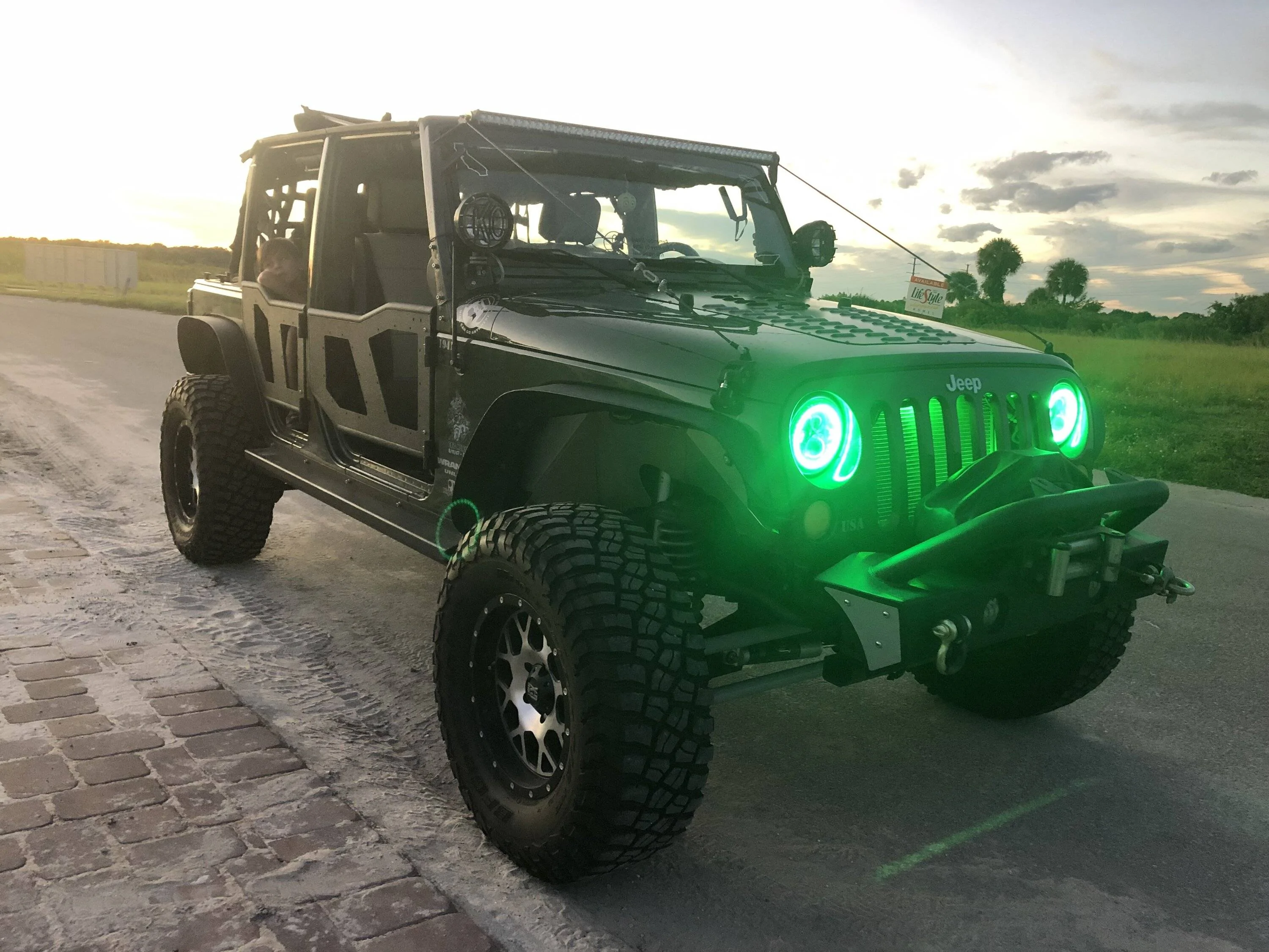

Hey y’all - new to the gladiator, although I built out a JKU for years before this.
FIRST, I’ve seen similar posts on this but didn’t find exactly the info I was hoping for: if anyone is in a Mojave on the 2” AEV puck lift on 37’s, what is the height of your rig? (Needing to see if it’ll fit in my garage if I go that direction).
SECOND, I’m already loving the way the Mojave feels and don’t want to lose too much of that. Obviously jumping to 37’s I know it’ll affect things, so I’m actually leaning towards staying stock with 35’s for now. But man tire envy is real when you see a soccer mom driving a rig bigger than yours ? wanting to hear from the 35’ers and 37’ers on your pros and cons
thanks, stoked to be on here!
*pic of my JKU and stock Mojave
AEV 2" puck lift and 35s-- AEV 2.5" (closer to 3") and 37s... look at the two AEV website builds, that's how the do it and recommended tire sizes per each lift.
