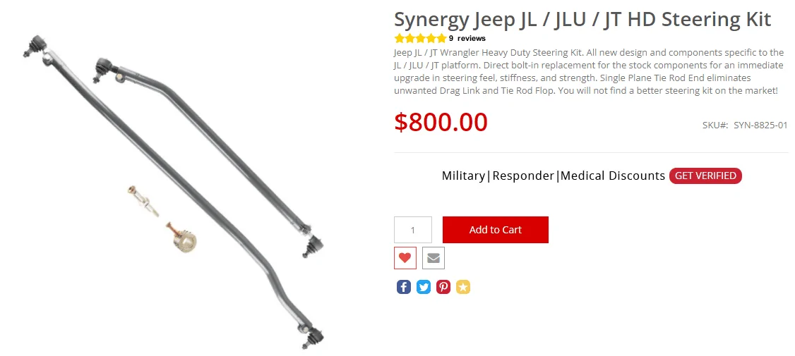

I know it sounds like bad advice spending money on parts that aren't broke, but if you want to future proof your steering and rule out any weakness due to OEM parts, I'd highly recommend upgrading your tie rod and drag link as well. (at a minimum the tie rod) You've already done the right thing with replacing the track bar :) The OEM tie rod can only be described as "flimsy" when you take it off to replace it with a Synergy or Yeti (both are great, I just started with Synergy and all my components followed suit)
