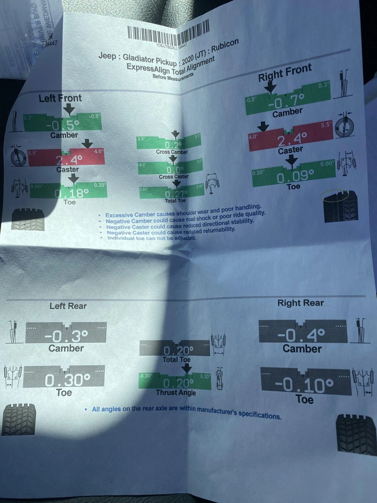

do you have an alignment sheet handy ?
There is a slight crown but it is a HARD pull. Here’s an alignment sheet pre LCA install.

Rough country claimed that the LCA geo correction brackets were enough and I said yeah right. No adjustable arms other than the front LCAs that I put on and no adjustable track bar in the rear.
2.4*?!
If you don't have an adjustable track bar on the rear after a lift, esp one that large, then your axle will be shifted. Have you noticed your tires sticking out more on the right than the left? Could be pushing your truck to the side as you drive, and more prominent at higher speeds.
It's not usually an issue on smaller lifts but 6" on 37s and it may become apparent.
