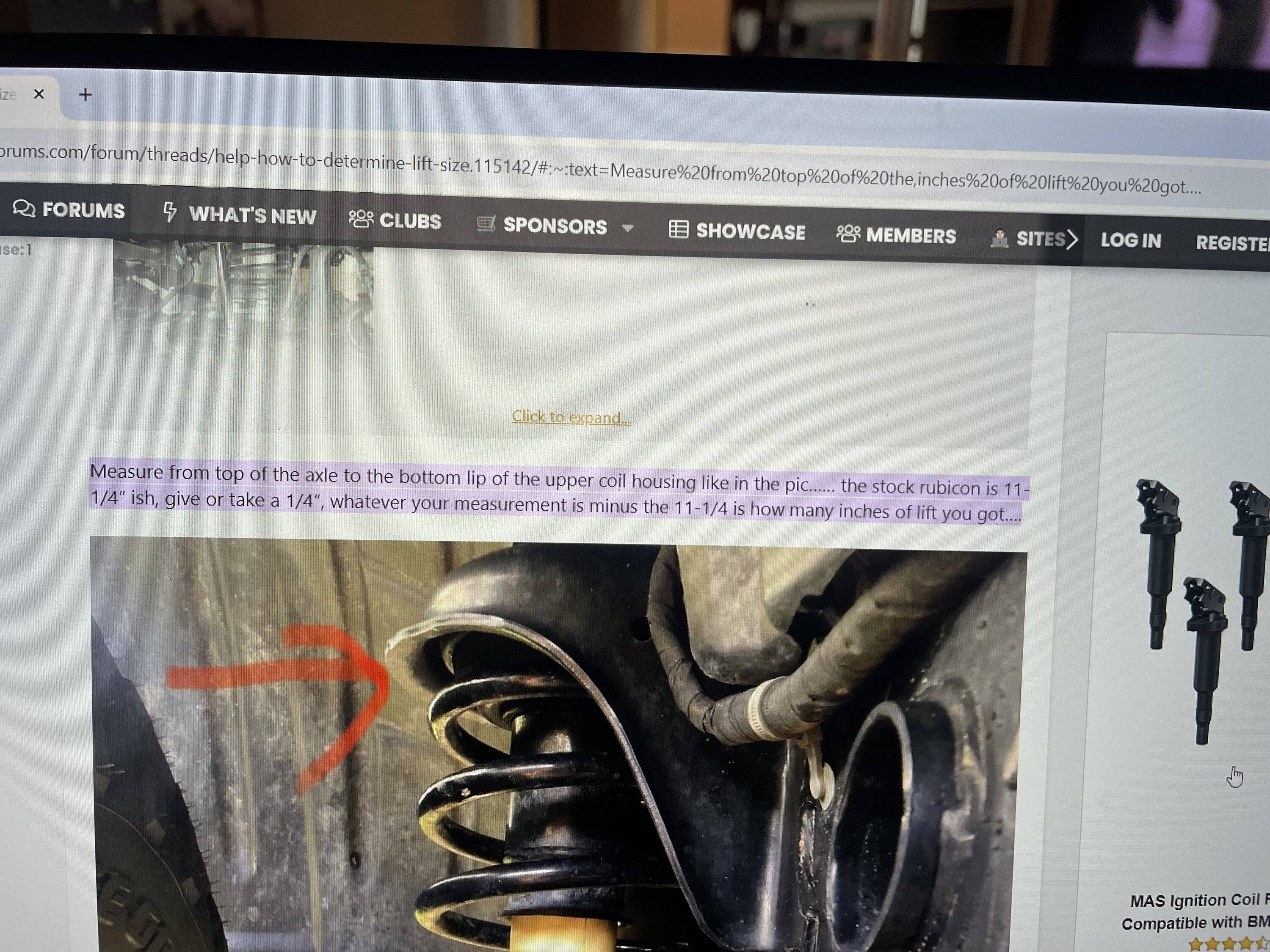

I just seen this, think it’s accurate
Yeah, that is a little tough just with that info and no eyes on it. You might have the MOPAR 2" lift but you would need to get under it and look at like the springs, shocks and the front low control arms to see if any part numbers bump against the MOPAR kit.
Thanks, this helps.
Jeep Gladiator Gladiator Rubicon suspension - which replacement Fox shocks? IMG_4422

It will give you a good starting point, I assume that you bought it used? No info from the dealership/seller?
Looking for adjustable control arms, track bars, sway bar end links, bump stop extensions, etc. will also give you some more info to start running down what type/height lift you might have. There could also be shock extensions and or pucks on the springs to lift it.
