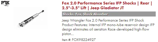

Ive been looking at buying Fox 2.0 in the 2-3" length for the Mopar springs, but the shock is listed at 29.6" extended for the rear, their is no way possible that the spring doesnt come unseated at full flex...just cant see it...
There is a secret Fox 2.0 for the rear which is 28” extended. It’s the one spec’d for the JKS 3” lift. I got mine from Northridge.

Do you have a fox P/N for this? Ive searched and keep coming up empty. Ive even contacted Fox about what JKS lists as their 2.5-3.5 fox shock P/N, and Fox says that number was for an F150 and is discontinued.

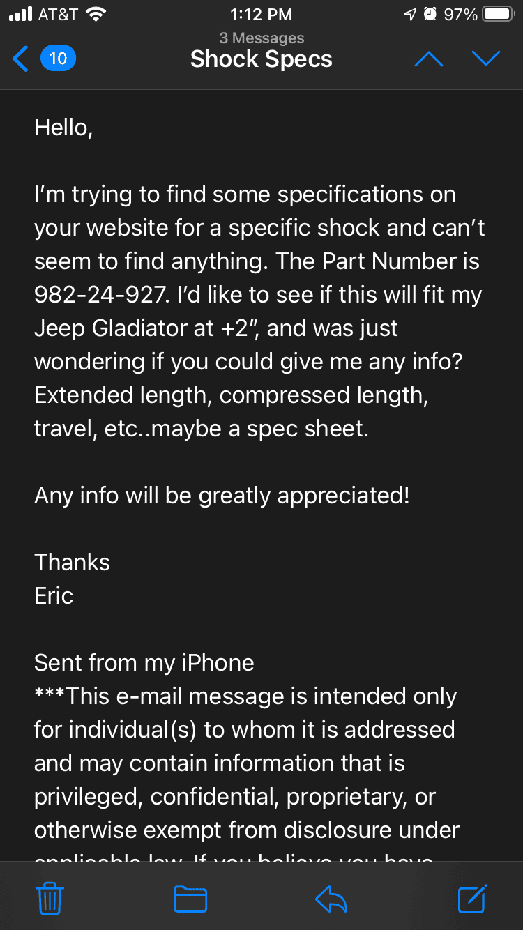

Ive also chatted with someone recently who also said they have the JKS kit with the fox rear 982-24-927 (this is the P/N JKS lists, and Fox says wont even fit a Gladiator as it has a stud on one end for the F150) (and the -177 for the front, but not important to this convo)...anyways, he sent me a bunch of pics of the shocks, and on top of the rears its engraved 985-24-220, which is what i originally wanted and Fox lists as their "2-3"" option...but 29.6"???Thats long.....
FOX 982-24-927
Northridge still shows them in stock, but they list the incorrect specs.

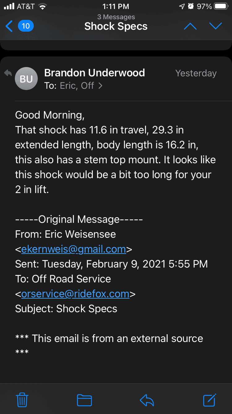

Can you double check what’s engraved on top of the shock (where the shaft exits the body)? Cuz this is from Fox..
I can check later when I get home. The image below is straight from JKS' website. It is interesting that they list the longer measurements now too when you link to that shock. It's possible that they revised this part for JKS (Fox and JKS are owned by the same parent company), but that would necessitate longer rear brake lines, which the kit still doesn't appear to have. I can confirm that they are (or at least were) 27.95" long. I used to have a photo of the box top, but I used the box to ship my old shocks when I sold them. I really think someone has entered the wrong specs somewhere, and they are being referenced by multiple websites. The lengths listed (29.69" extended) are the same as those for the generic 2"-3" lift Fox 2.0 rear shocks. When you do a Google search, you will find them listed elsewhere with the 27.95" length.
Yeah definitely let me know what they stamped the shocks with (prt number) I believe you they’re 28”, im just curious if they’re uniquely identified.....
The plot thickens even more....asked JKS about It alittle while ago, they got right back to me essentially saying whoever I talked to at Fox was wrong, maybe at one point that number was for F150s but it’s proprietary to them, and they’re sister company’s, blah blah blah...so he did confirm that’s a legit JKS P/N specifically valves for that lift...waiting to see if he comes back with more specs for me...
