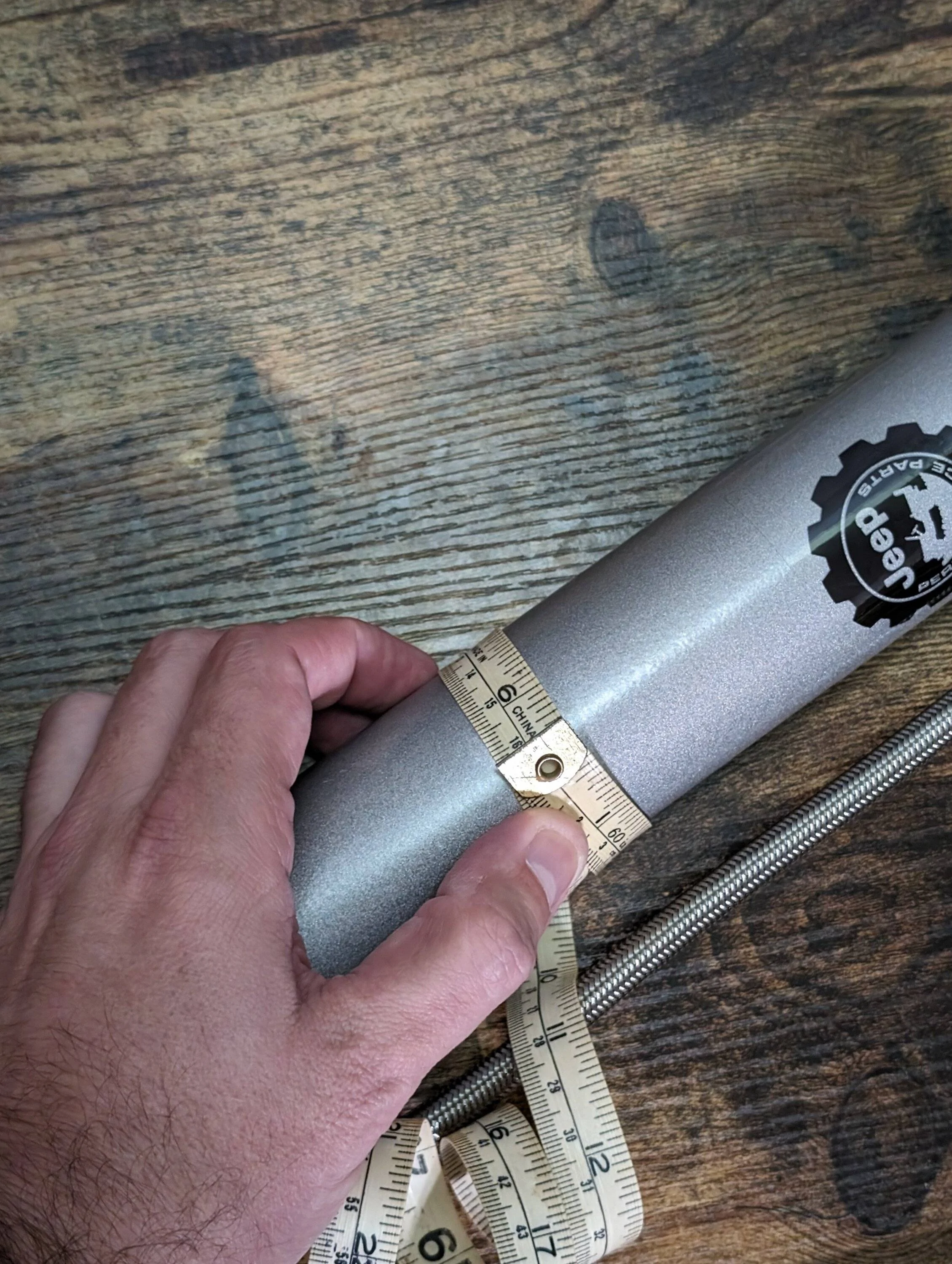

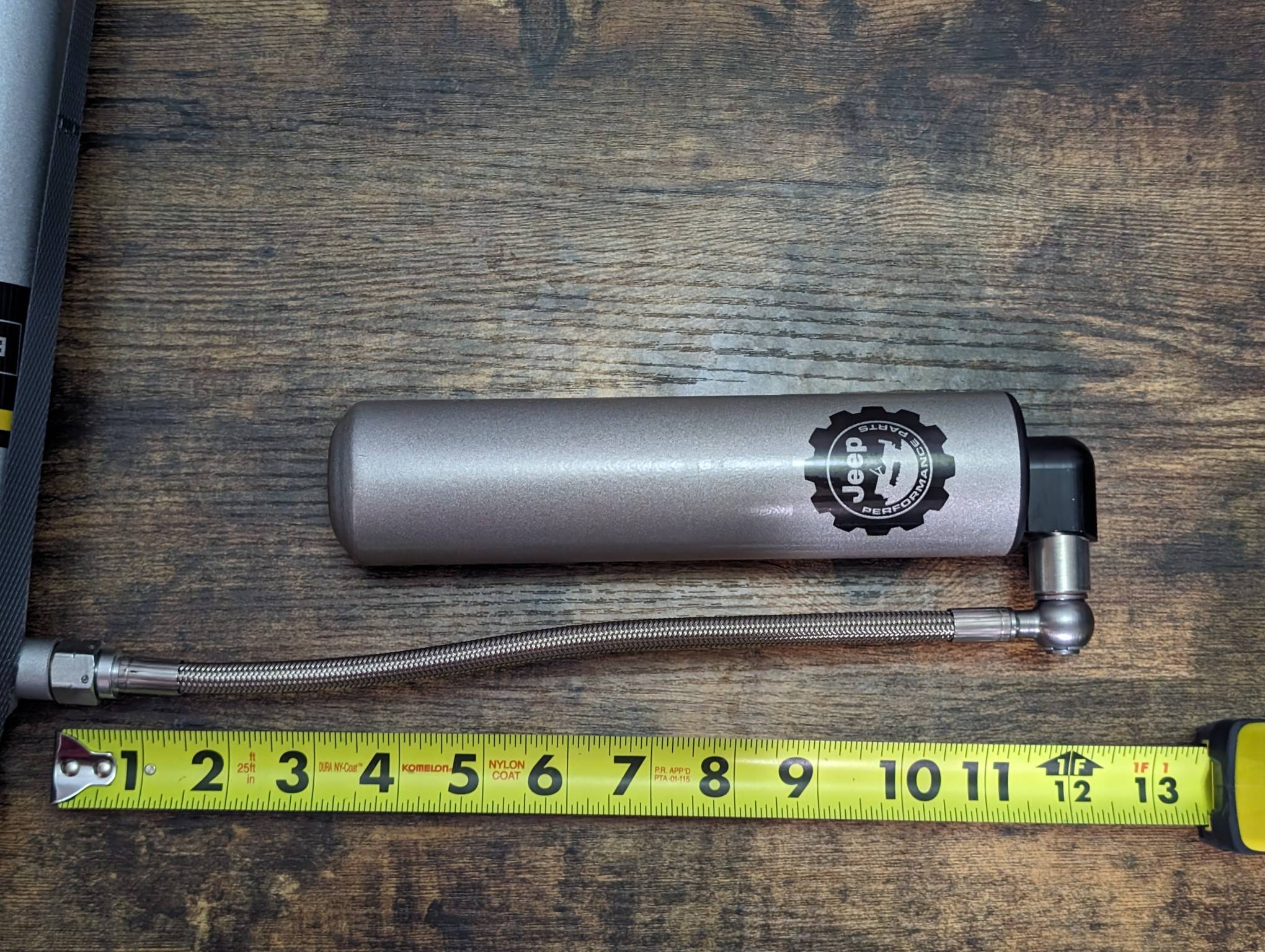

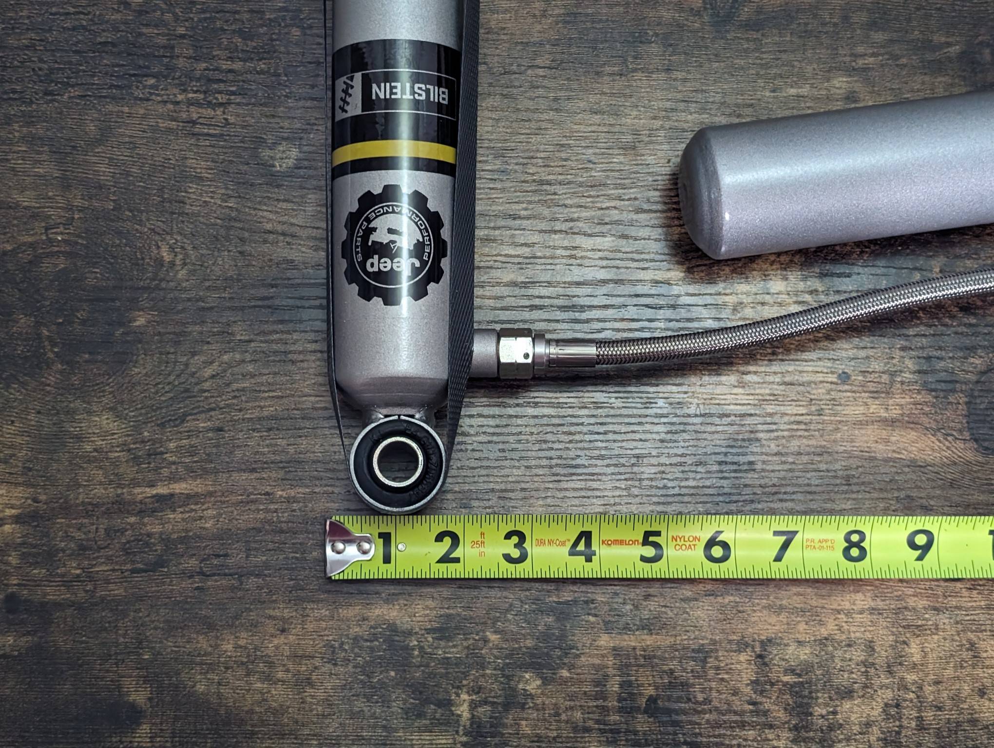

The main shock appears to be just a hair over 21 inches long while compressed, total. Actual shock tube is roughly 16.5" long:
Jeep Gladiator Mopar 2" Lift - Fox vs. Bilstein Shocks pxl_20231018_003516070-
The length of the primary shock is approximately also 21" long, and the tube itself is a little less than 16.5" collapsed:
Jeep Gladiator Mopar 2" Lift - Fox vs. Bilstein Shocks pxl_20231018_004512812-
