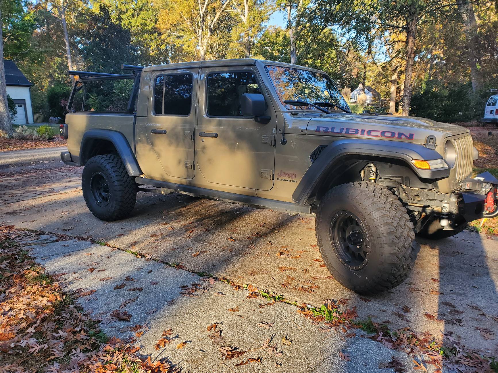

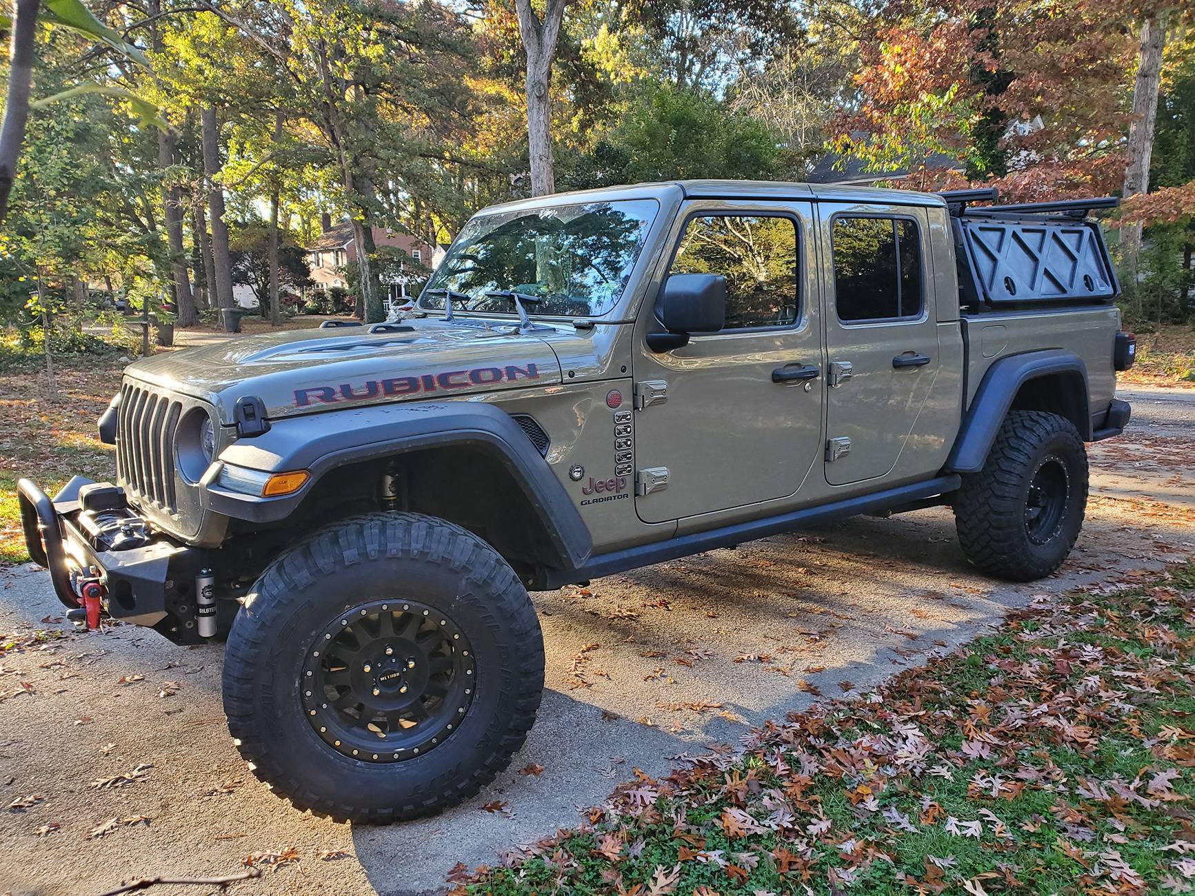

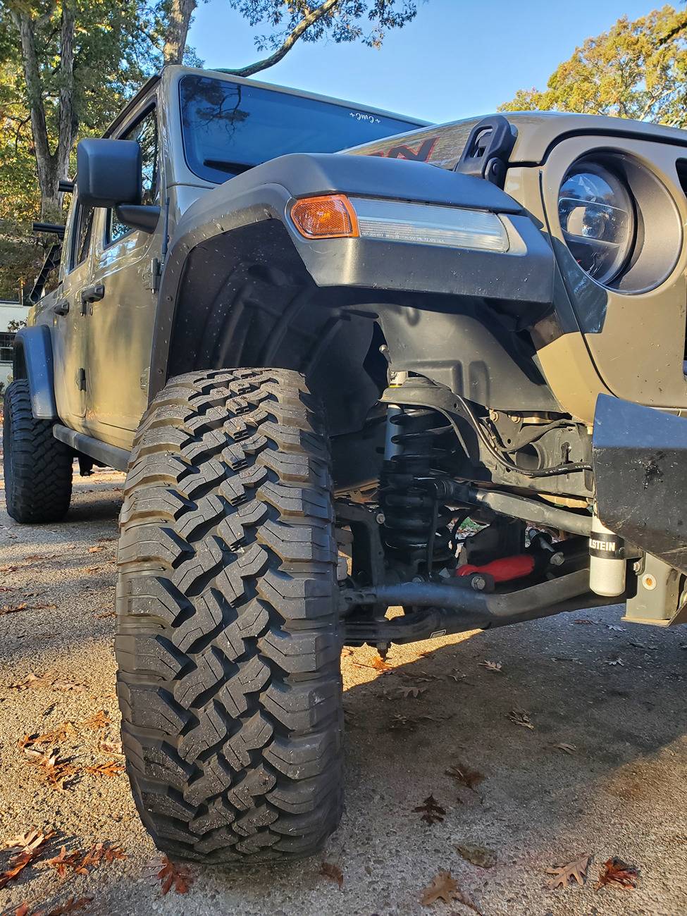

Thanks for the input! I guess I'll have to be patient and wait. Do you have any side pictures of your current set up?
