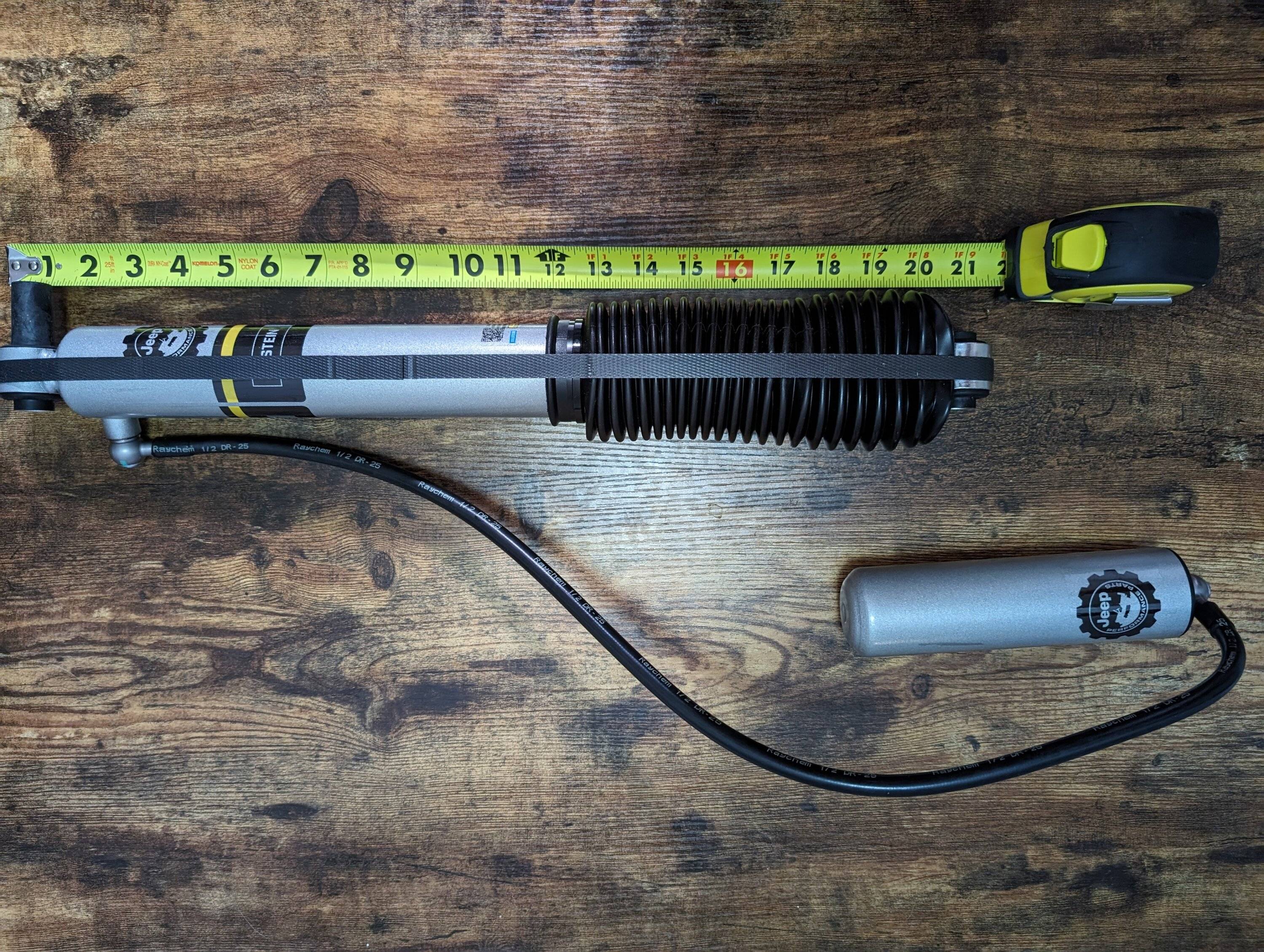

The main shock appears to be just a hair over 21 inches long while compressed, total. Actual shock tube is roughly 16.5" long:
Jeep Gladiator Mopar 2" Lift - Fox vs. Bilstein Shocks pxl_20231018_003516070-
The length of the primary shock is approximately also 21" long, and the tube itself is a little less than 16.5" collapsed:
Jeep Gladiator Mopar 2" Lift - Fox vs. Bilstein Shocks pxl_20231018_004512812-

So either those springs are not fully compressed (hard to confirm with the boot on the shocks) or those shocks are not the same as the ones Billstein advertise on their web site for the Gladiator
The DB

The shocks in the kit are not Bilstein 5160, they’re made to Mopar specifications based off of a 5160… since Mopar doesn’t publish their “specifications”, we don’t know without measuring … there is no guarantee that the Mopar Bilsteins and the Bilstein 5160 match in anyway-shape-or-form …
the measurements you quoted are shocks that are mid stroke, there’s a strap holding them in a “shipping position”. They’re not fully compressed nor fully extended. So the image doesn’t really tell us anything of value.
