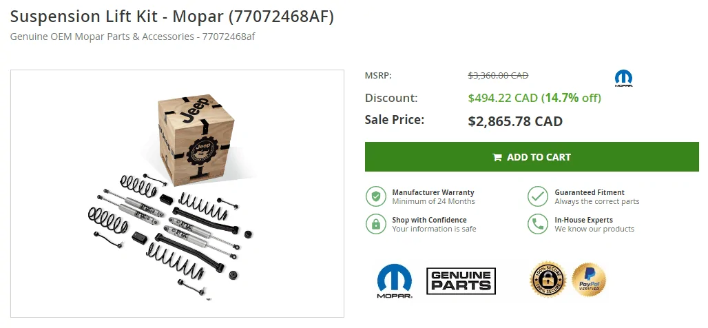

Jeep Wrangler 4-door (JL74)3.6-liter V-677072395AH
2.0-liter turbo77072430AH
3.0-liter EcoDiesel or 6.4-liter V-877072399AH
2.0-liter turbo PHEV77072522AE
Jeep Wrangler 2-door (JL72)3.6-liter V-677072396AH
2.0-liter turbo77072397AH
Jeep Gladiator (JT)3.6-liter V-677072468AF
3.0-liter EcoDiesel77072469AF

Msrp is now $2100 for the kit, it's 40% higher than 2 years ago.
Yeah guess they had to make it look a little more worth it. Crazy, that much money for a not complete kit. Yeah it was 1300$ 2 years ago.
MattHamilton
Apr 9, 2021
191
227
Hamilton, ON
2021 Jeep Gladiator Overland
Support Analyst
Jeep Gladiator Jeep Announces New Mopar 2" Inch Lift Kit Featuring Bilstein Shocks 1690383341696
The Canadian Mopar website still shows Fox shocks. And honestly, at that price, I'll pass for now.

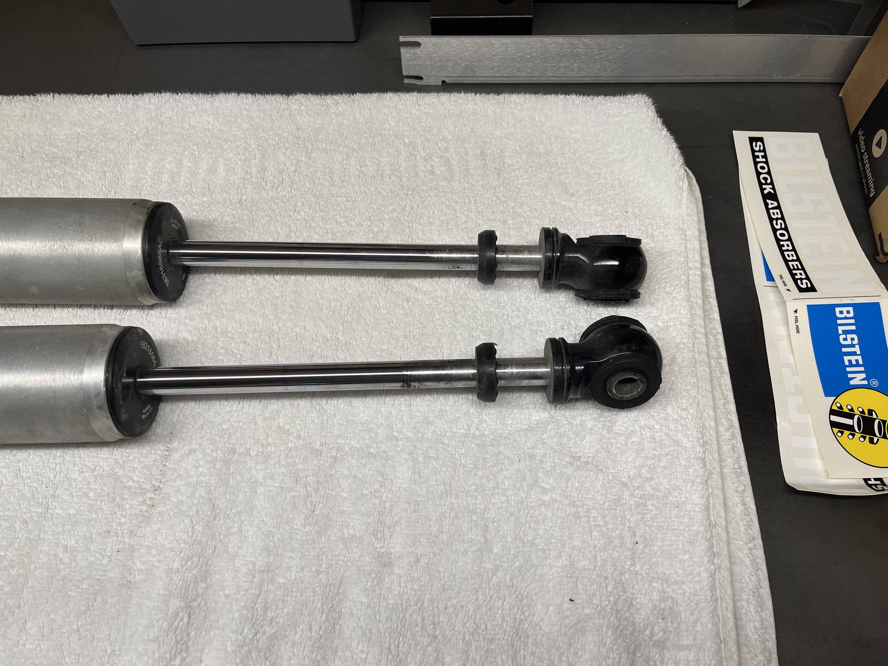

I just bought a front set of 5160 for $320 from Northridge. It showed 2 left instock when I was checking out.
Hopefully they will helps with tons of washboard trails out west. Replacing my Mopar 2" lift Fox shocks.
Received the Bilstein 5160s and replaced my diesel Mopar 2" lift Fox shocks. Here are some data in case someone are curious.
Fox front shocks are 18" collapsed and 26.5" extended. 5160s for 2-3" lift, front are 16.38" collapsed and 26.87" extended.
I installed just the front for now, and man it has way more dampening for the heavier diesel front end. No more bang bang when going over sharp bumps or potholes. It's definitely firmer, but in a good dampened behavior.
With 1" front spacers on top of the mopar 2" lift springs, steel bumper and a winch, it has just an inch left of up travel on the fox shocks. It would probably bottoms out without the spacers.
