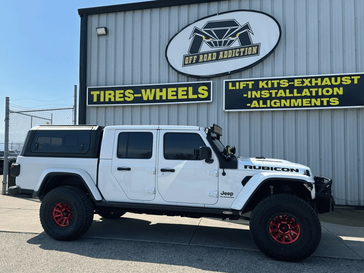

Ive got Mopar lift and 3/4 daystar spacer up front there is still a slight rake and by slight i mean slight. Once i put the Smartcap on it didn't look to bad and i ended up not going the Dobinsons route. Ive got a heavy bumper, winch etc
