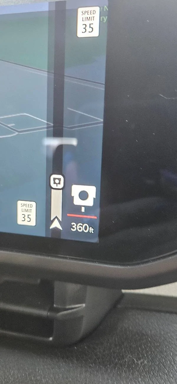

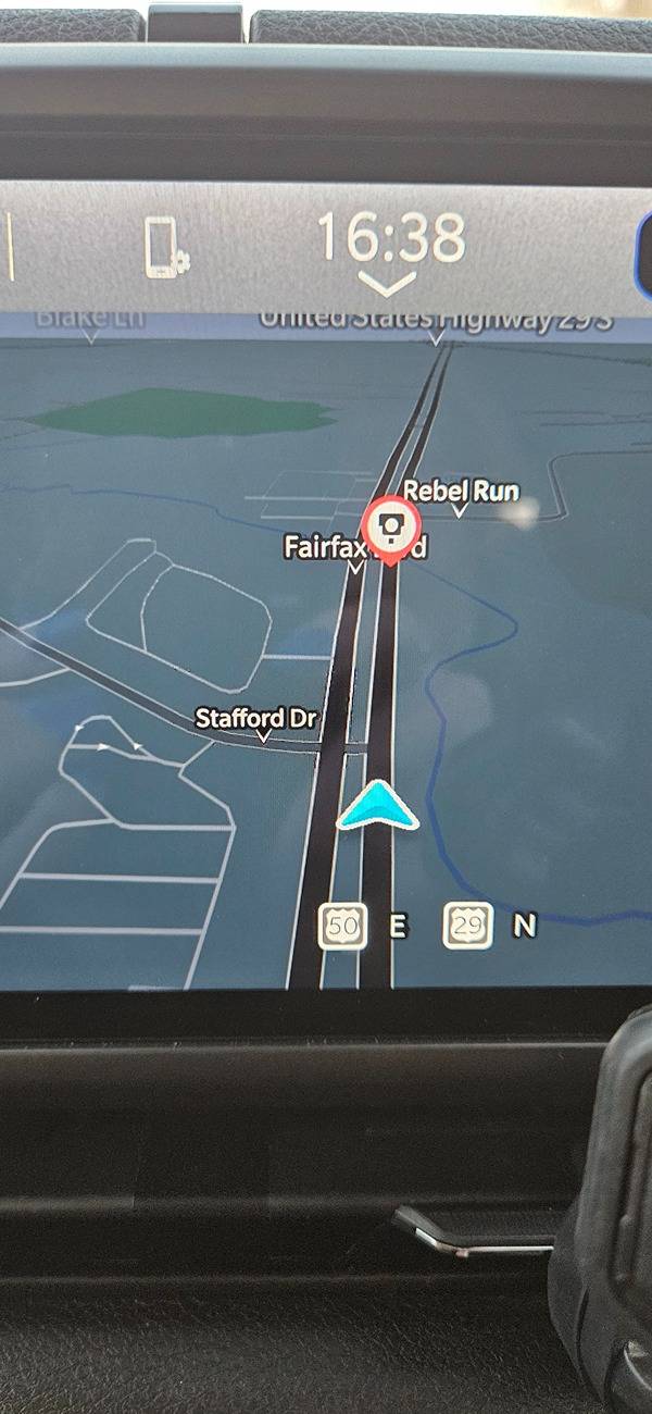

Hi y'all!
I finally got my dream to come true. A 2025 Gladiator. Didn't take long and I had random chimes (3 at a time) sounding off seemingly random and for no reason. I started googling. Came across blogs like this one, suggesting all sorts of things that just seemed not the right answers for me. Watched the situation a little closer and figured it out!
The GPS system warns of an upcoming traffic light camera!
If you turn on the Jeep GPS, you'll see it! On the map as a camera icon, as well as in the bottom right corner it does a meter reducing the down distance as you get closer.
You are welcome 😊
