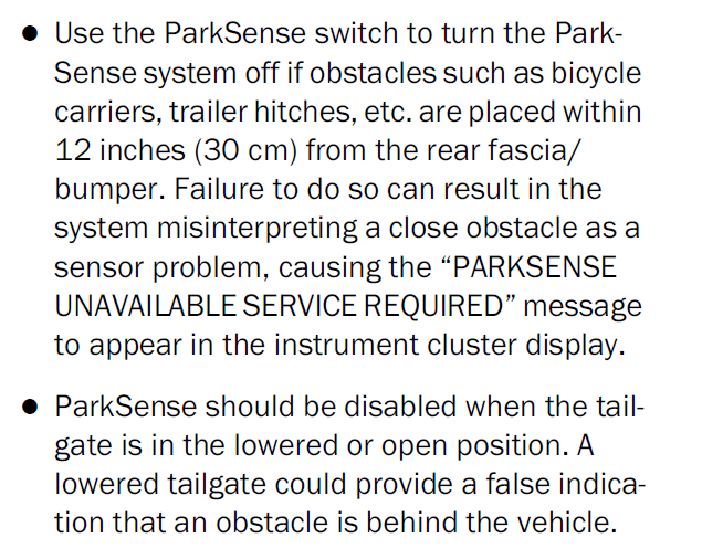

That's normal. Press the "P" button on the dash to override.
I found a you tube video describing that ParkSense switch, it does not exist on my dash. In that spot is a double wide Duck button instead. Also my dash does hot have a "P" button. I ran an experiment today. I started the Jeep, put it in reverse with my foot on the break and had my wife walk behind the bumper, no errors, no messages, so maybe my Willys does not have that feature.

ParkSense and AutoPark are two entirely different things. ParkSense is an option that is basically a collision warning system whereas AutoPark is a standard feature that automatically shifts the transmission into park under certain circumstances, mainly to prevent the vehicle from being left in gear when the driver opens the door to get out. While ParkSense can be disabled via a button, AutoPark cannot be disabled.
