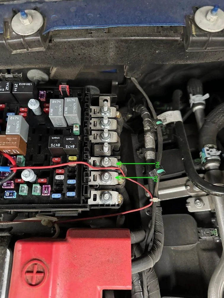

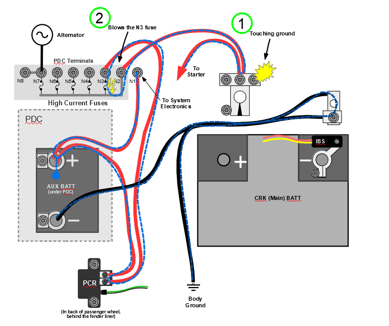

Interesting thread since I could not take my Jeep anywhere this morning because the battery was dead. I should say everything was dead, no dash, no center console light, nothing. I later had time to jump it with a NOCO jump pack. Started right up, but now has an error icon: Auto Start stop system needs attention. So off to the dealer it will go. No problems at all leading up to this event it was all fine when I parked it about 20 hours earlier the day before.
Based on some reading suspect the Aux battery is dead and took down the Main to 4.5 volts. I'll go check the N3 fuse to see if it is blown. If it is it would have to be from a poorly routed Aux battery cable rubbing through or the Aux battery shorting out. I disable the auto start stop, so would be no indication that battery might be starting to fail. I have not been under the hood or modified anything since the dealer checked out a misfire a couple months ago, and nothing before that either. Big inconvenience though since the doors and top are off for the winter and I'll likely need to put them on now for weather protection outside of my sight.:(
Doubtful it's a cable rubbing - these aren't that susceptible to that.
It's also rare for that fuse to be blown. It almost takes an accidental touch of the positive battery cable to a ground to cause it. It's a big amp fuse.
To check that fuse you'll need to take the nut off the top and remove the cable going to the aux battery. It's not a fuse you can pull and look at through a translucent case.

My N3 fuse was not blown. Checked the operation of my Jeep throughout yesterday, multiple start and stops of the engine and went for a short drive. Everything seems fine and even the Auto Start/Stop error message is gone. I checked it again this morning and it started right up.
Hmmm... now what? Do I keep the scheduled appointment for the dealer to look at it on Thursday or cancel since there is no active error message. There might be logged codes they could see but I doubt they will do anything like replace a battery without an active problem. I guess if it is a real problem it will show up again. I say real instead of something I did like leave the radio on or in drive or ???? Doors are off so nothing to trigger that I left the Jeep except the fob.
