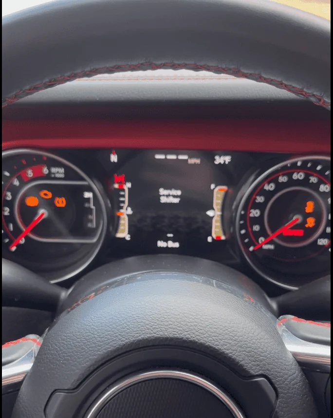

This (snippet below) looks like half the truck lost power, or it was shutting down into some self-preservation mode.
That's why I wonder about voltage. Hmm, just thought of something else - it just hit me, @tysongladiator has a video out there and I think he mentions loose crank battery terminal. It's actually the IBS loose on the negative battery terminal. You tighten the nut, it seems ok, nice and snug, but it's not actually clamped tightly on the battery and periodically loses contact just enough to cause the electronics to freak out.
Jeep Gladiator 22 jeep gladiator electrical problems 1714749855340-08
Cluster shut down as far as tach, speedometer, but fuel gauge and warning lights are all working.
Definitely a connectivity or voltage issue.
i'd check all ground points in the engine bay, check those battery connections to make sure they are really tight - even grip and try to turn or pull on the IBS see if it wiggles or moves on the battery post, check all of the connections you can think of.
I can see why they looked into the CANbus star connector as a possible culprit.
