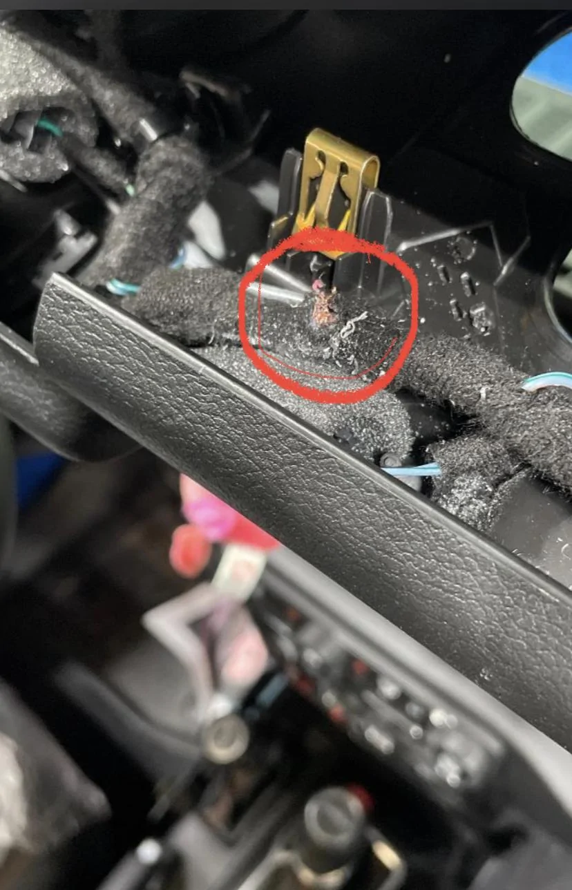

i took down the front sun visor plastic piece to drill the holes. When i replaced it it pinched the wires. 850 dollar mistake. ?

Here’s the pinched wires.
