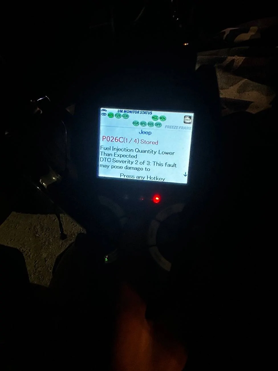

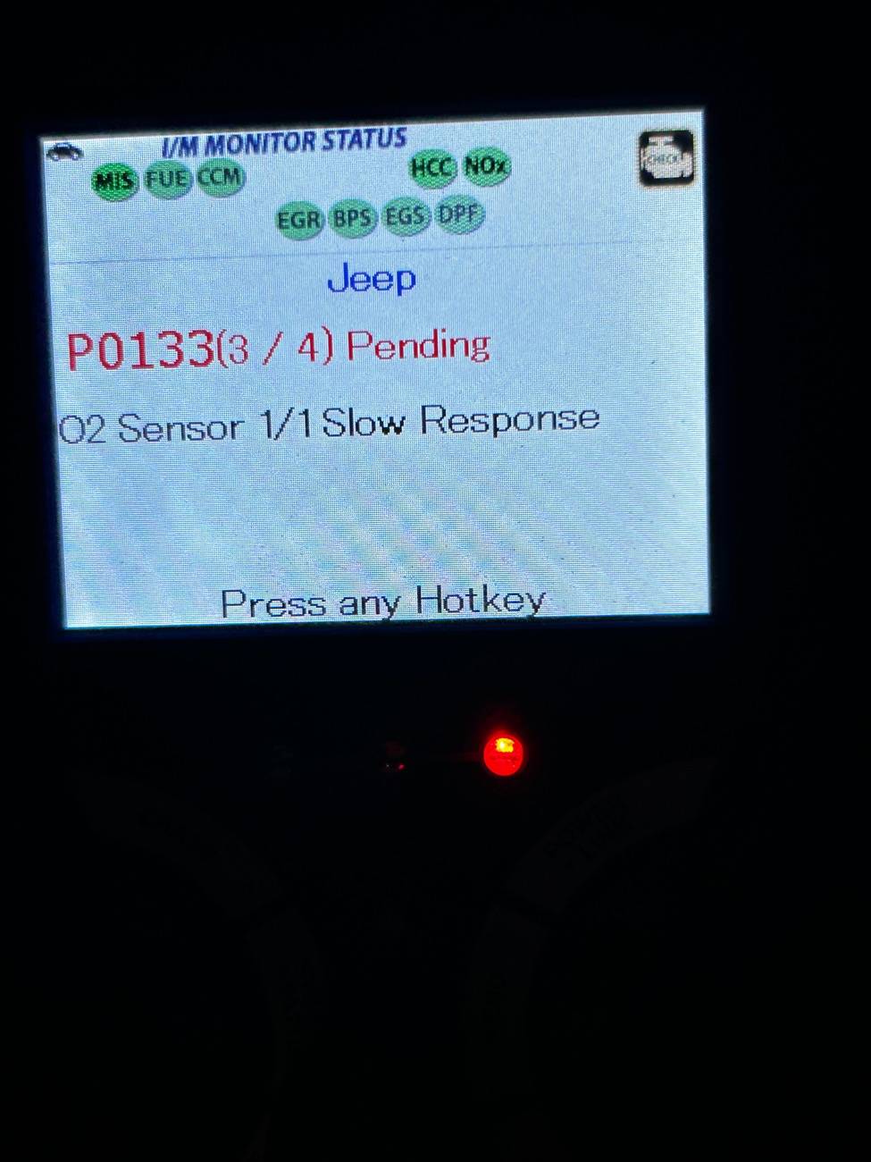

Hi just wanna post a review of my experience with my jtd overland. Only had it for couple of months I just my first engine light

I feel discouraged on keeping and doing mods on it wanted a good daily that looks rugged.

That is likely a turbo tube that has a crack in it. Do you still have warranty?

Still within the 5 year 100k. Sounds like a service center problem.

Have you replaced the fuel filter? Reck is every 8k with biodiesel >b5

37000 on my 2022 diesel Rubicon. No issues, great vehicle. Didn't have a problem with the high pressure fuel pump but had it changed out by the recall anyway
