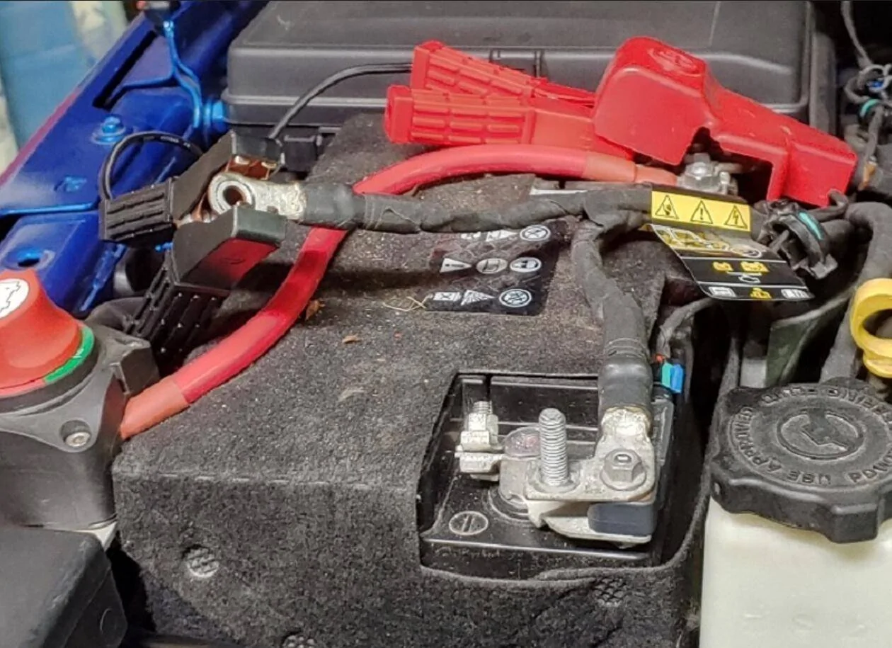

Quick question, which of the positive leads go to the aux battery?

You clamp the battery charger on to the main battery positive and it hits the aux battery positive. No need to pull any positive cables off.
Here is how I charged my aux battery on my 2020 back then -
Jeep Gladiator Two weeks and 470 miles of Jeep ownership and already a Check Engine Light 1745364716631-ok

PS, you da man. I just pulled everything apart. Put the charger on the aux and it showed 100%. Then I put it on the battery and it was 50%. I also have the ISB of the terminal and unplugged.
Wish I saw that before I pulled my aux battery to charge it. Lol
