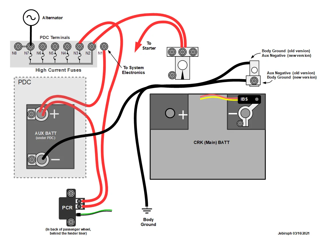

I think there is a good chance you blew your N3 fuse when you changed the battery. This happens when you let the positive cable touch ground when you change the main battery and your aux battery is still connected. This cuts off power to the aux battery and system electronics.

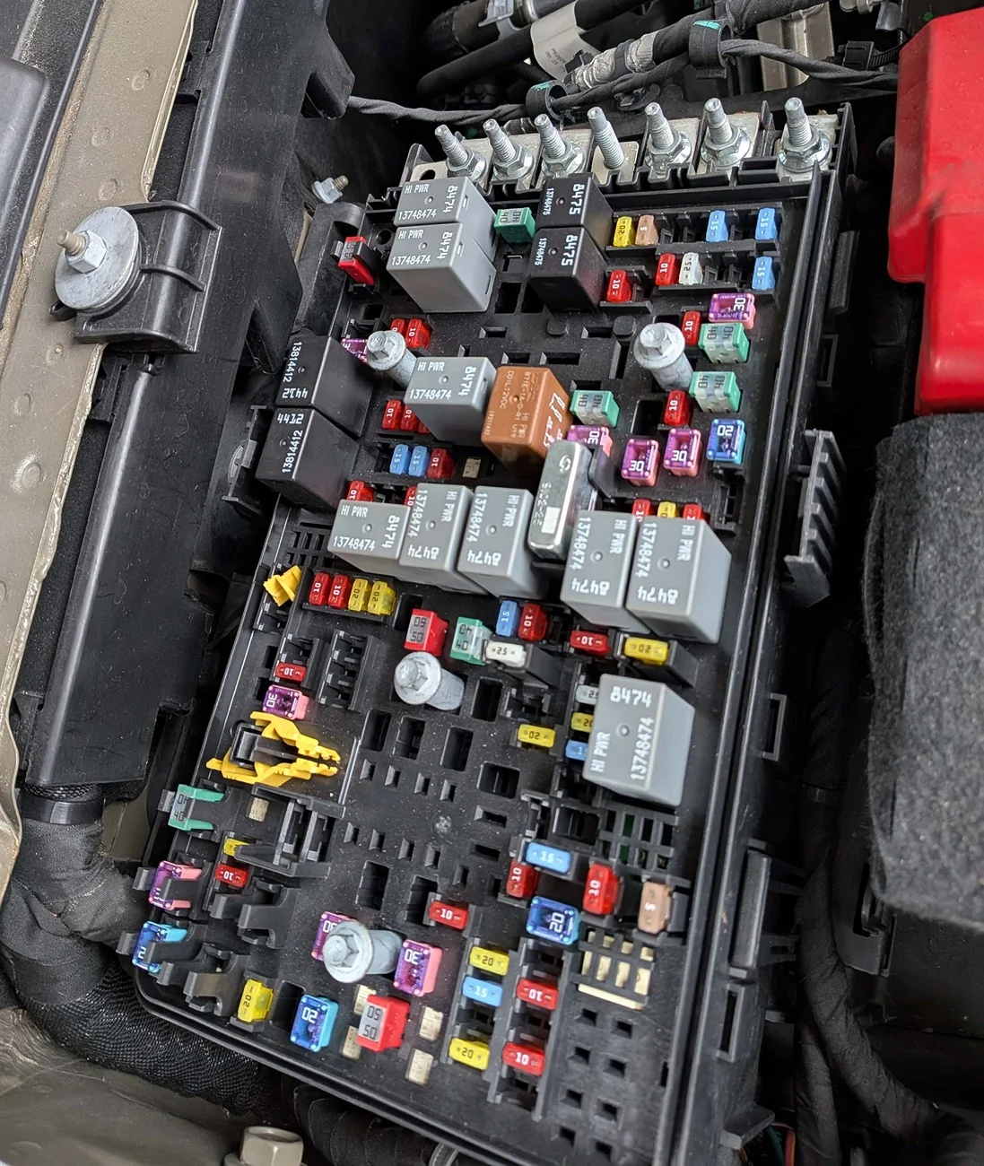

Here's a diagram and a picture to help troubleshoot. If you have a voltmeter you can measure the voltage at the N1 terminal and compare it to your main battery voltage. If the voltage at N1 is significantly lower than the main battery voltage, the N3 fuse is probably blown.
There is a work around for the blown N3 fuse. You can see in the picture that there isn't a wire connected to the N4 terminal. You can move the wire from the N3 terminal to the N4 terminal which should get power back to the aux battery and system electronics.
Jeep Gladiator 2023 Jeep Gladiator Problems .looking for any pointers battery wiring 03162021
Jeep Gladiator 2023 Jeep Gladiator Problems .looking for any pointers fuse box terminals

What Jerry said - but also, don't just toss in a battery without considering that one or the other could be bad, or simply DOWN from sitting.
You should charge BOTH batteries, independently, and go from there.
If one was discharged and the other fully or nearly fully charged when you installed it, it could introduce issues.
You have two batteries - keep that in mind because disconnecting one of them still leaves the whole system powered up - hot.
