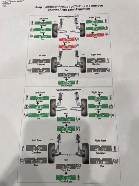

My update after picking up my 2022 Gladiator from the dealer yesterday with the same issue. They did the alignment but said it was in spec except for the Steer Ahead angle was off just a touch but that wouldn't have caused pulling to the left. They did find that the ball joints were loose (only 2000 miles on the truck). They said they were not tightened at the factory. (that's scary). It is riding much better! I didn't notice it pulling to the left on a 7 mile trip on the highway home. I also noticed that the truck isn't "drifting" right and left as much as it was. I know that is a common "Jeep" thing but it was really bad and the number one thing I didn't like about my Jeep. It's my first Jeep and I just thought that was the way they drove. I was pleasantly surprised to have that issue much less prevalent.
MattAB- Have they checked your ball joints? I also noticed your alignment sheet in the OP it says 2021 Gladiator JT Rubicon. Mine says 2022-2023. I wonder if Jeep has changed their alignment specs?? I have very different numbers on my sheet then yours.
