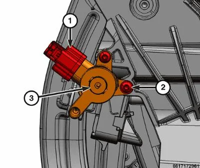

Gladiator uses an electric vacuum pump to build vacuum. Even off, the brake booster still should retain vacuum for a couple pumps unless as @ShadowsPapa mentioned, the check valve or booster is leaking.
As to the brake switch, it is actually a three wire brake pedal travel sensor rheostat that sends the brake signal through the ABS module and out onto CAN bus for the BCM, PCM and RFH use for the start circuit.
The stop lamps use the same brake pedal travel sensor circuit. If your brake lamps are coming on, then that brake pedal travel circuit is fine and would look elsewhere in the start circuit. IMHO, the brake booster pressure is a secondary concern.
Jeep Gladiator Gladiator won’t start after sitting for two days. Brake PedaL sENSOR
