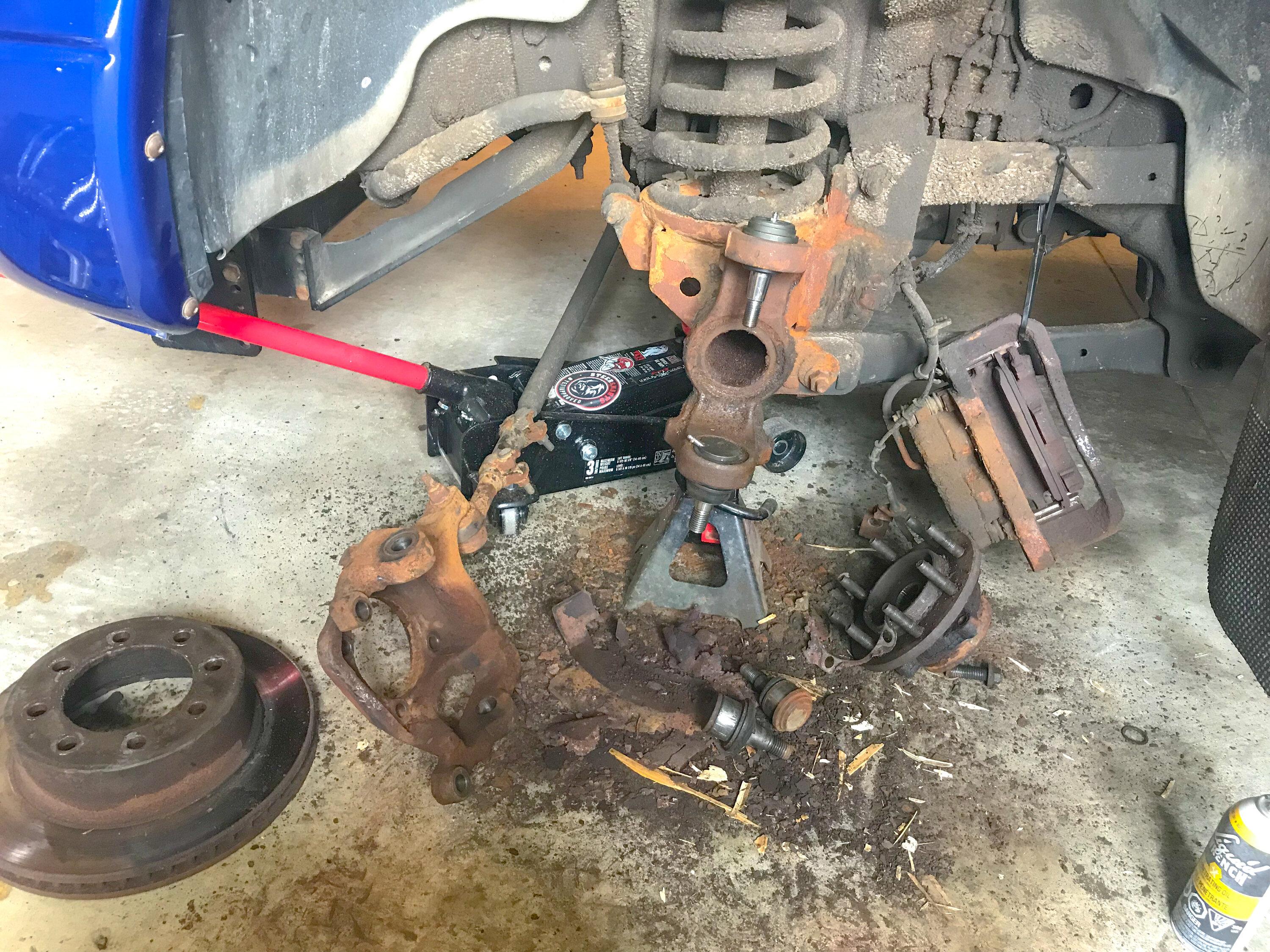

Never been one to undercoat any of my vehicles I’ve had. I’m up in northern Ontario Canada
My dad gets his truck undercoated every year, looks ok till you start getting down to the metal and realize it mostly trapping in all the moisture
I swear the truck was 20 lbs lighter from changing ball joints once I scraped off all the undercoat to change them lol
