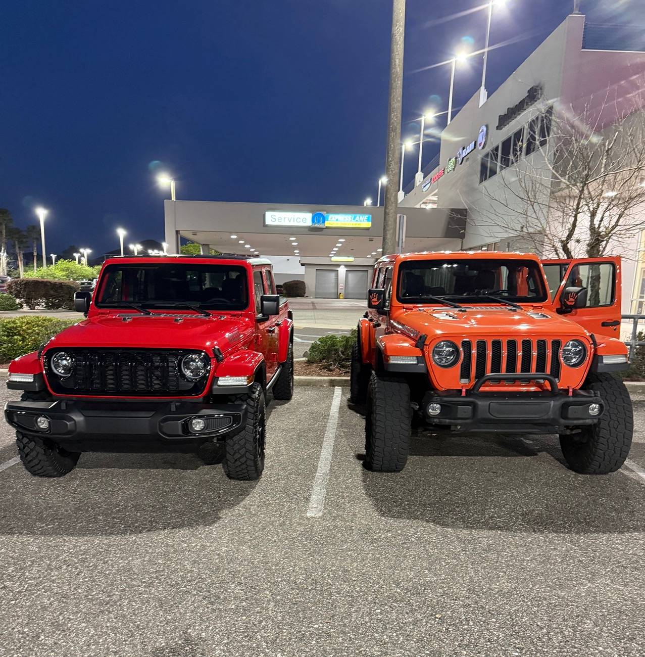

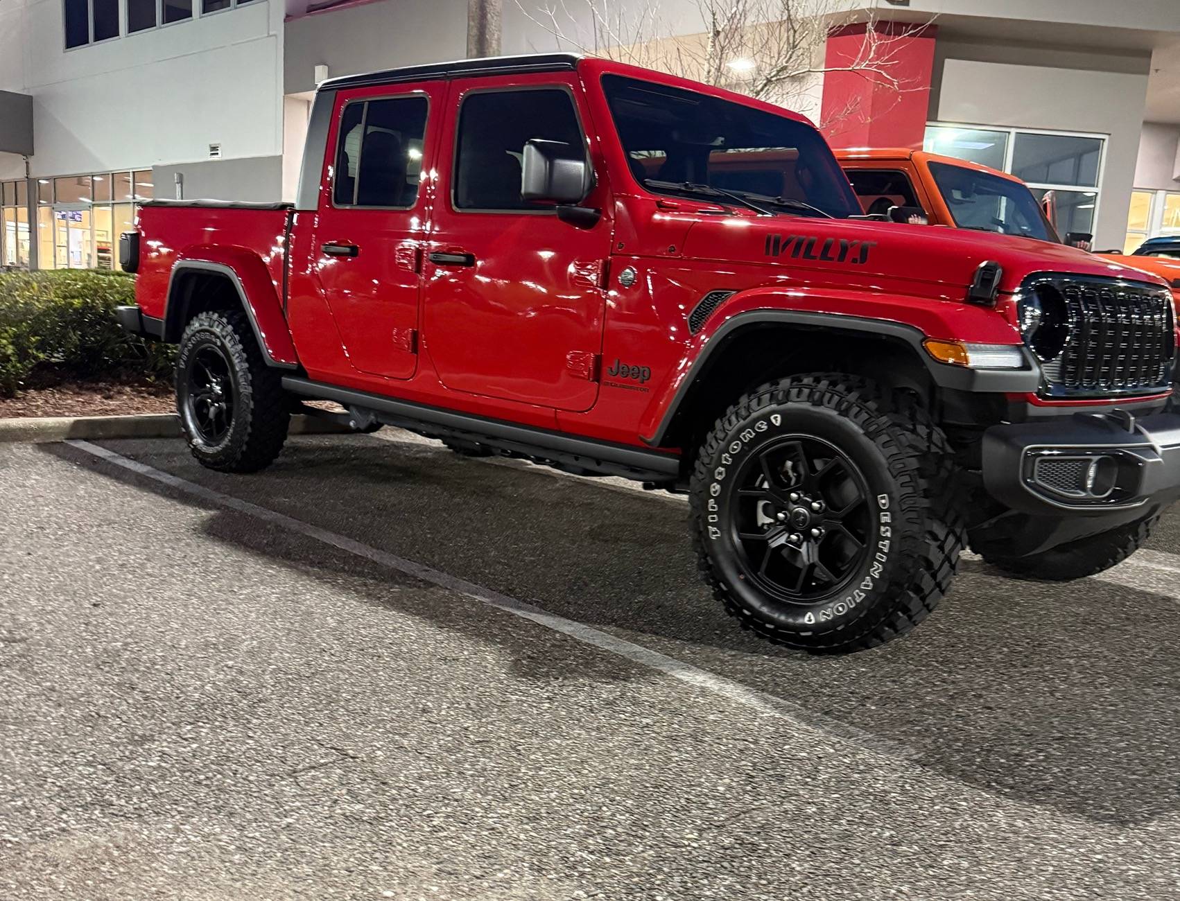

Hey Everyone - it’s been two months since I brought home my Gladiator. I traded in my 2020 Punk’n JLUR with about 85,000 miles on it. I had added 2.5 inch lift and 35’s with Fuel wheels. I got a really nice deal on a leftover 2024 Willy’s in Firecracker Red. Below are some thoughts and questions if anyone cares to read on…
- I love the Firecracker Red, but man…still missing that Punk’n.
