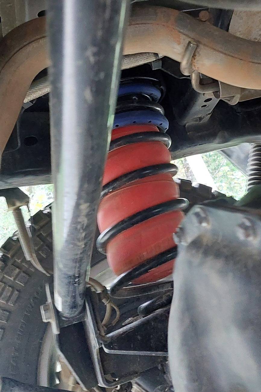

Jeep Gladiator Going to see if airbags will help with rooftop tent seaying suspension. IMG_2873

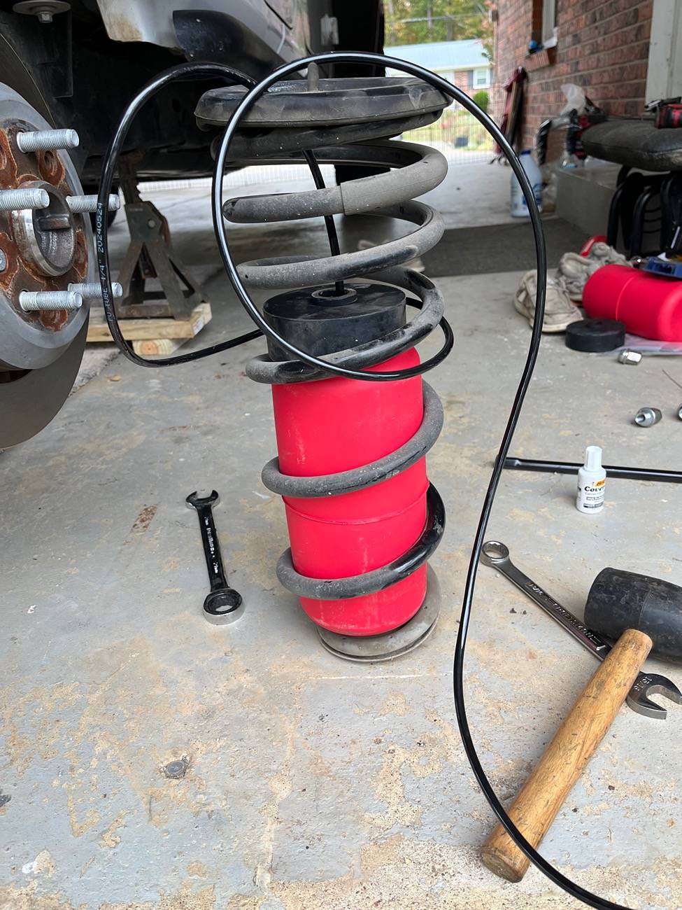

Jeep Gladiator Going to see if airbags will help with rooftop tent seaying suspension. IMG_2875
Air bags for the rear. We will see if this helps on the interstate driving hauling the extra weight of the tent and supplys. Maybe a pull behind is the future.

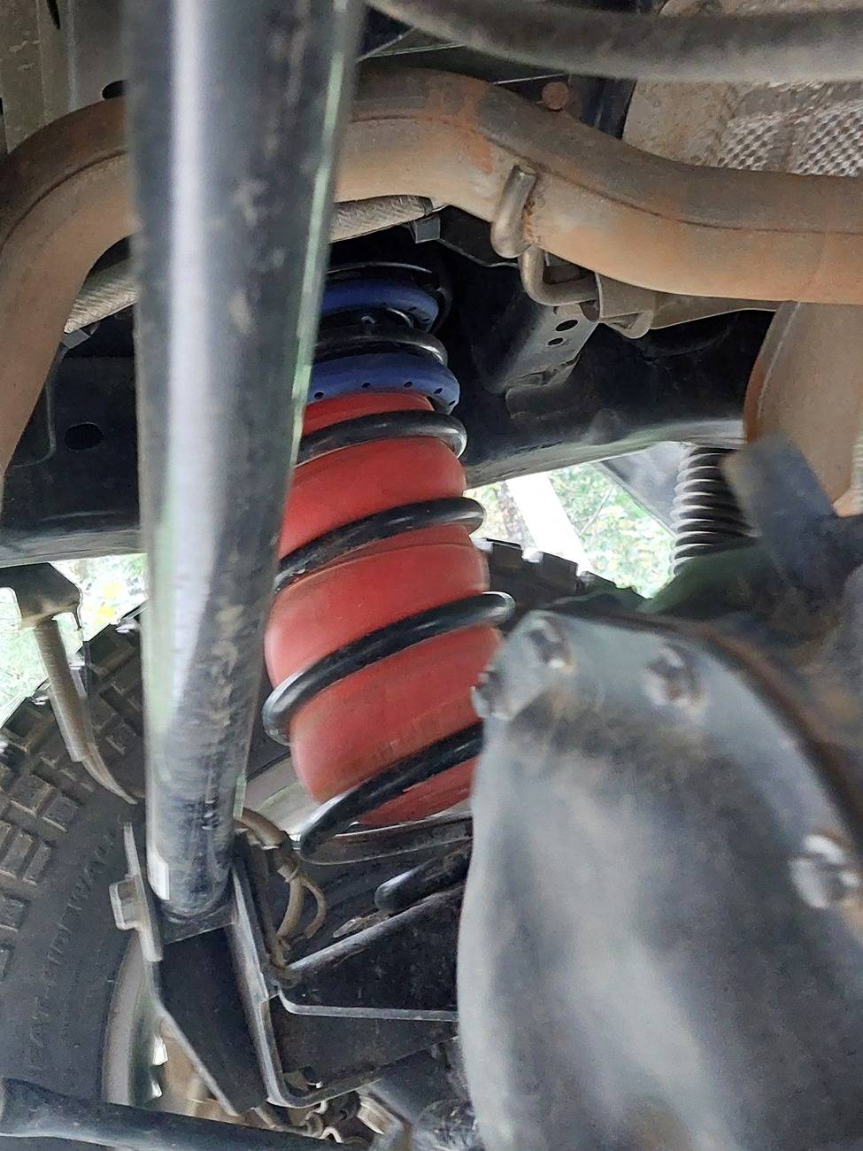

I've had them for a few years now I think I run around 19 psi or so. Awhile back I was on phone with Air-Lift to see about a better set due to the kit recommend being slightly to short.
Jeep Gladiator Going to see if airbags will help with rooftop tent seaying suspension. 20241102_142235
Jeep Gladiator Going to see if airbags will help with rooftop tent seaying suspension. 20241102_142218

You need a min 5psi in there and yes, I too have the Air Lift 1000’s in the back of my 21 JTR and when I’m loaded down with the wife, Dane and all the camping gear, I put the bags to 25 psi. They will take 30 but I stop at 25. It makes a huge difference and will play interference with the swaying. You’ll be happy
