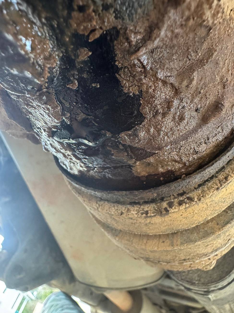

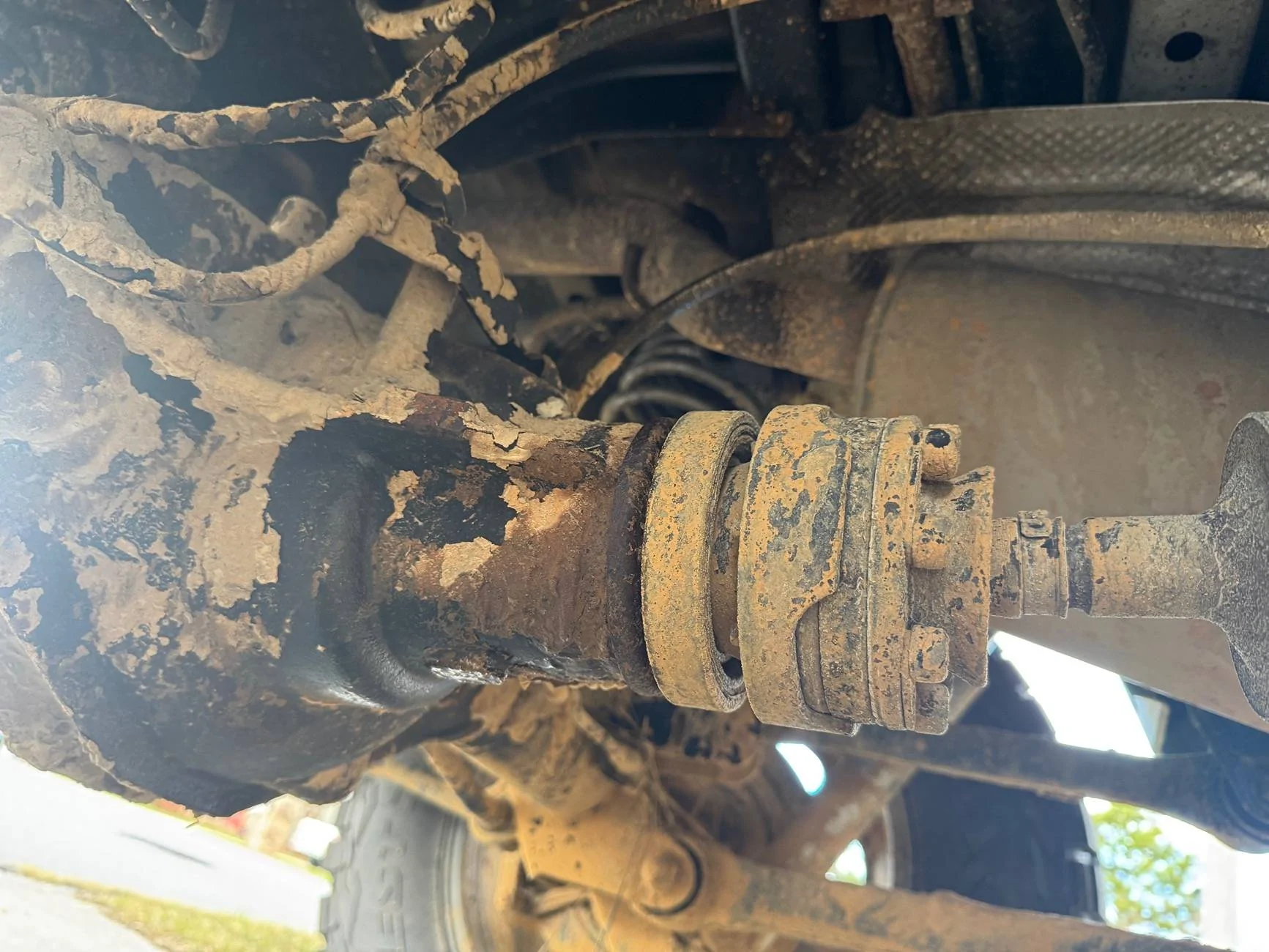

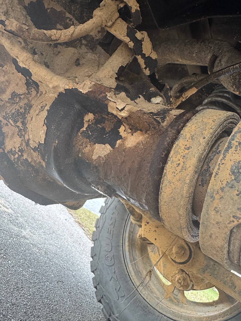

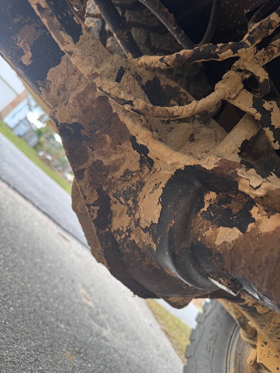

Give that a good pressure washing all over and under. Then drive a few days only in road, to keep it clean. Then go to a dealer to set a warranty claim in motion if still within the 36/36,000 bumper to bumper warranty range. Quickly, and ask them to change the fluid. If it’s leaking out that bad, then it’s leaking in as bad in wet muddy off roading.

The problem I have letting anyone else do this kind of work is that they don't care. They will take it apart, pry out the old seal pound in the seal and put it back together. It will fix the leak and you will be happy..... for a while. Then you will end up with a whine or growl, followed by another leak. More down time if still under warranty but lots of money if out of warranty. I would definitely follow the tech authority proceedures.
