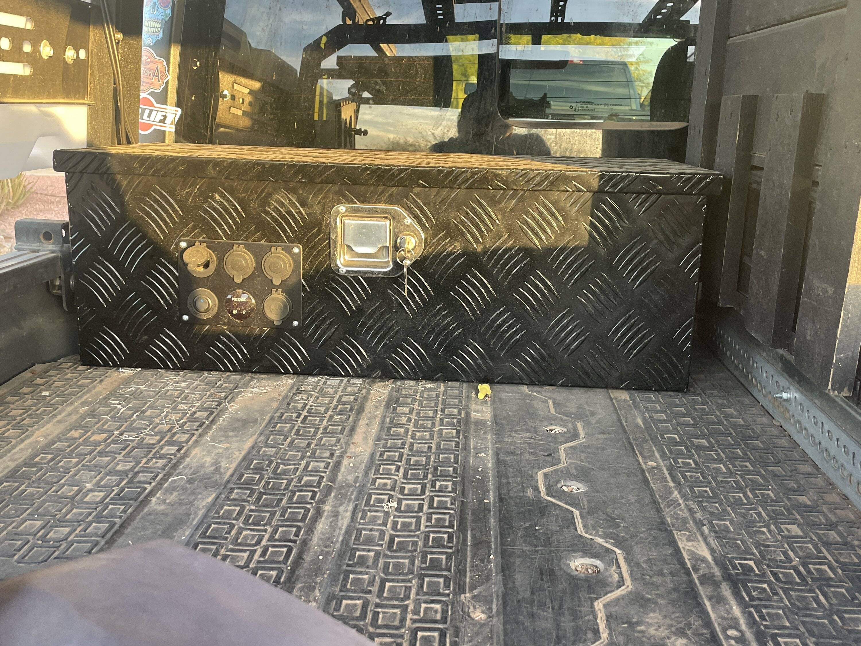

Wife wanted something to fill receiver hole
Made this for her yesterday
I will texture paint it this weekend to match lettering

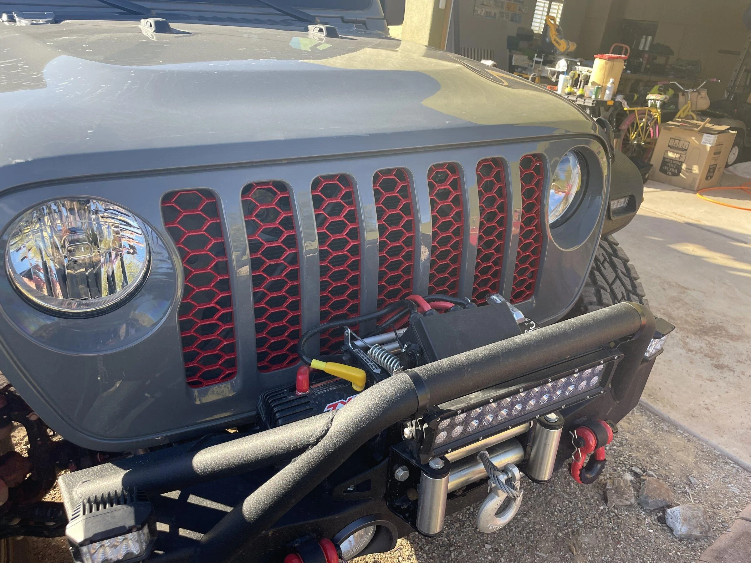

Painted front grill insert today

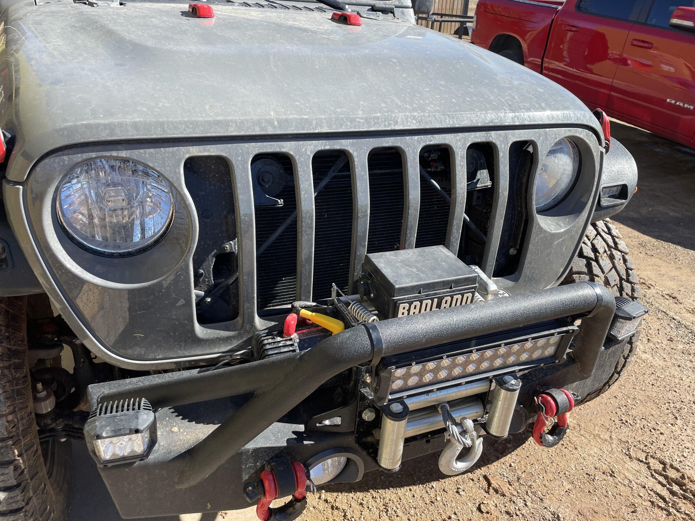

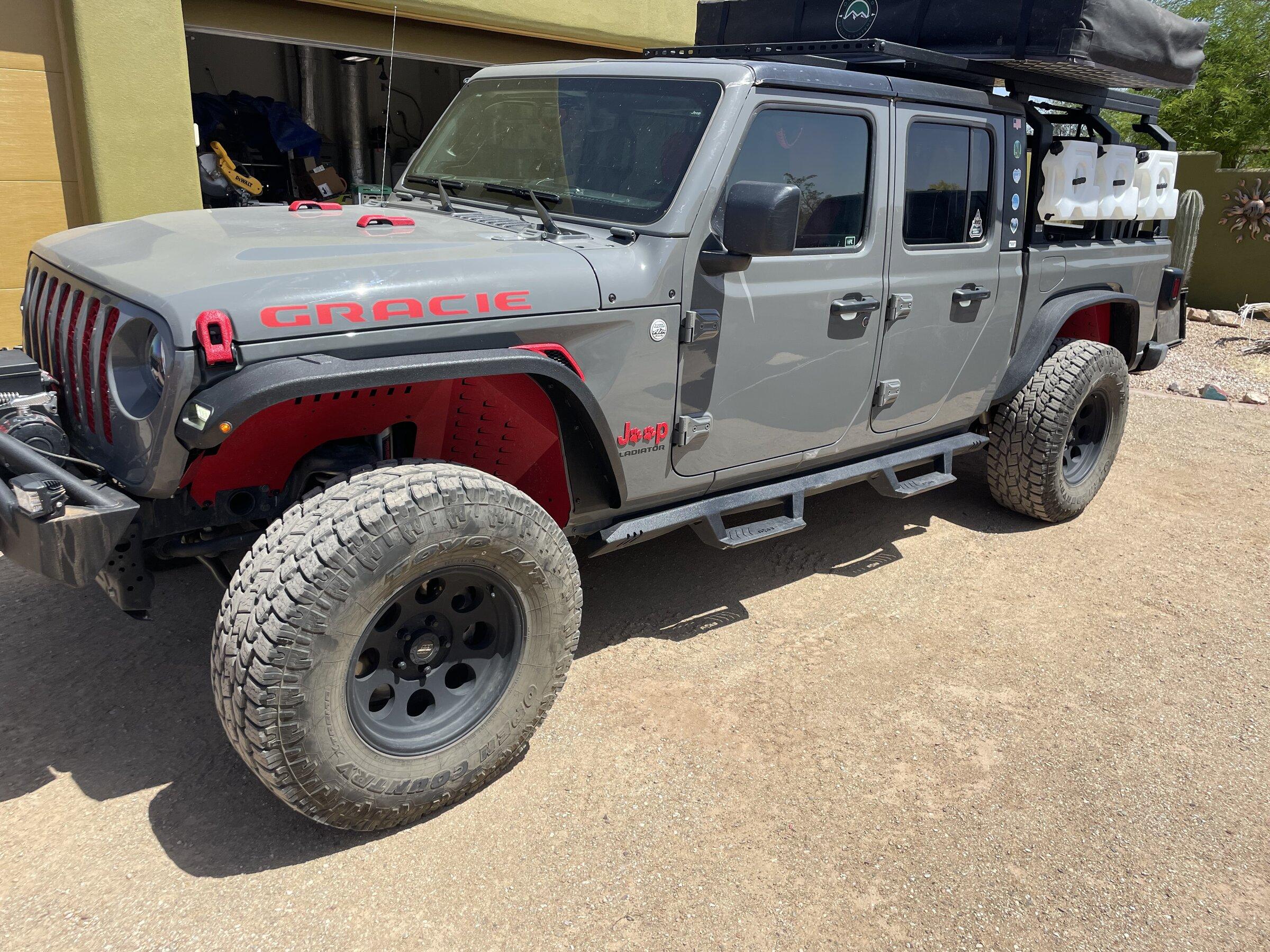

Added some more color to Gracie with grill being painted and new lettering
Jeep Gladiator Gracie(stingray)Overland build 4A501BC7-331C-4A74-94B5-0A60DD2C5643
Jeep Gladiator Gracie(stingray)Overland build F26B0B76-635C-43A1-9034-6CFA813461F9

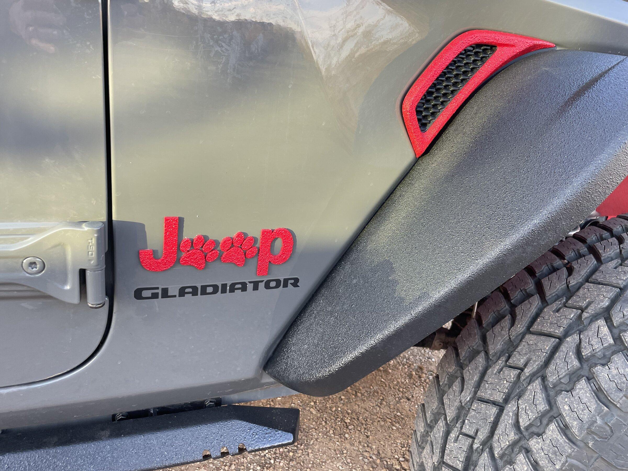

Added some more homemade red accents
Jeep Gladiator Gracie(stingray)Overland build E3A3D00C-73D3-40CF-B57B-2641CBF6B07E
Jeep Gladiator Gracie(stingray)Overland build A0290B2D-4872-48CC-9D7B-407964FD053B
Jeep Gladiator Gracie(stingray)Overland build 8F44A5BE-C714-47D7-B1C4-6112604C87B3

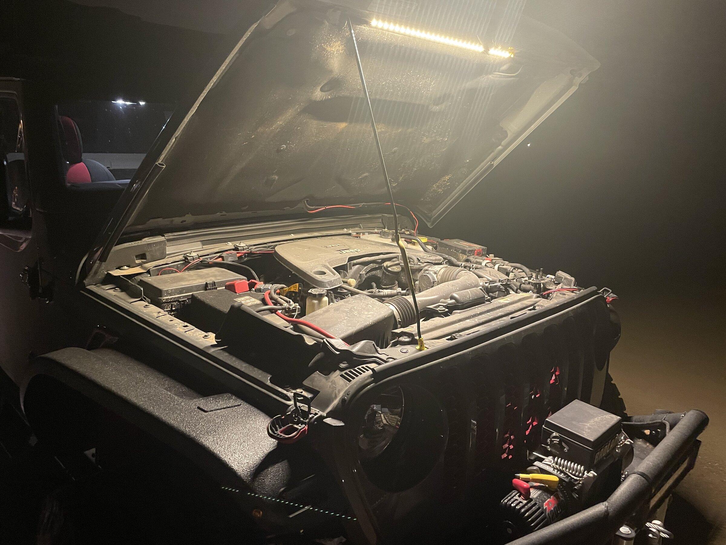

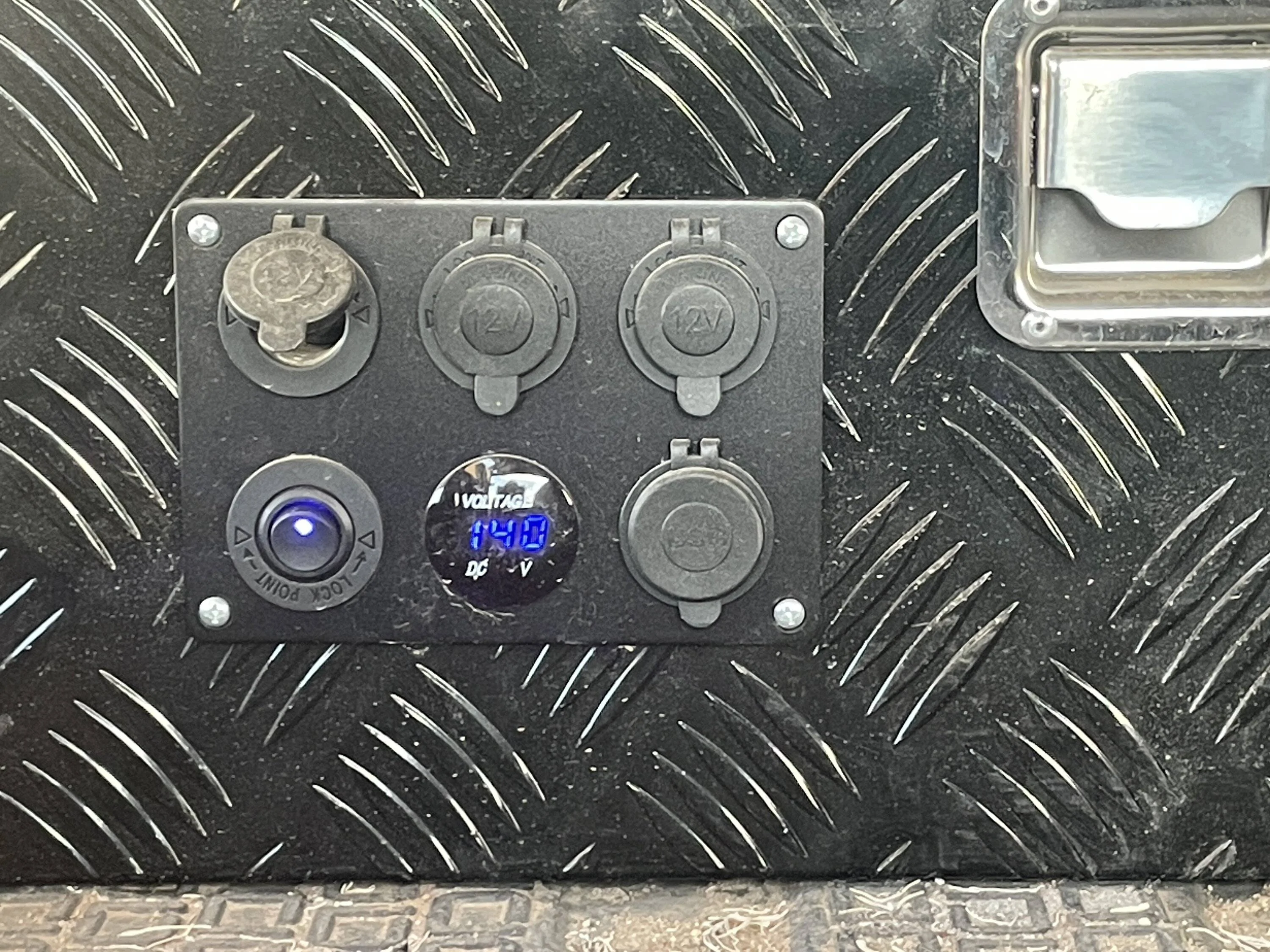

Added LED bar under hood
For the night time issues ?never happen
Connected it to the voswitch I installed

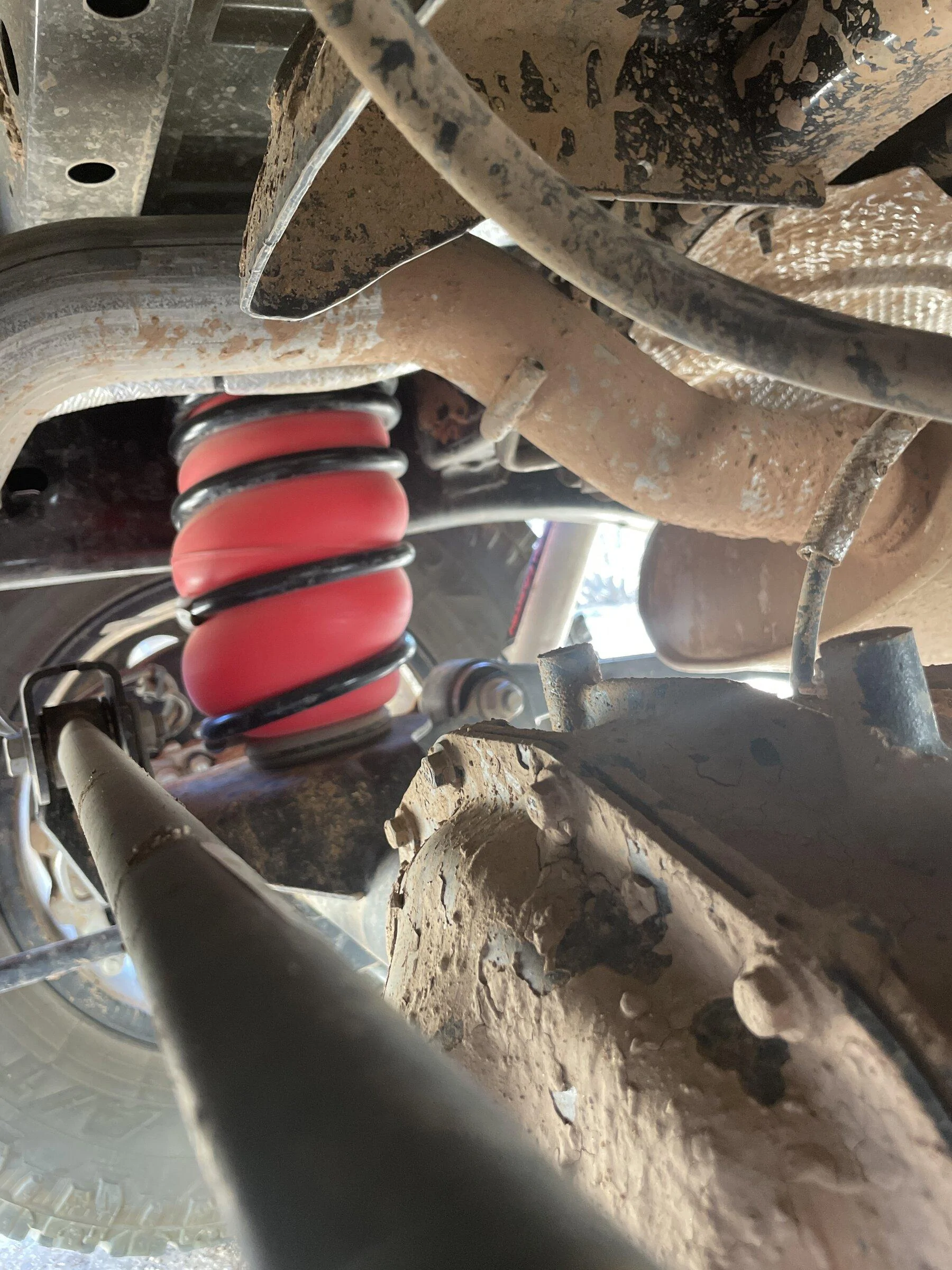

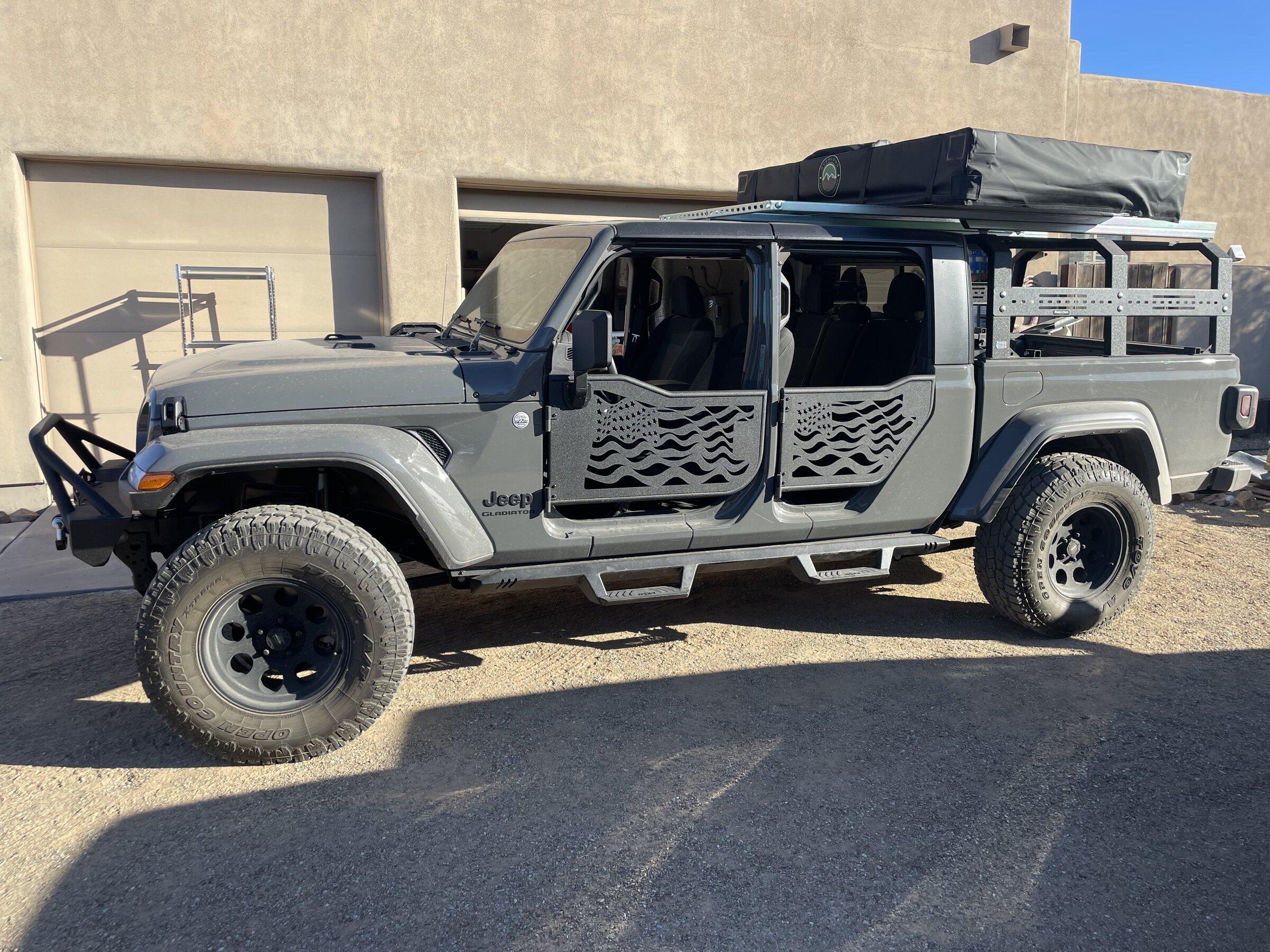

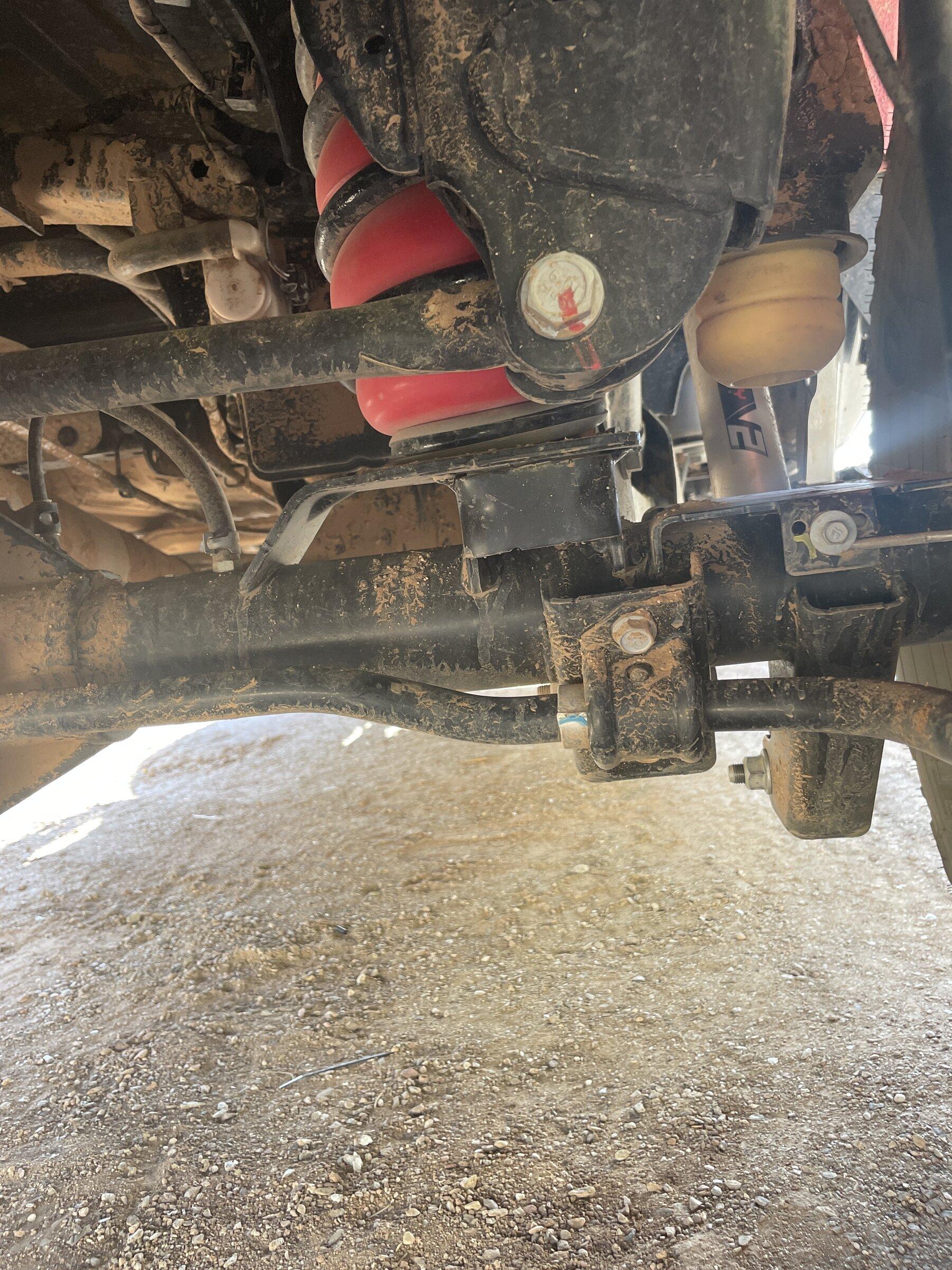

Added air-lift air bags to rear springs
To limit swaying action and help with bump stop hits
Have them set at 25psi
made significant change in yaw motion
Also increased spacing between bump stop and axle from 1.5” to 2.75”

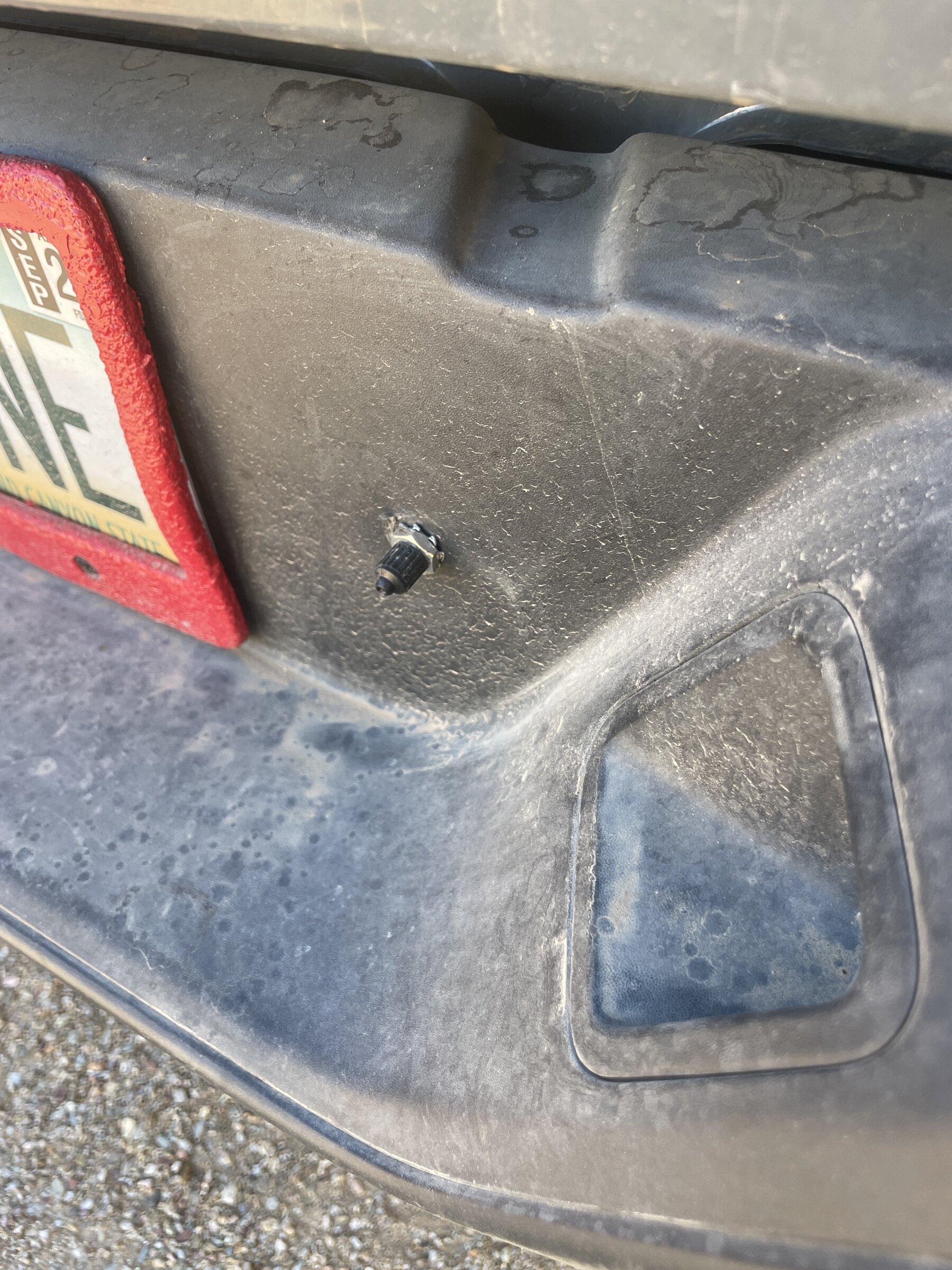

Installed valve stem next to license plate on rear bumper
Future add of rock jock anti-rock swaybar
The bags should limit roll that is usual side effect of system
I hope

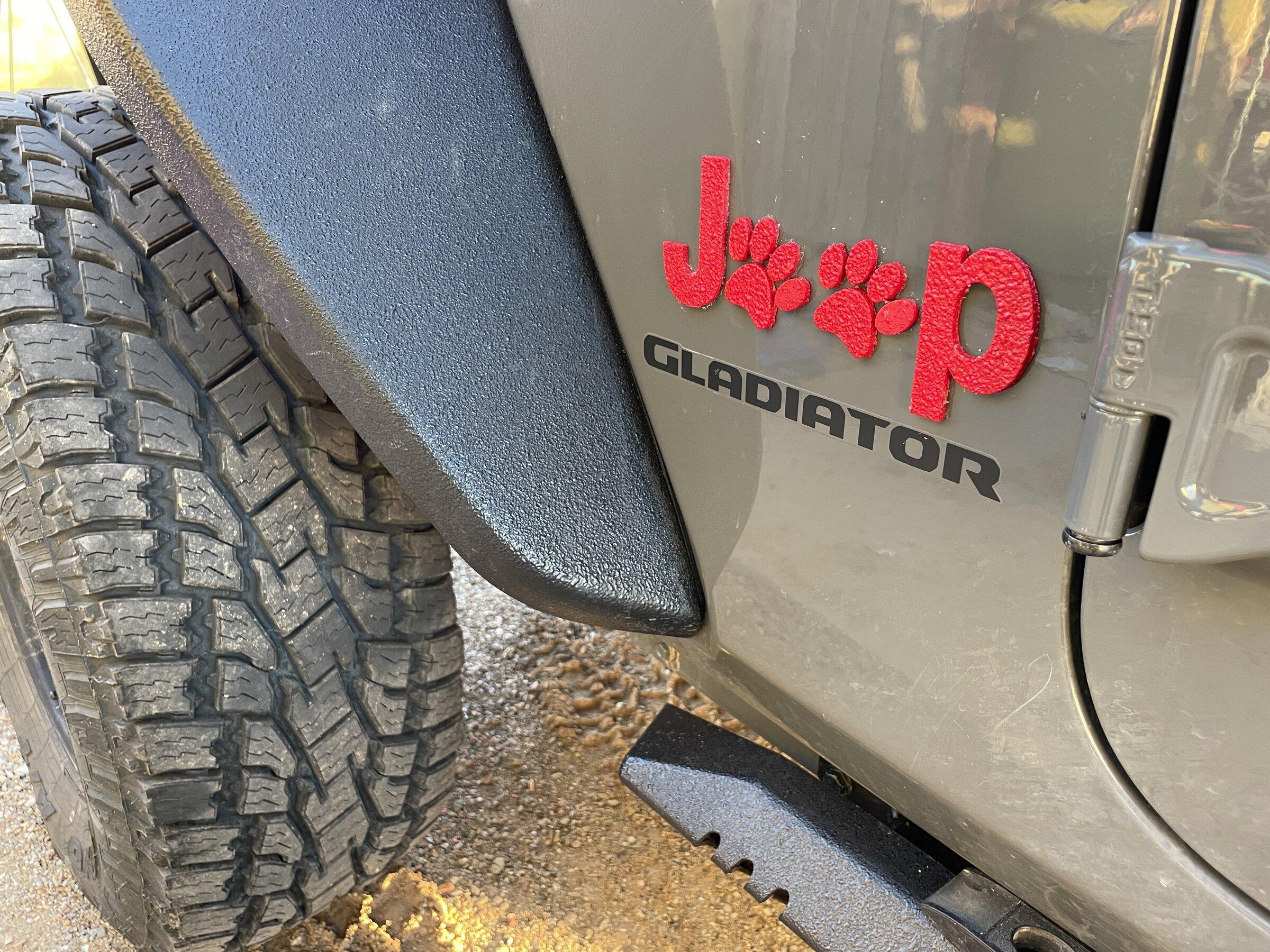

Made it official
Put her name on this week

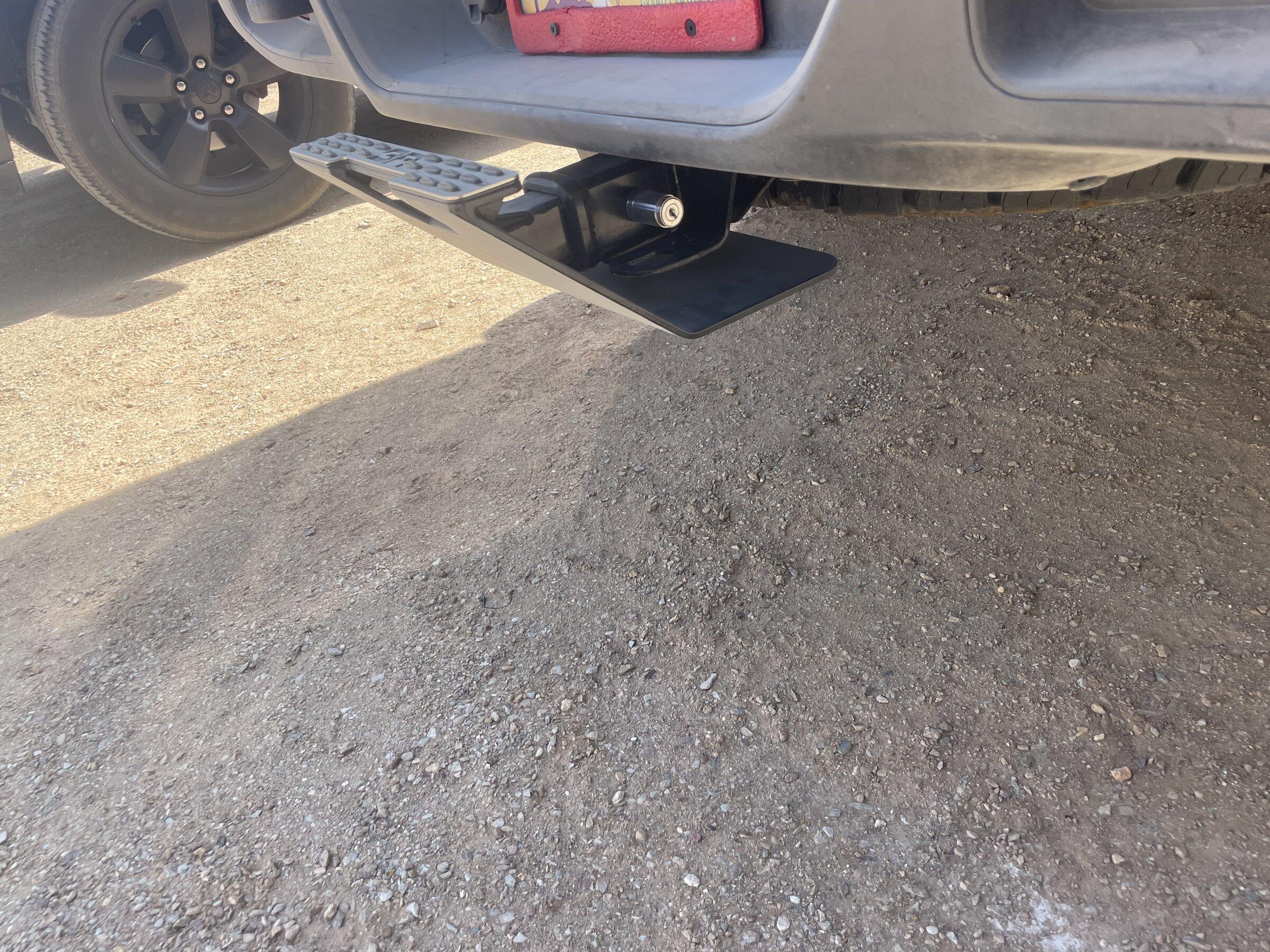

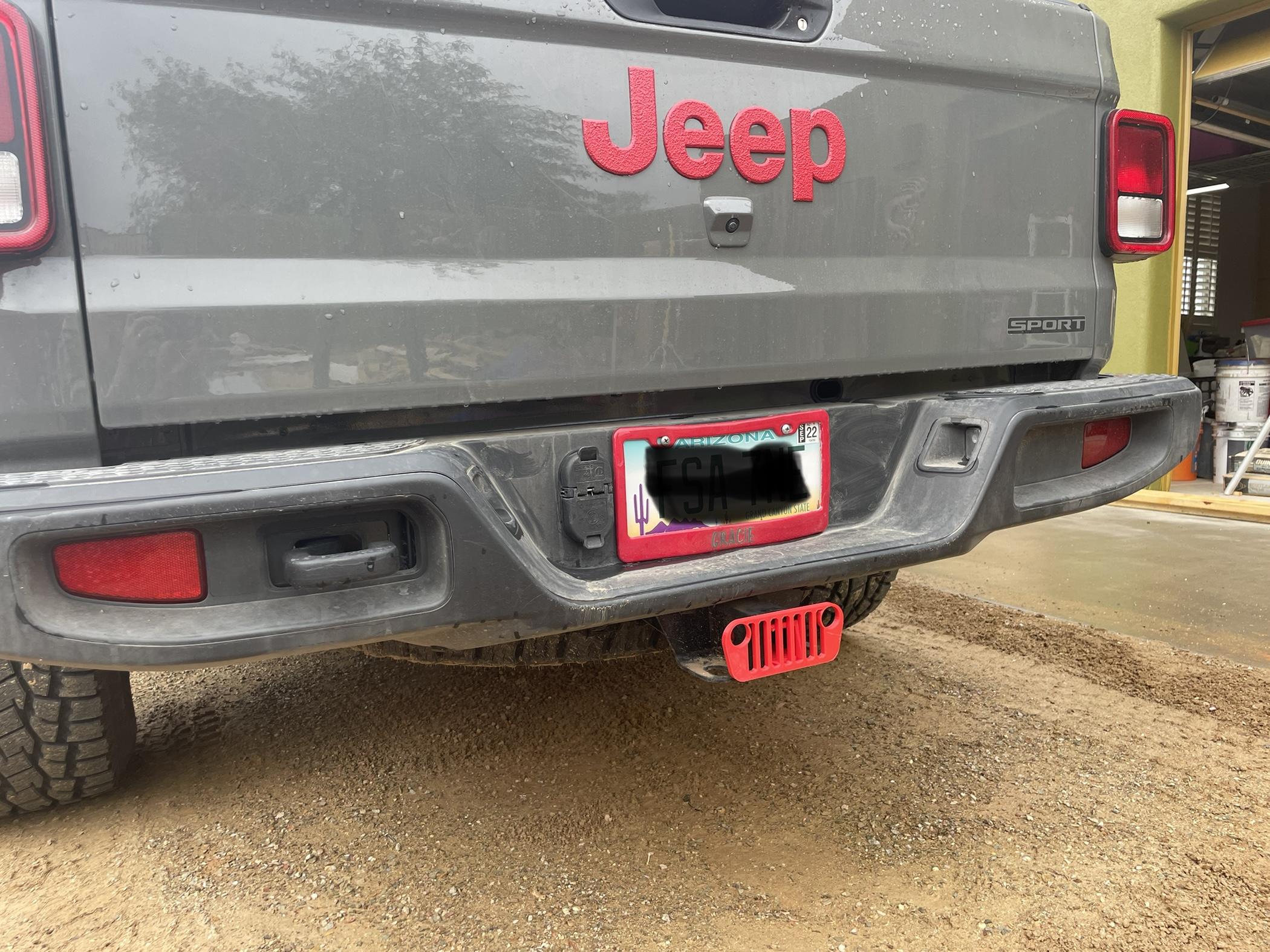

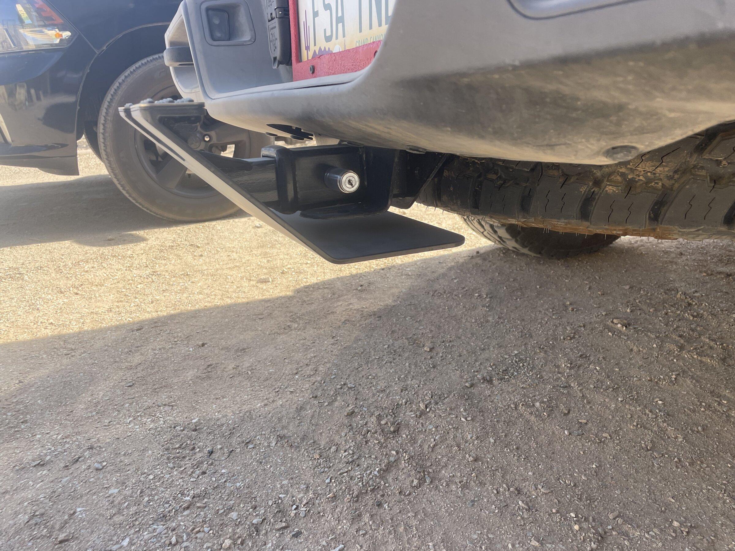

Added rear Body Armor hitch skid plate with locking pin
Jeep Gladiator Gracie(stingray)Overland build 8C8C0AD4-5187-47E3-8D41-19290E99DCF1
Jeep Gladiator Gracie(stingray)Overland build D0CD4354-DE76-4E68-A51B-330AE2CD7917

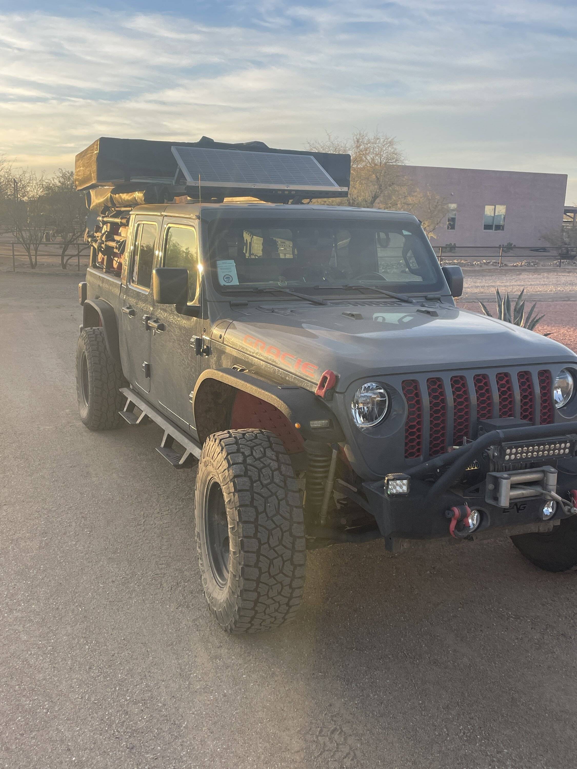

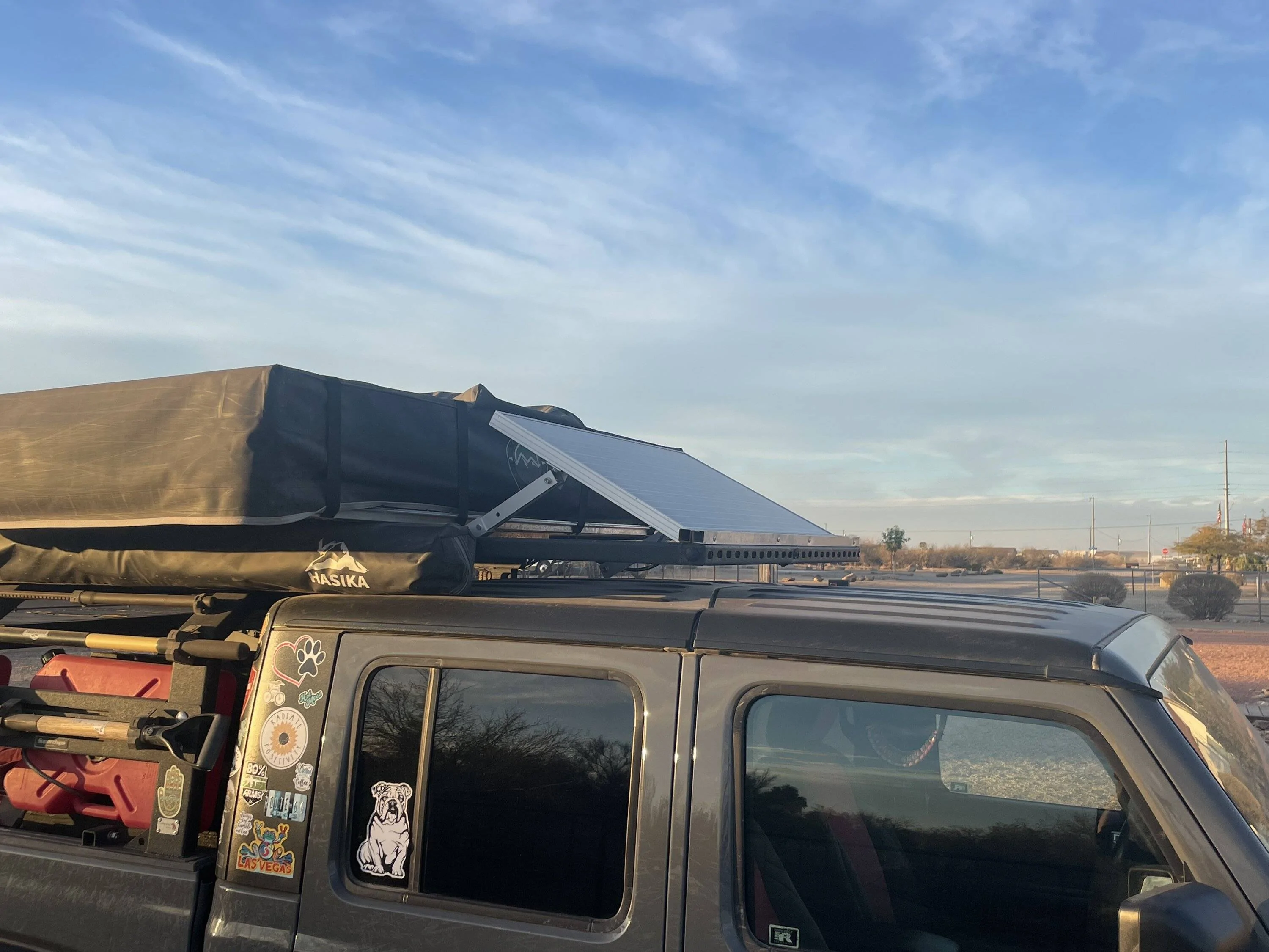

Added solar to the rig this week small 200watt panel
but have 200ah of batteries hooked up
figured it would have days to charge in between uses
Also have 2000watt inverted to add also
make a good air deflector over tent also
