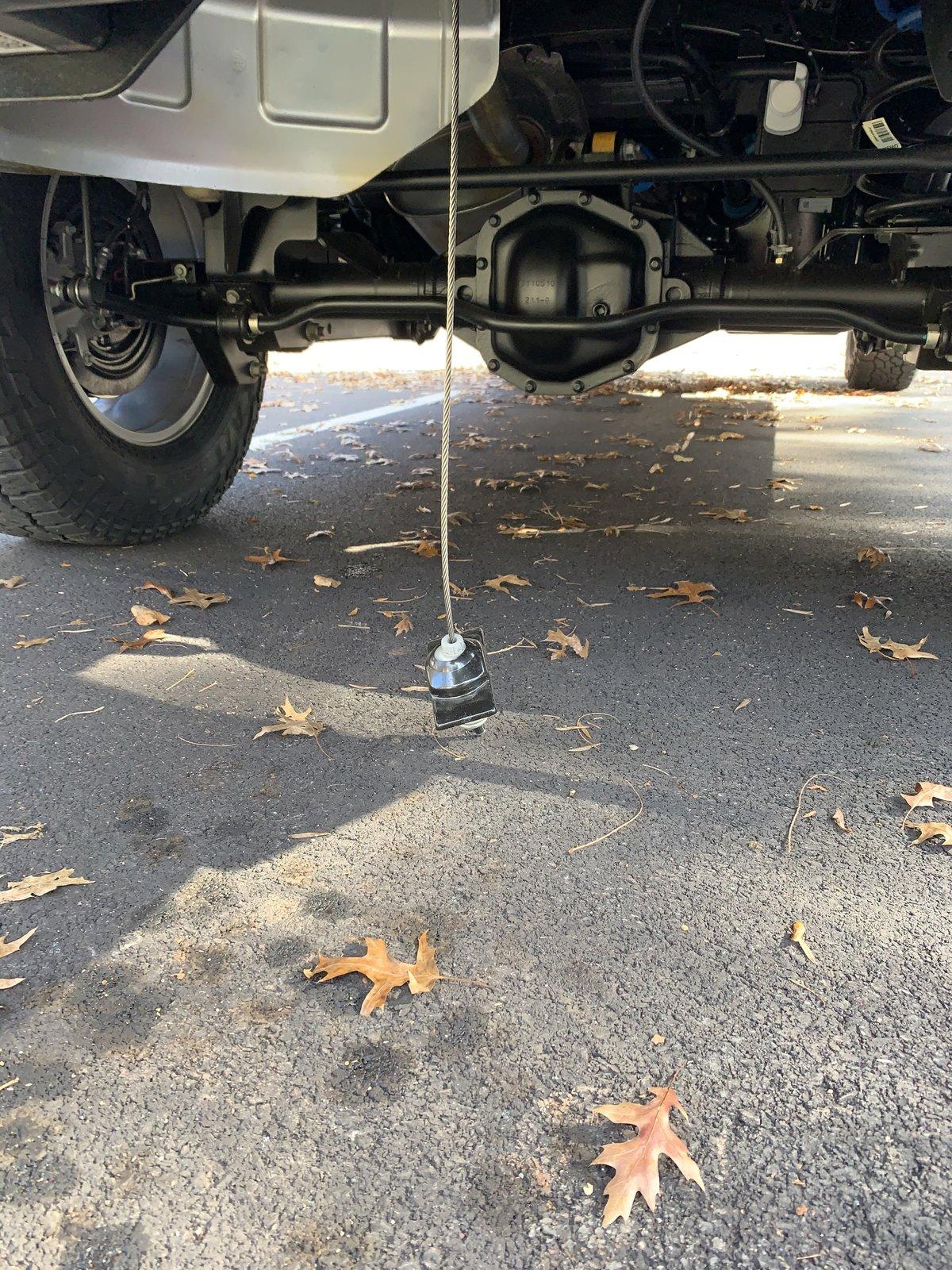

I think it's the hanger. The steel spare had a larger inner hole than the other tires so it might not fit the pully.

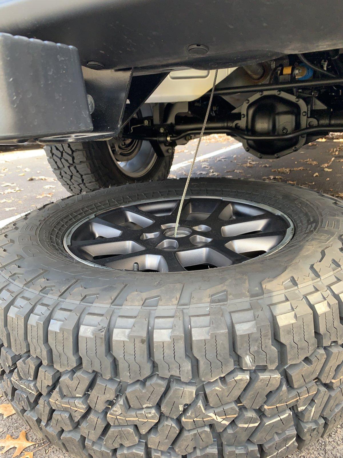

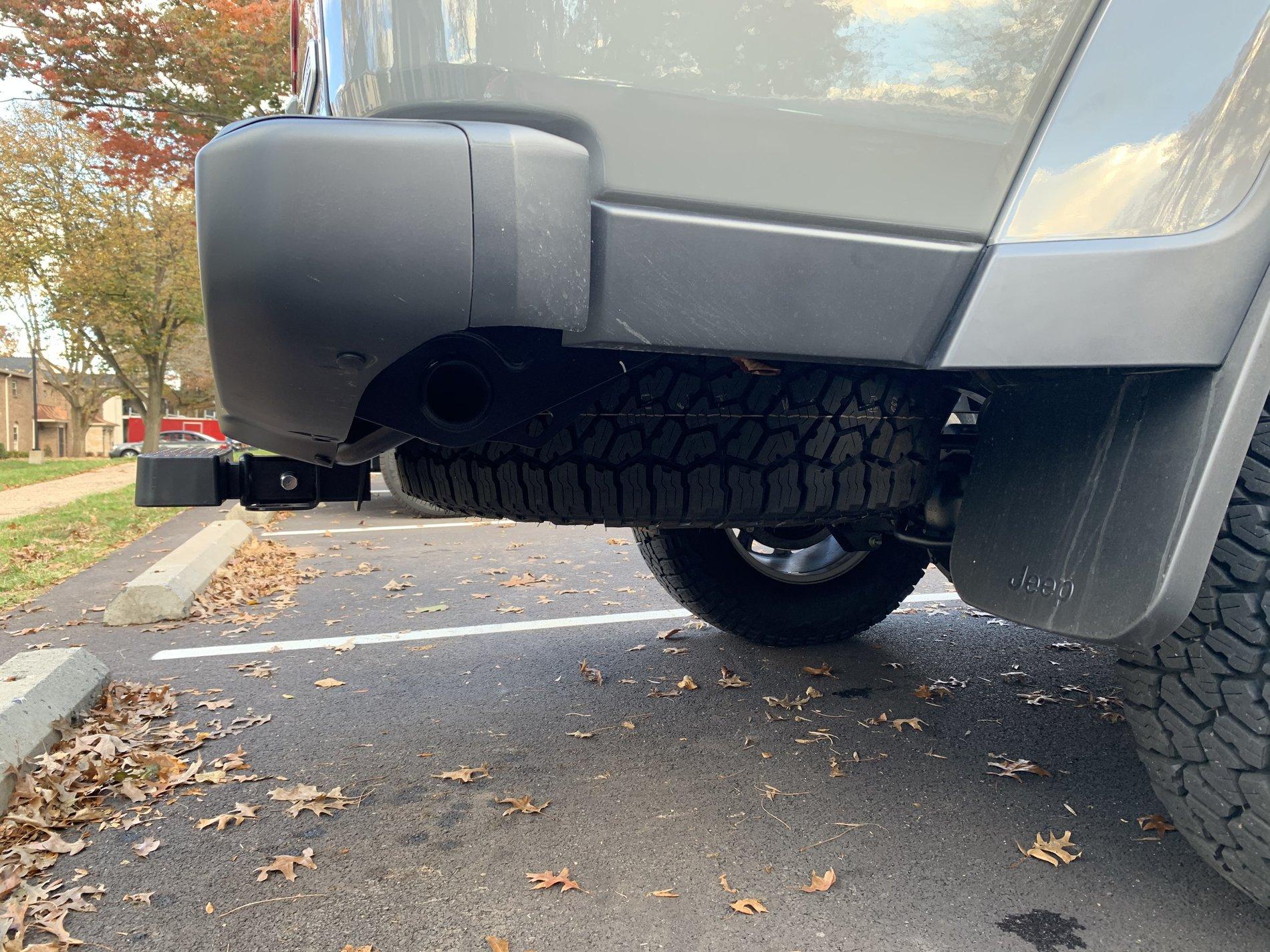

Alright, picked up the spare with TPMS from the shop and had no issues installing the tire / OEM wheel in the spare tire slot. The spare carrier was a little snug fitting through the center of the wheel, but it made it through with no issues.
