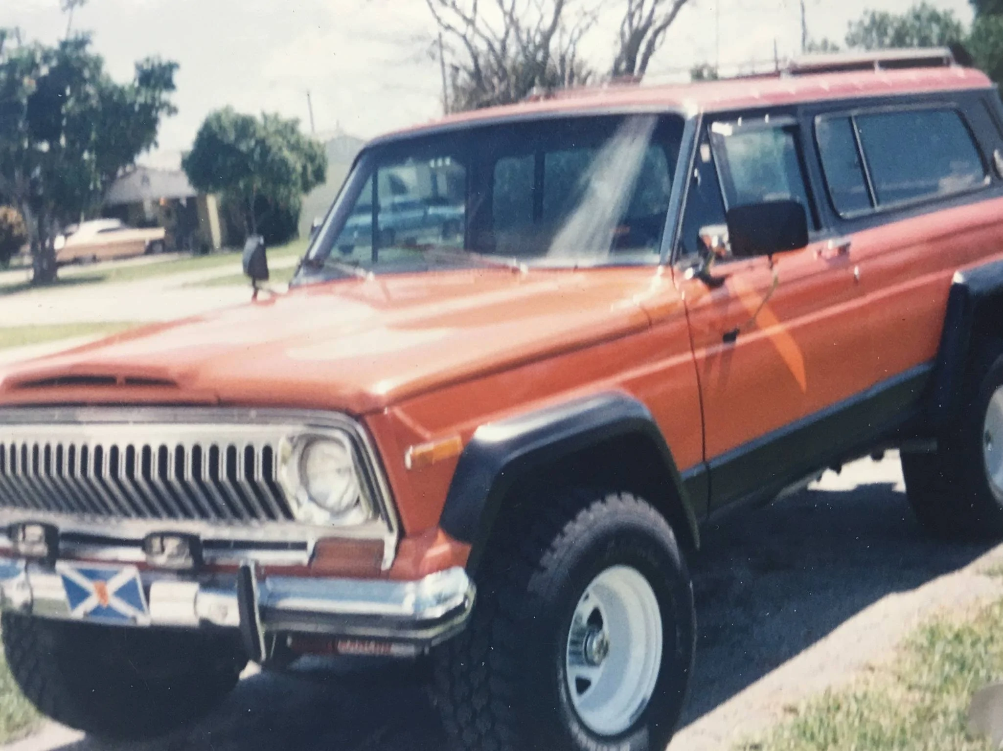

My chief had a zerk fitting on just about every moving part. It had 240k miles on it when I sold it. Not to mention most bolts were 1/2” or 9/16. No computer but loads of rust. I wonder if my Mojave will make it to 240k.
