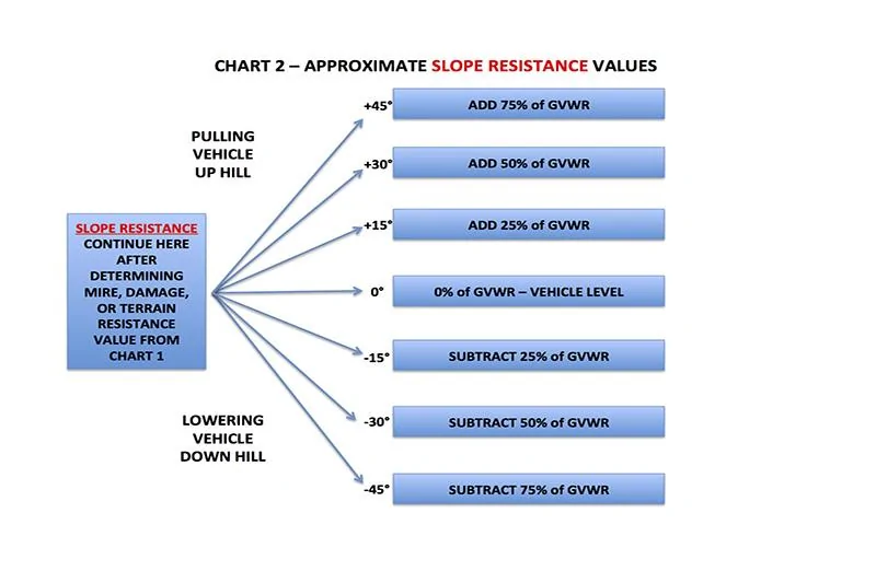

Slope Resistance
Jeep Gladiator Great Write-Up on Winch Recovery Resistance-Chart-2-Correction

  • Find Slope Resistance. The stuck vehicle is on a 15° slope, so the added slope resistance is 25% of the GVWR = 1,250-pounds. Calculation: .25 x 5,000 = 1,250-pounds
  • Safety Margin. Add 25% of stuck vehicle’s GVWR to your total resistance calculations. Calculation: .25 x 5,000 = 1,250-pounds
  • TOTAL Estimated Resistance. 5,000 Mire Resistance + 1,250 Slope Resistance + 1,250 Safety Margin = 7,500 total pounds of approximated resistance

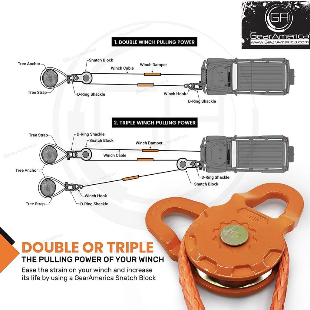

Snatchblock, that is your friend. Allows you to get more cable off the drum to maximize pulling power.
it is a pulley, so you double the power. It also cuts your line speed in half.
So, a 10k winch becomes 20k.
I believe every winch sold should come with a snatch block. It’s that important IMO.

As said previously, snatchblocks are a must, which is why I carry 3 of them with me. For the multiplication factor or change of direction pull.

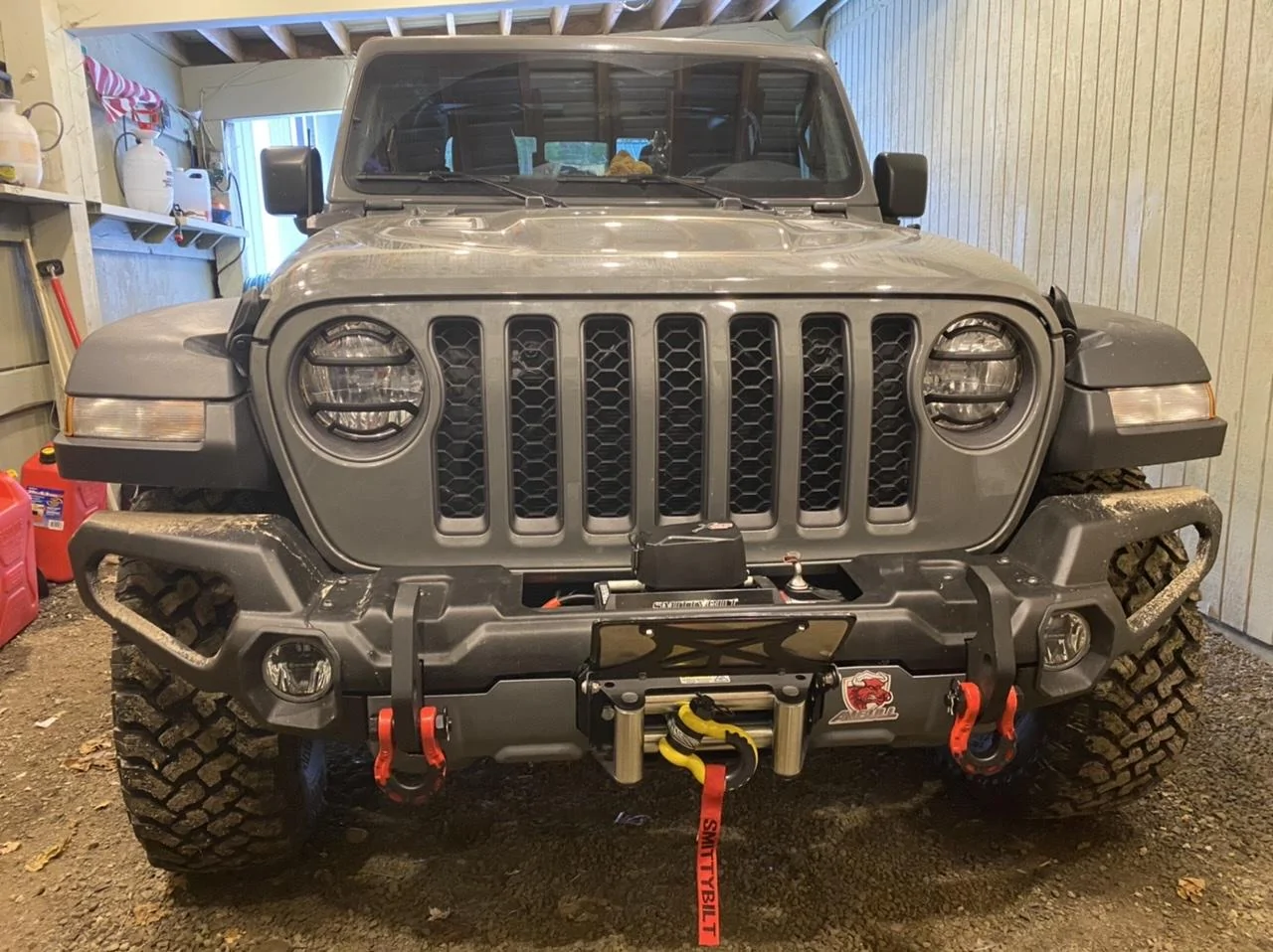

Below is what I picked up as an affordable under $500 (less the cost of your winch plate or bumper) start to winching. Everything has a WLL thats at or under what my winch can pull, so everything should be safe.
Smittybilt XRC 9500 gen 2 - $320

Gear America 12T Snatch block - $50
Allows for doubling of the winch power and direction changes. I’ll look at getting a second one as a just in case down the road, but I don’t see extreme mud or situations that would call for a second one immediately to have to add it.
Additionally, the working load limit of this is 6T, double the Gladiator’s weight with some payload. Adding a third would put me at 9T and reduce my total safety margin, while still under the fail limit of 12T.
So this 12T model would work to triple in a pinch, But if you feel you will likely need a lot of power, get a pair of the 20T ($100 ea) snatch blocks instead.

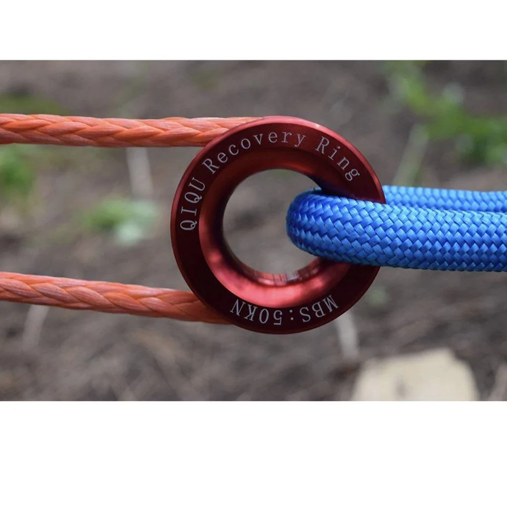

Additionally, theres neat gear like this recovery ring that works with soft shackles and synthetic line. So while this block works with both lines, if you are looking to go in with synthetic to start, you might want to look at these as they are lighter and smaller than the snatch blocks and may work for your use/style.
