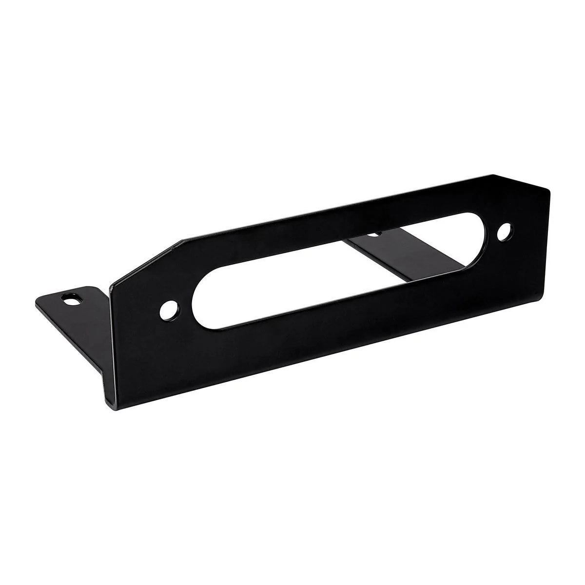

I'll PM you and keep off this thread...but yes LOD plate, expensive very light winch, and 1/4" steel plate across frame horns then some large flat washers to space it out exactly. Pix coming your way

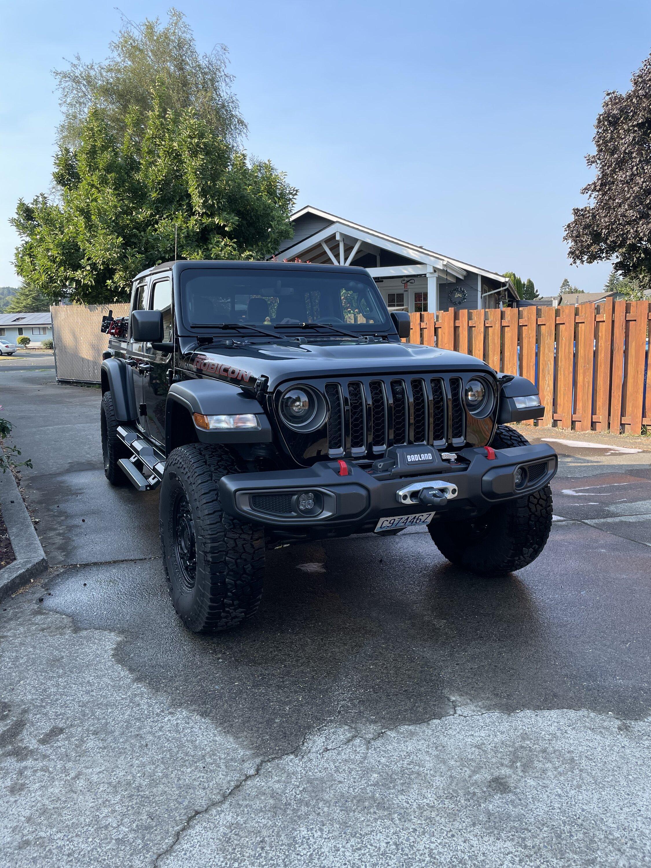

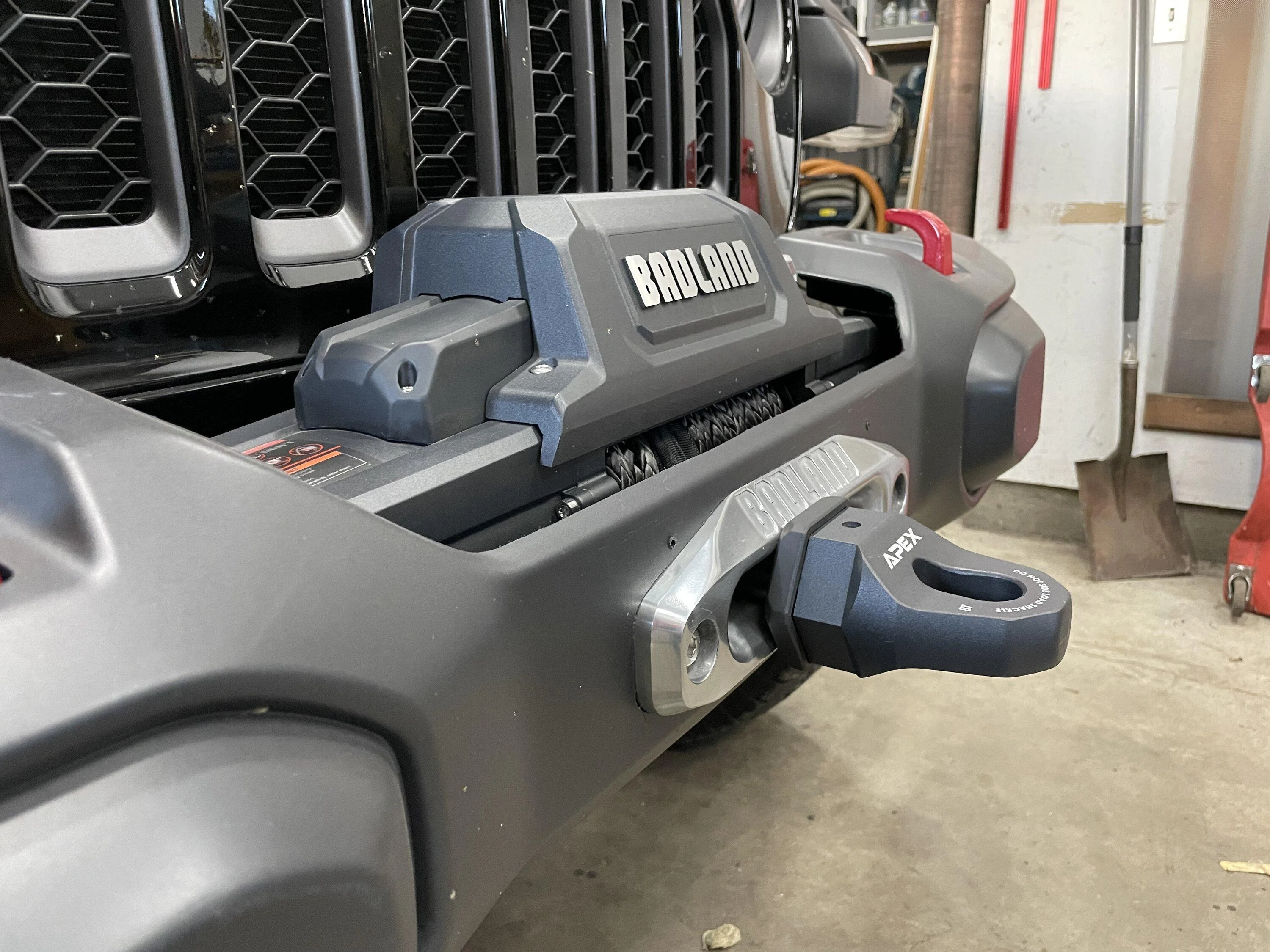

I just completed mine, also used the LOD winch plate (purchased used $40) and the Badlands Apex 12k winch.

Lot of guys are figuring out how to use the plastic bumper with winches, I used a LOD winch plate that fits flush with front of frame horns seems real solid and powder coating was excellent, plus price was right at $149.00……Jack
Ps: Rotating the clutch handle to rear let’s you keep bumper top area intact on some basic frame winches.

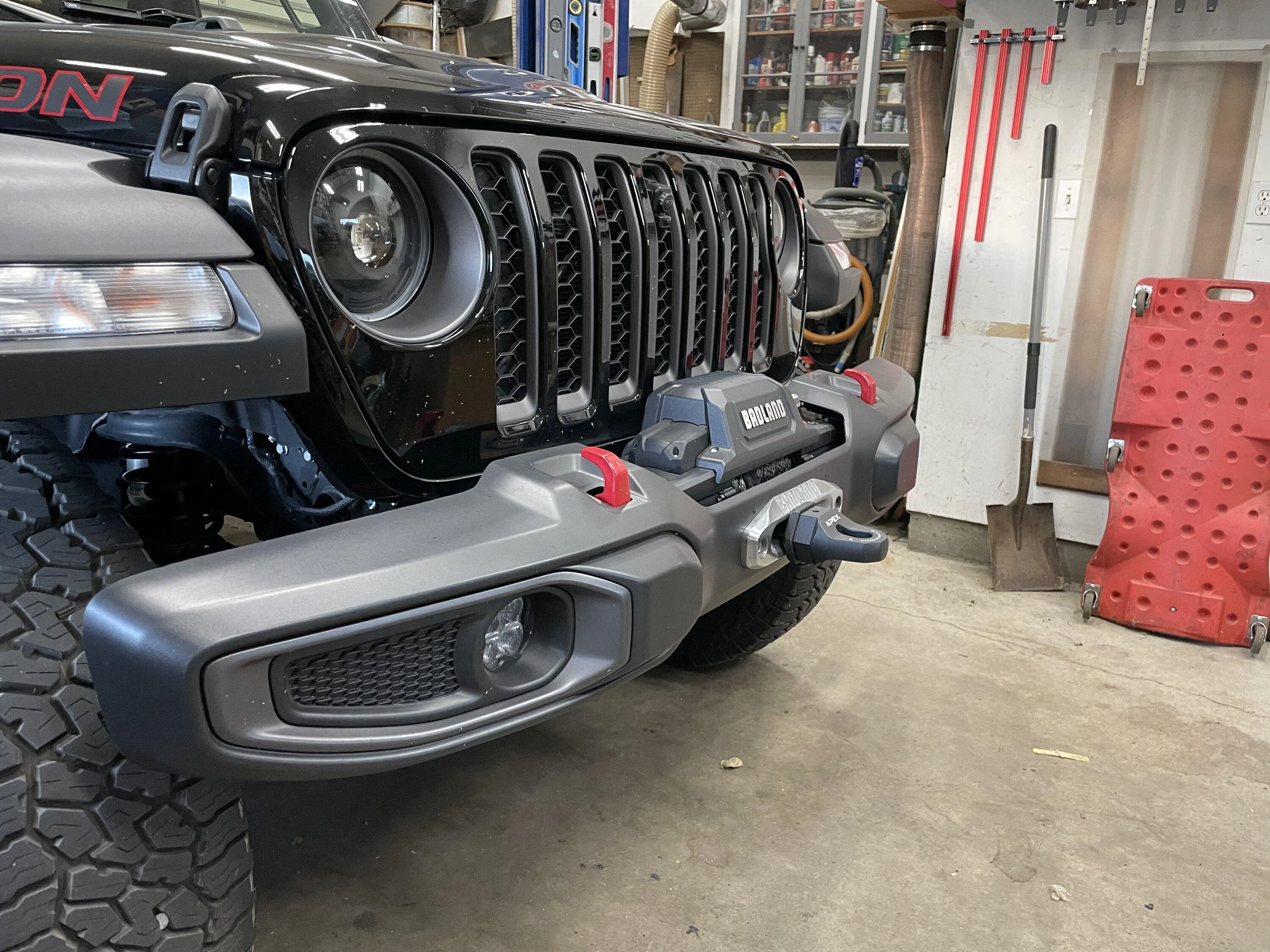

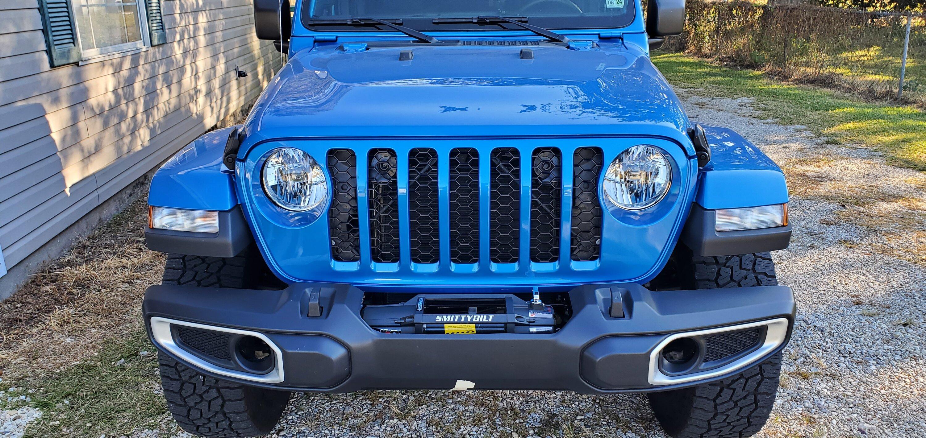

I liked this idea so much, I did it myself. Still another afternoon of work to do. Waiting on one more part. All the hard work is done.
Do you have details pictures of the process

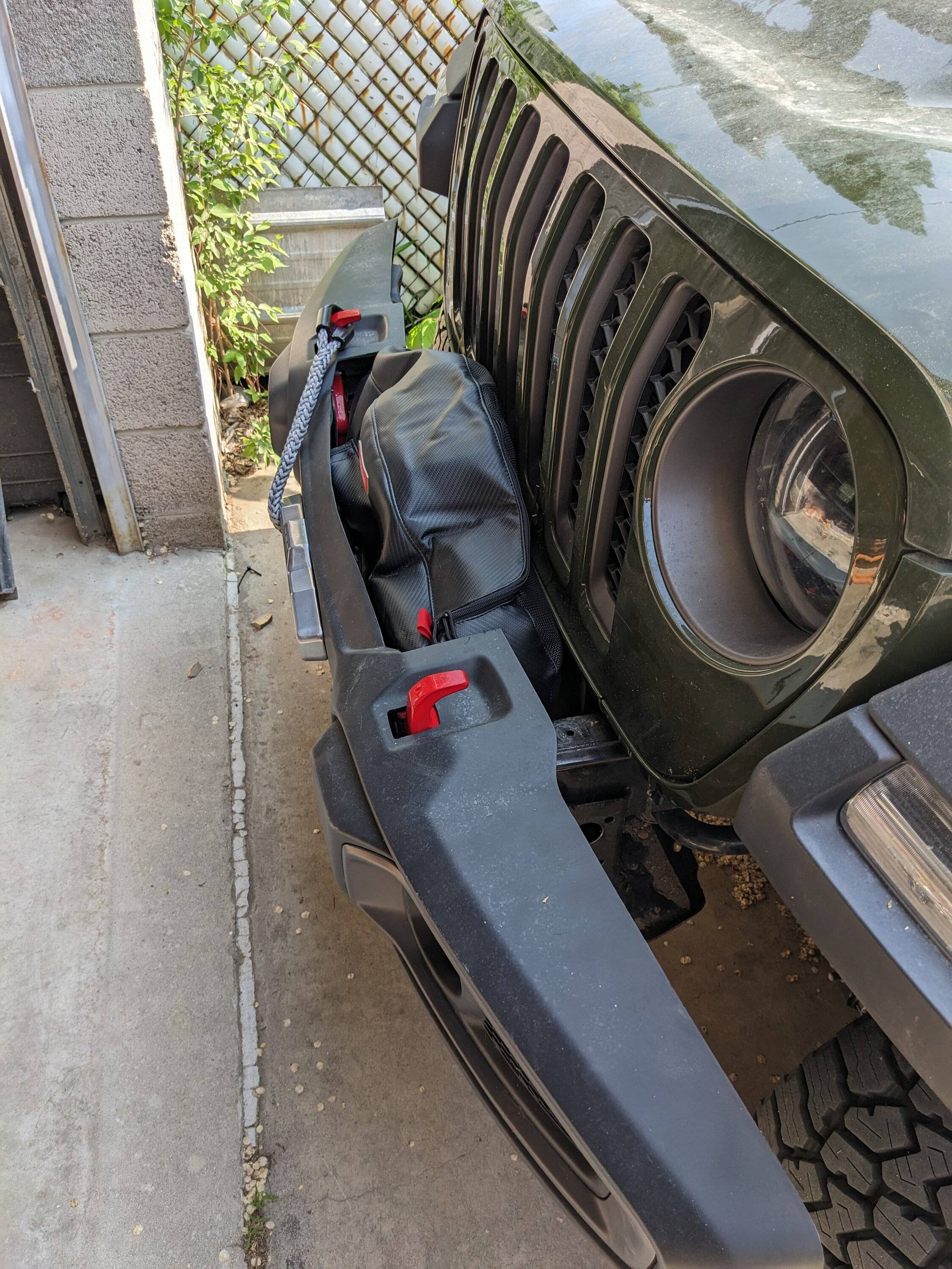

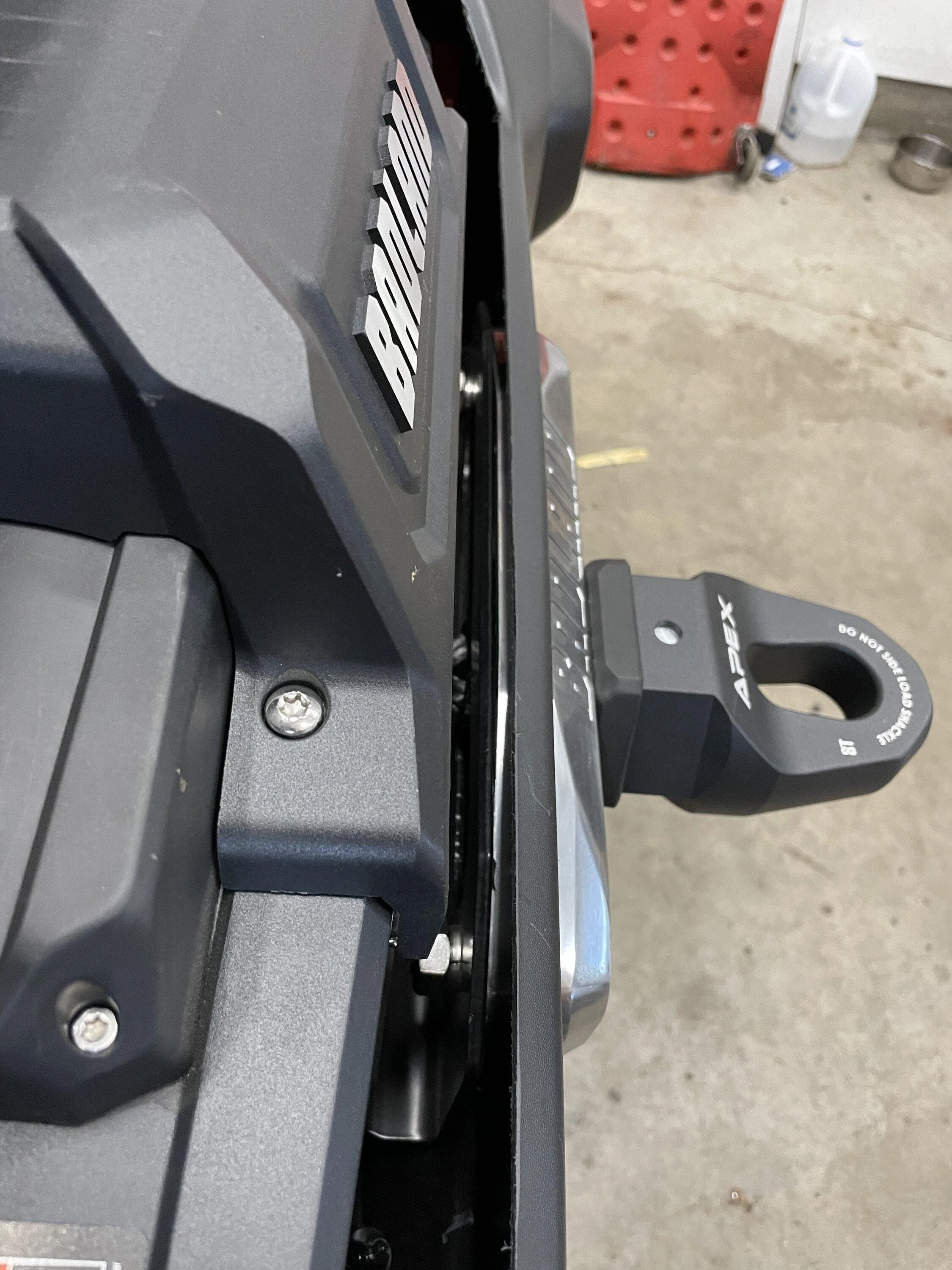

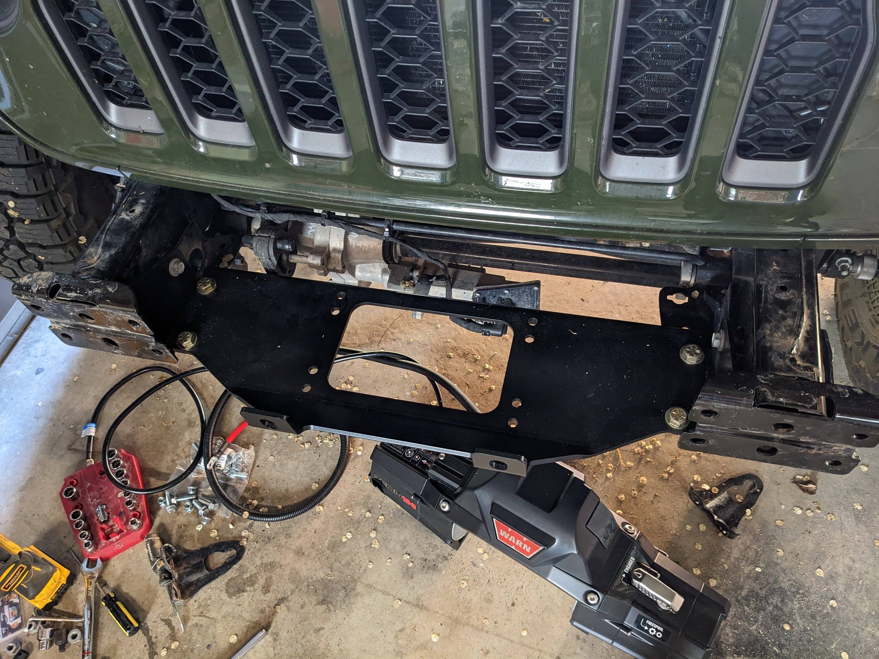

I am part of the winch in the plastic bumper group now.
Used the rock jock winch plate. I did have to enlarge the frame bracket holes as they were slightly off. I should email rock jock so they do better at the manufacturing QA.
As OP mentioned, lots of trimming and fitting. The zeon barely fits with the cover.
I initially tried to save the entire center portion of the plastic fog light frame, but ended up cutting out that as well. I just need one or two zip tie squares to secure the fog light harness
