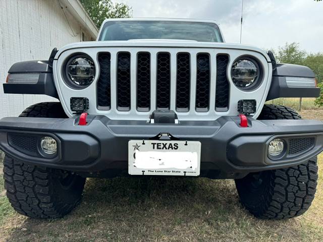

Need to make a few changes but it’s (mostly) done. I don’t like how far the license plate sticks out, thats really all I have left to do.
I’m liking yours the best of all I’ve seen in the plastic bumper! I’d like to know the winch brand/model, and any specifics to duplicate what you have.
Is the plate on a magnetic bracket? I’d love to see a couple close front shots without it. Here in OK we don’t run front plates.

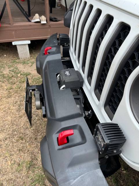

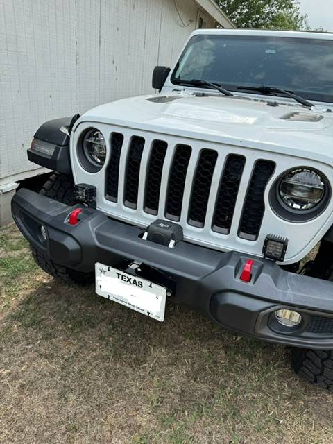

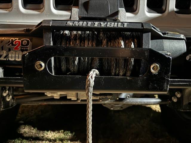

Thanks! it’s a 12k smittybilt x20 that I’ve had for about 8 years. LOD mount plate. I could’ve mounted the solenoid under the hood and kept everything “covered” but I’m impatient and didn’t want to wait for the material to arrive to extend cables and all that. I did have to use all the spacers that LOD included in the kit which left a could have the tow hook bolts a tad bit too short for my liking. Thinking of how to correct that. Might need to either trim the stock grill or go with a 2024 version.
the license plate mount is from Amazon. It slides in behind the hairless. I got it because I have the factor 55 flatlink e AND I live in Texas where we have to run front plates. The X20 hawse fairlead got mounted behind the bumper because the wife said “black looks better”. So the Amazon fairlead got mounted on the outside.
I’m waiting for some parts to finish the install, hoping to clean it up a bit. I’ll post my results when it’s done. If you have questions don’t hesitate to ask.

Getting the fair leads mounted problem has been solved. Nutserts! I drilled the fairlead mount holes a hair bigger and set some M12 nutserts into them. Now I can remove/repkace/modify my license plate holder without having to pull the bumper and fairlead mount off. Still need to modify the plate mount to suck it in a bit.

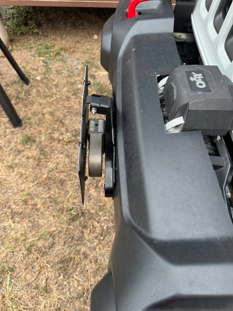

Got a chance to modify the plate holder. It looks much better now. Just don’t look too close because I left some tool marks haha
Also, sorry for riding this thread so much with my own posts, but it’s one of the ones that motivated me to do this so I’m hoping my pics help the next guy.
