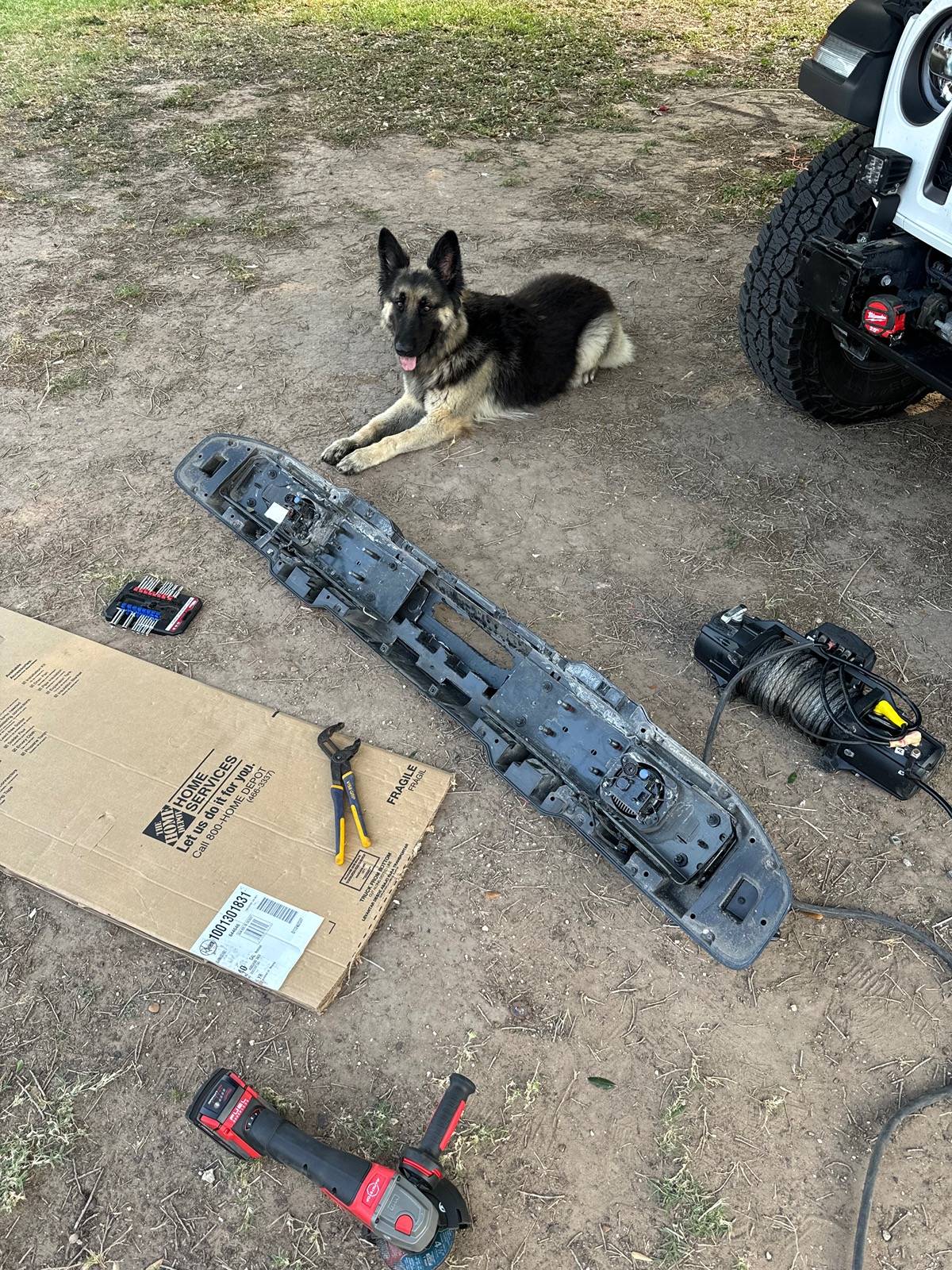

I really want to join the club. Using a RH plate that sits on top of the bumper and while super solid, I want a recessed mount that doesn’t block the grill. Looks like an LOD plate and a cutting tool is all that’s needed? And instructions of course!
That’s it. I used an angle grinder for cutting the thin metal skin behind the plastic bump. A dremel will work perfect for the plastic. It really isn’t that hard at all. Just takes a little time to measure, cut, and adjust. Start smaller than you think and walk it out to the right size. In this pic you can see the plastic I removed. That should give you an idea of how much you’ll be cutting.

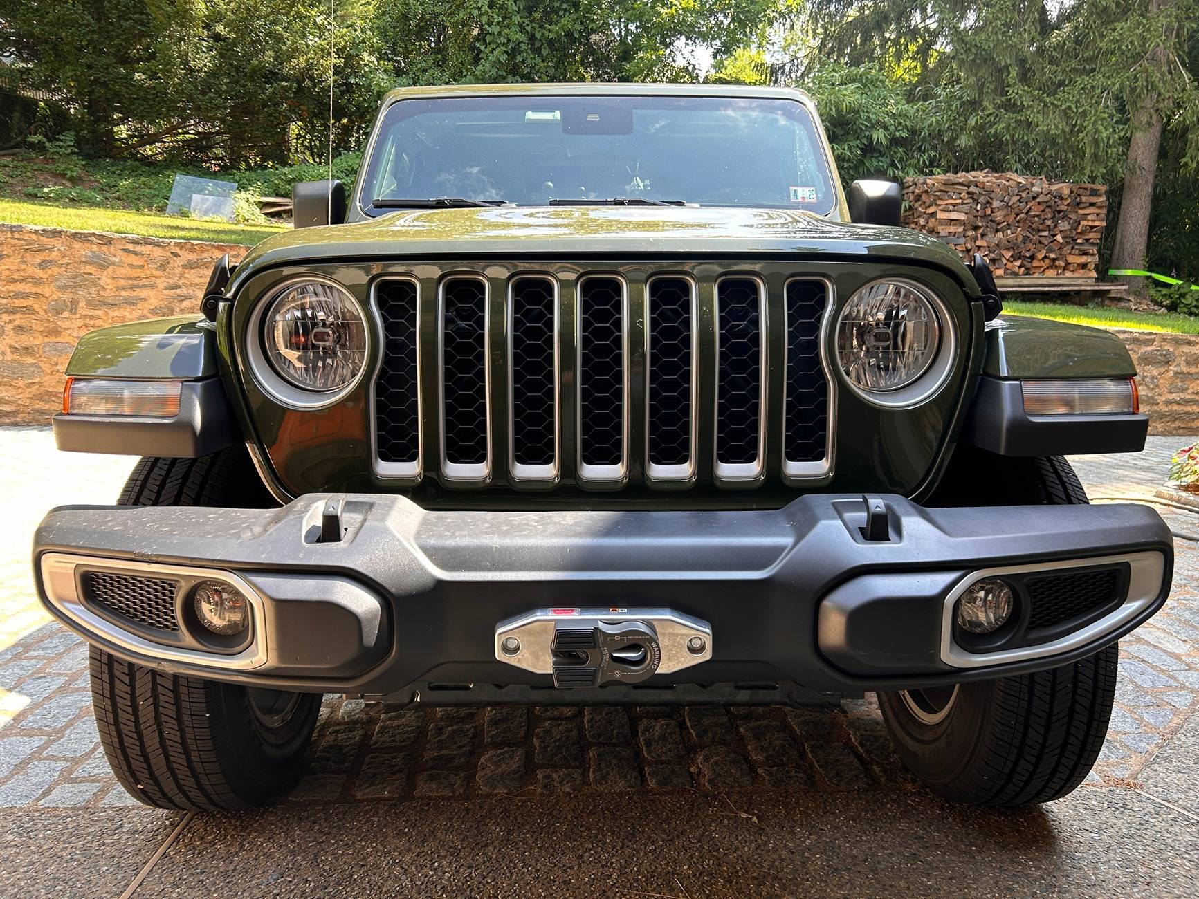

This LoD on the right for the low recessed install??

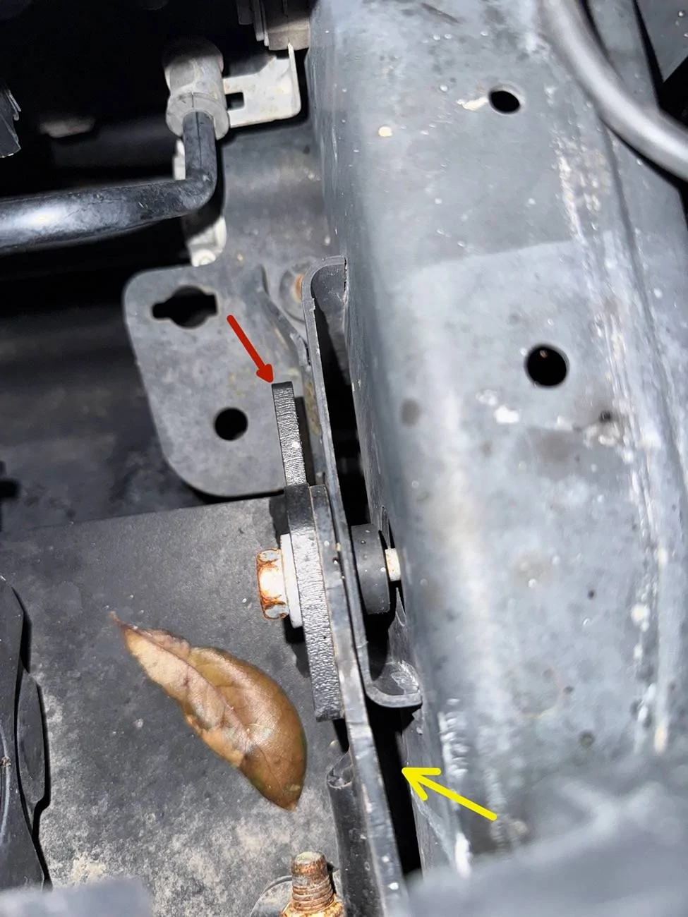

1. It's dark and I'm going by what I can see but yeah I think it's 1/4". I'll add a pic below, it’s the part indicated by the red arrow. The yellow arrow points to the bracket that the bumper bolts through, for size reference.
2. I used an old smittybilt 12k X20
3. See answer to #2 above.
4. I imagine the bumper would fare better against any off center forces than the furled mount itself given the fairlead mount is metal and the plastic bumper has some give to it? Can't be too sure though.
5. I have a rubicon with factory metal skid and it worked just fine.

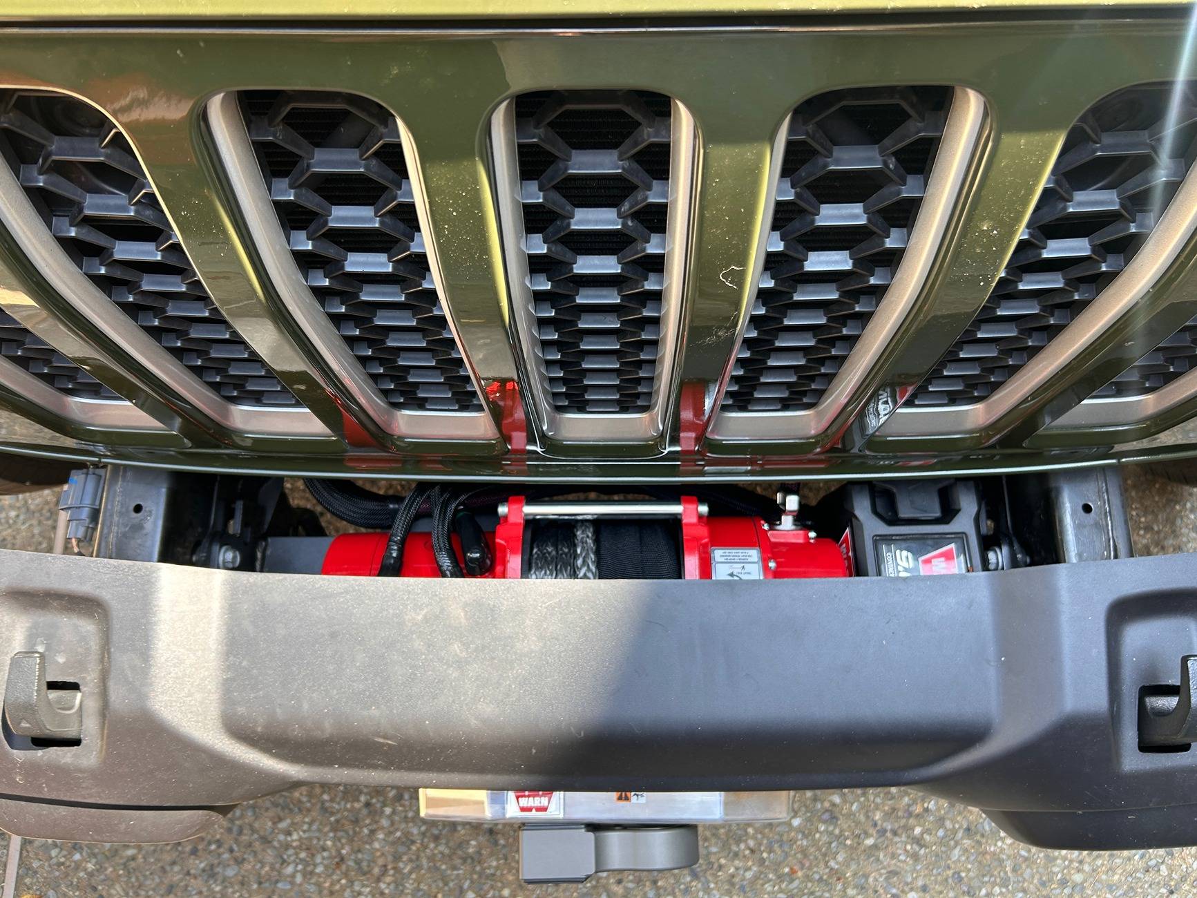

@Jaxmax was the inspiration for my plastic bumper winch installation. LOD Signature Winch Plate and Warn 9.0 RC winch. Jaxmax was able to fit his contactor under his hood, but I don't have the raised hood that he has so I mounted it next to the winch, it just fits!
