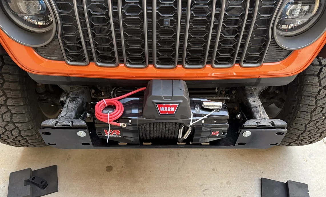

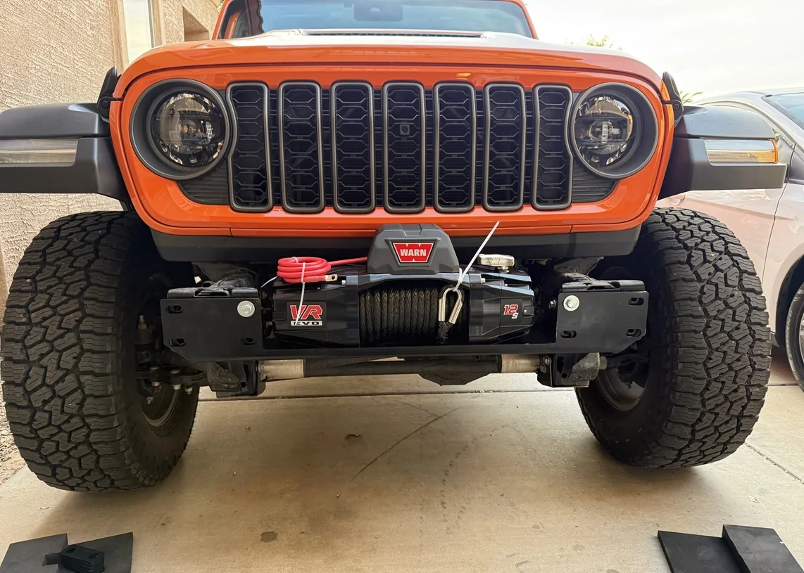

I recently did this, LOD/hf plate, warn evo 12s. I did the threaded inserts on the fairlead plate, and the stacked fairleads have a releif cut over the bolt holes so they still stacked flush against the fairlead plate from HF with the inserts sticking out some.
lots of cutting and trimming to minimize the material removed. I only removed enough on the top side so that the control box sticks out, the handle is easy enough to manipulate i didnt cut out there.
I'll post pics in an hour or so.

i only used the LOD included spacers behind the plate, none in front.

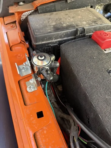

i'll redo the relay brackets later, just what i had laying around.
12s weighs 53.5lbs not including hook, or winch plate/fairleads.

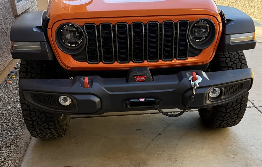

Jeep Gladiator Plastic Bumper Winch Club to
Jeep Gladiator Plastic Bumper Winch Club fr
Jeep Gladiator Plastic Bumper Winch Club dun
Jeep Gladiator Plastic Bumper Winch Club relay
