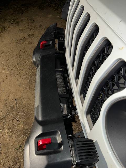

I’m about 80% done. What I’m stumped on is how you all got the fairlead bolts on and tightened up. The only way I can figure out how to do it is to mount the fairlead to the bumper before putting it on the the winch plate/jeep frame. There isn’t enough room to do it any other way…

Mine was super easy. Just pushed the bolts in from the front and reached in from the top with a wrench to hold the nuts. The top of my bumper is cut out so I Can see the entire winch. My fairlead mount was bolted in when I mounted the winch to the LOD plate.

I was trying to keep the top mostly covered with the bumper but it’s looking like I might have to cut it to expose for the bolts and all that…
I like the looks of more of it covered!

I bolted the fairlead mount to the bumper and fairlead and tightened everything prior to reinstalling the bumper.

Well there is the once and done way, tape a lock washer and nut on the inside of fairlead, put bumper on then put the bolts in tighten by hand pulling on the bolt until the lock washer bits then tightened it up. BUTT won’t be fun to take off probably have to to drill out the bolt head , that’s the reason for an Allen head bolt.
Ok or get under the jeep and use whatever extensions and angle adaptors you need to get it on, then there is always the closed end wrench with the nut taped in , tape anything you need to the wrench to make it longer or bent to get it in there somehow.

If you follow Mav’s build he used two cheap Amazon hausers for spares to fill the gap between plastic and fairlead, perhaps using a 3/8” coupling nut fasten to fairlead , then mount it all up and put bolts through hauser into the coupling nut. If all of this doesn’t help walk away do something perhaps drink a beer and come back and look at it, it’s nice to have the winch pretty covered up and concealed…..Jack
