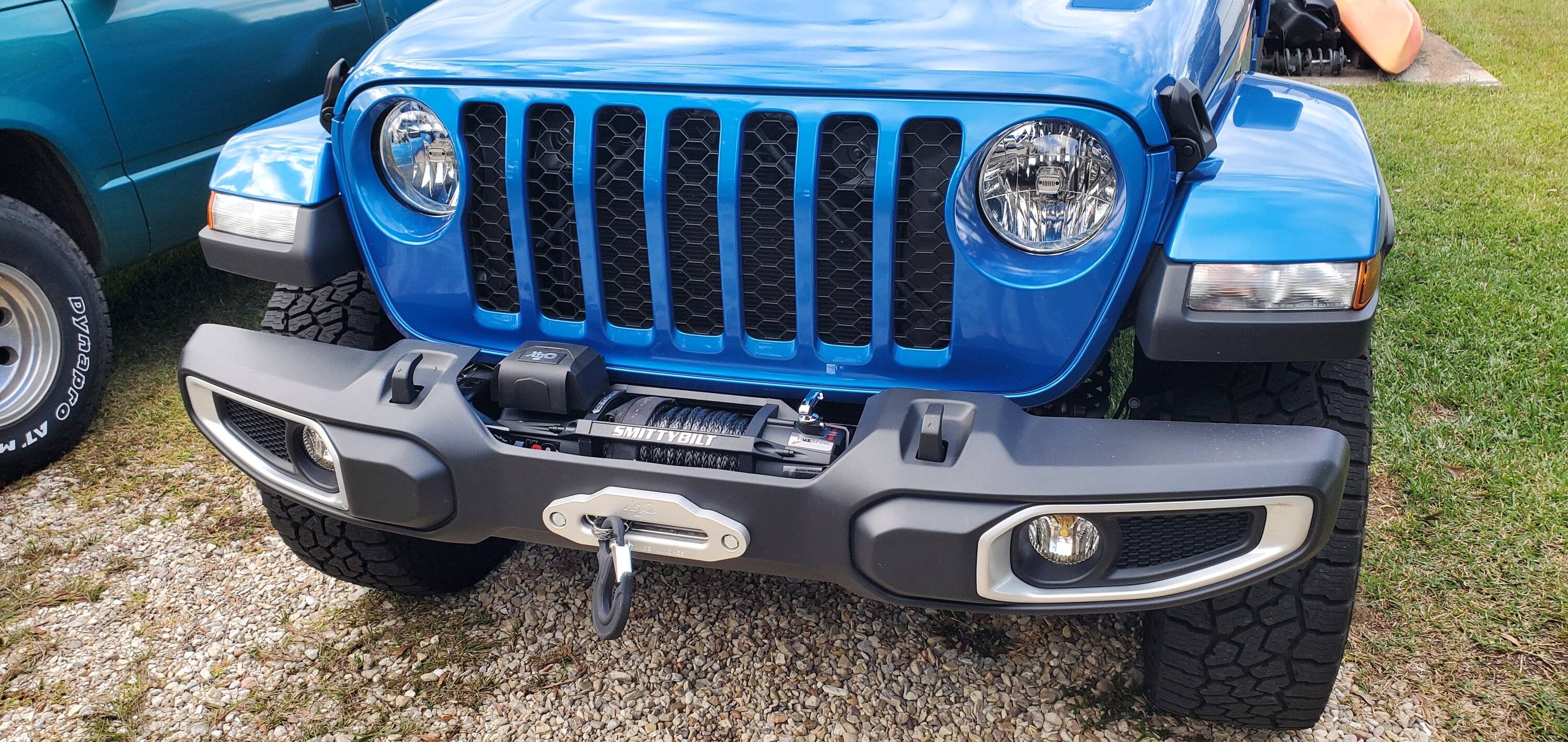

I think Chris stacking the fairleads was a great way to do it. I had a piece of 1/4” 1”x3” steel angle I cut out the winch line opening with a holesaw and sawzall drilled the holes to match and spanned the frame horns and it was solid I did drag a F-250 up a hill at a thirty degree angle about and no movement .
At this time I realize I have to resign from the plastic bumper club as I scored a very nice Mopar Performance Parts mid width steel bumper that I could not resist! But still amazed how talented these guys are doing these………Jack

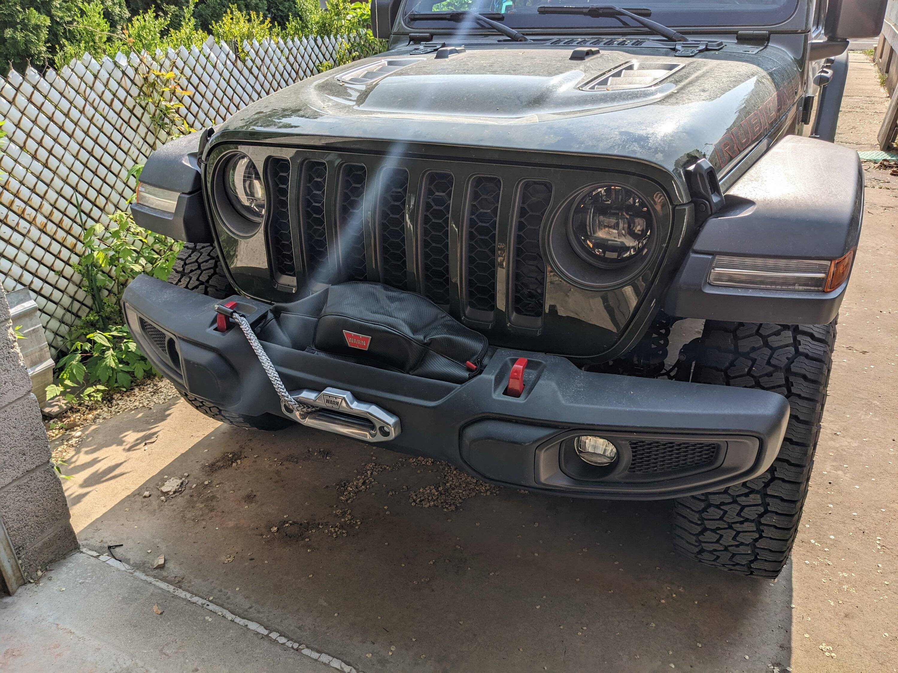

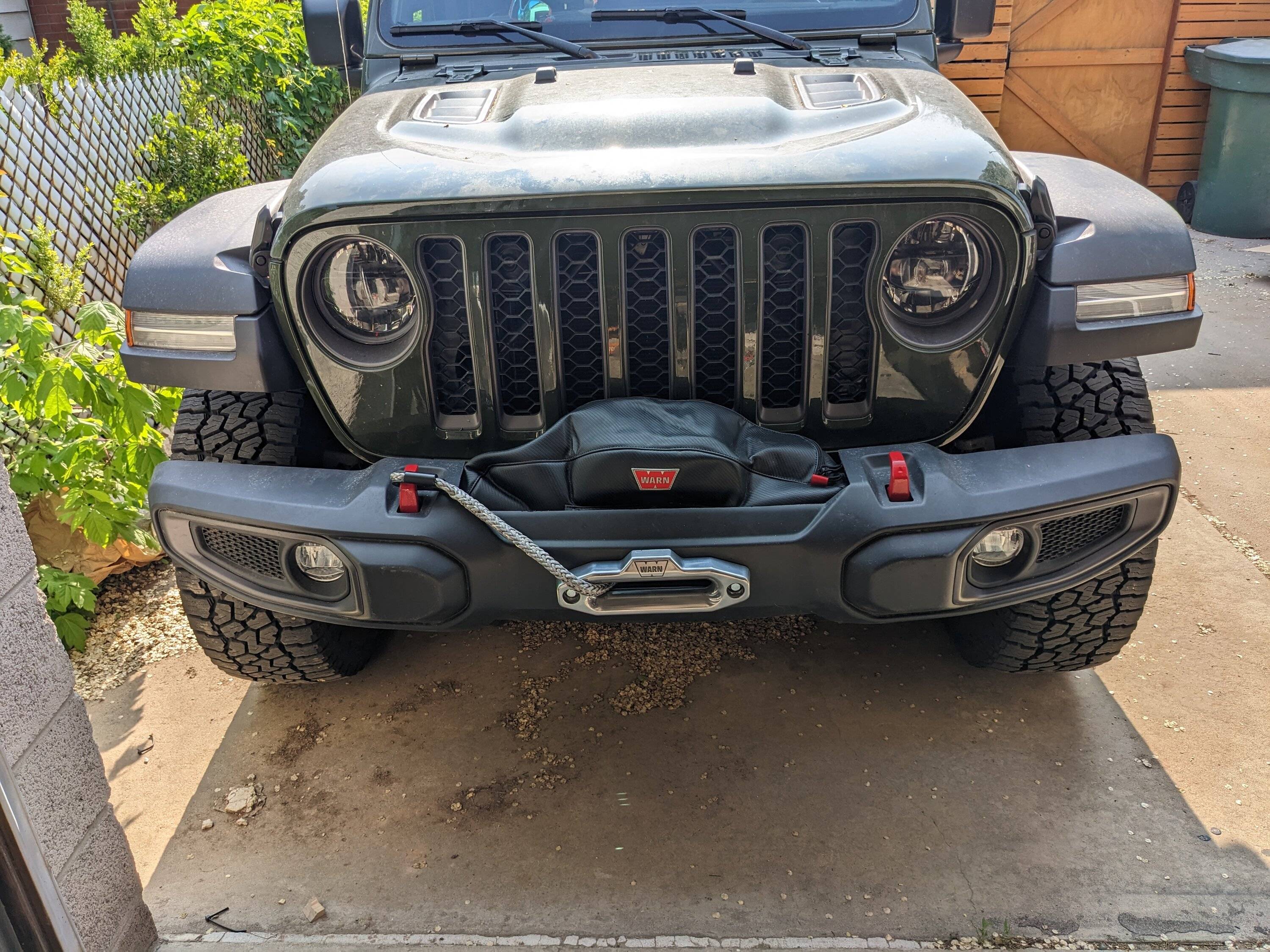

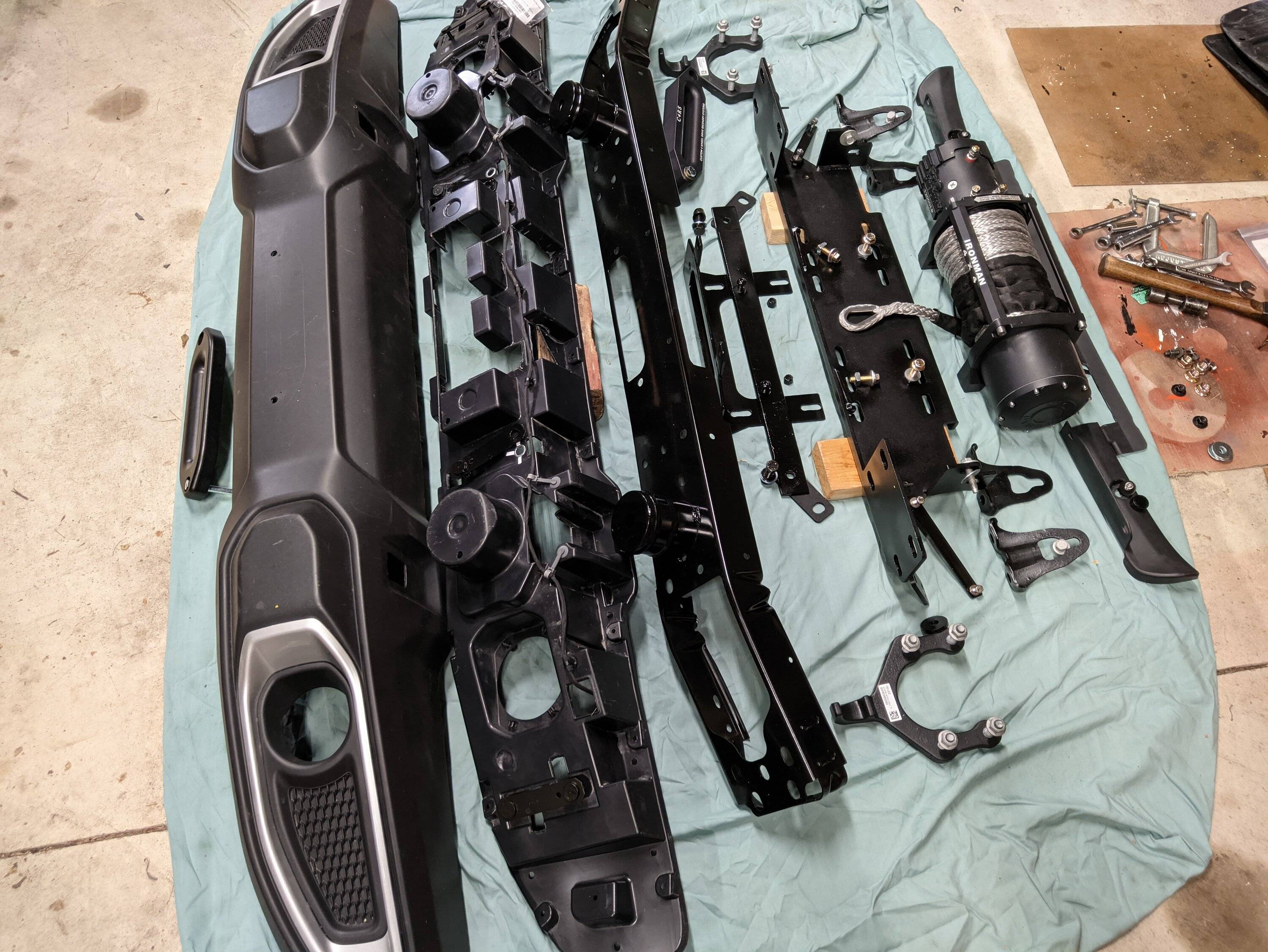

I recently did this, LOD/hf plate, warn evo 12s. I did the threaded inserts on the fairlead plate, and the stacked fairleads have a releif cut over the bolt holes so they still stacked flush against the fairlead plate from HF with the inserts sticking out some.
lots of cutting and trimming to minimize the material removed. I only removed enough on the top side so that the control box sticks out, the handle is easy enough to manipulate i didnt cut out there.
I'll post pics in an hour or so.

I’d be concerned about the fair lead, but I’m glad it’s working out for you guys. I didn’t want to add more weight than I needed to, my winch plate and winch are heavy enough, so I did the MP Concepts aluminum one that looks and fits exactly like the OEM steel bumper.

i only used the LOD included spacers behind the plate, none in front.
i'll redo the relay brackets later, just what i had laying around.
12s weighs 53.5lbs not including hook, or winch plate/fairleads.
I didnt have any argument for doing this (winch in plastic bumper) other than I like to tinker and it will make people ask questions 😄
