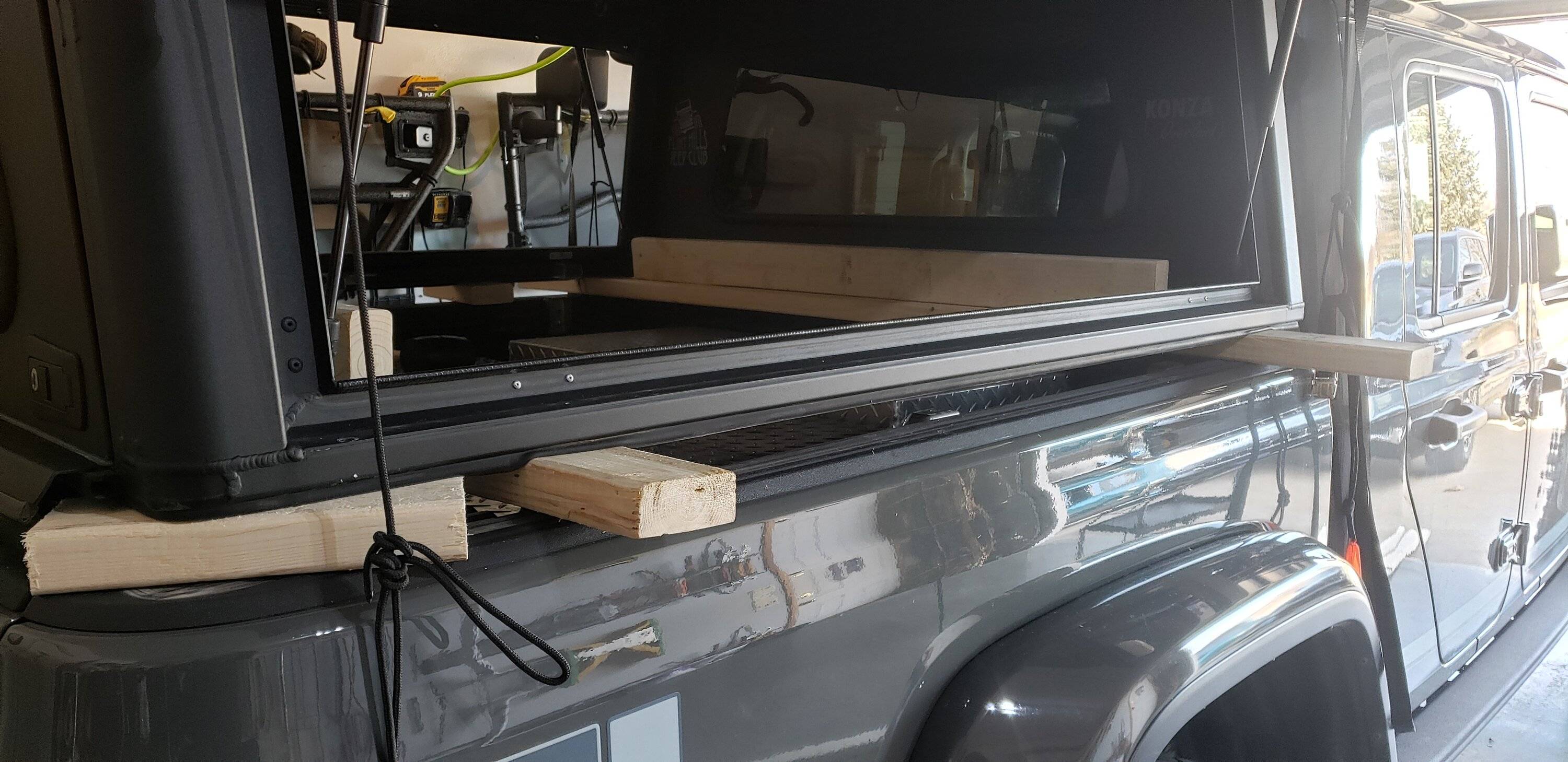

I should probably include that I have been storing it, on the rare occasion when it's removed, by putting lumber under it... which is getting old.
Not using the lumber will remove a handful of headaches.
Thanks in advance.

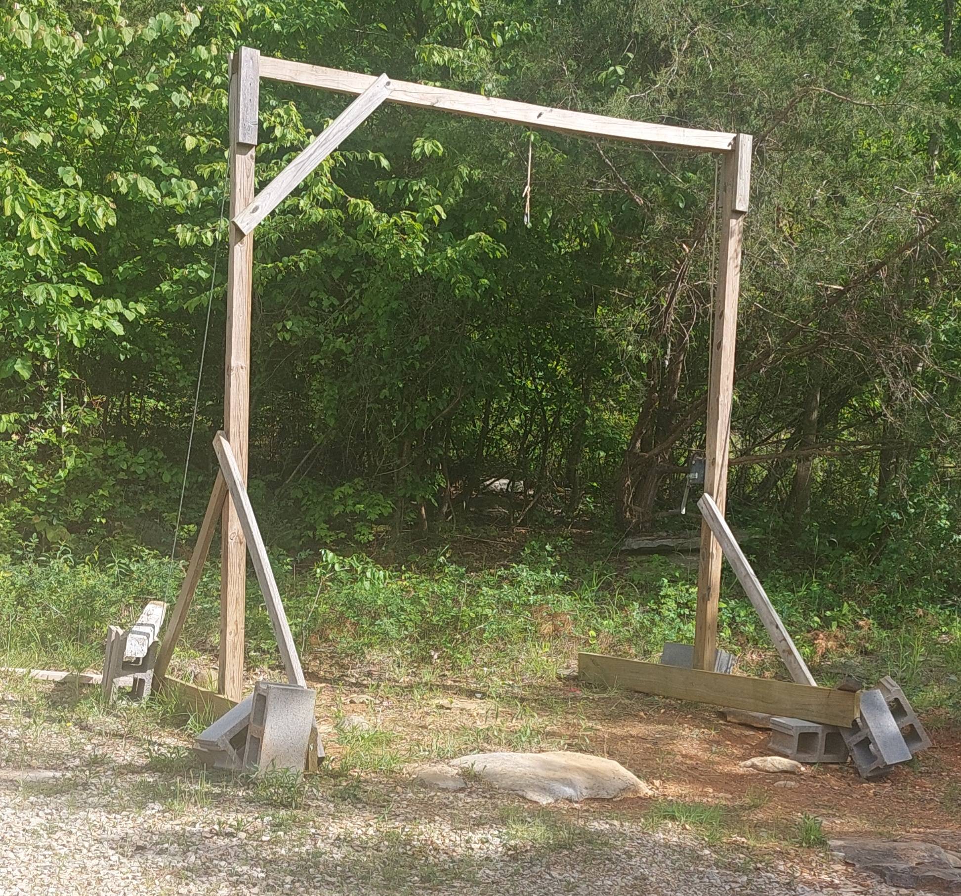

I'd get 4 eye bolts and do that in moment. I just hook to top of mine, it's a RLD topper, I've got U-strut on mine. I do know using 2x4s to lift my R.T.T. on and off is a P.T.A. So I understand your pain.
My hoist isn't that technical 3 4x4s with a screw winch outside.

My hoist is quite a bit more crude but works, I plan on relocating it and improving it some.... more bracing and adjusting the pulleys to line up better. With that I lifted the topper off my trailer and installed it. Should be some pictures on a old thread here somewhere.
Jeep Gladiator Hanging Alu-Cab Explorer Canopy? 20230504_161115
The concrete blocks was what I set my R.T.T. on other than one on right side it's keeping it semi level. I currently don't have a flat spot in my driveway. :facepalm:;)

I could not bring myself to hang in from only the roof rails.
I used 2x4 lumber that supported the topper in the same way it sets on the Trail Rails in the truck bed (as shown above but you can't see the 2 2x4s on the inside), then lifted it to the ceiling with a Harken Hard Top lift system. I did it 4-5 times before I eventually sold the topper, because I sold the Gladiator.
After doing it a couple times I got pretty good & quick doing it.
