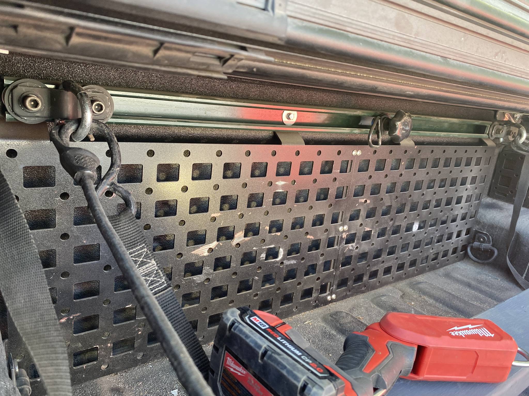

Don’t have experience with mounting the Alu cab but I do have rails comparable with the Mopar Trail Rails. I found the Unistrut rail mount works well in place of the Mopar trail rail system at a much lower cost.

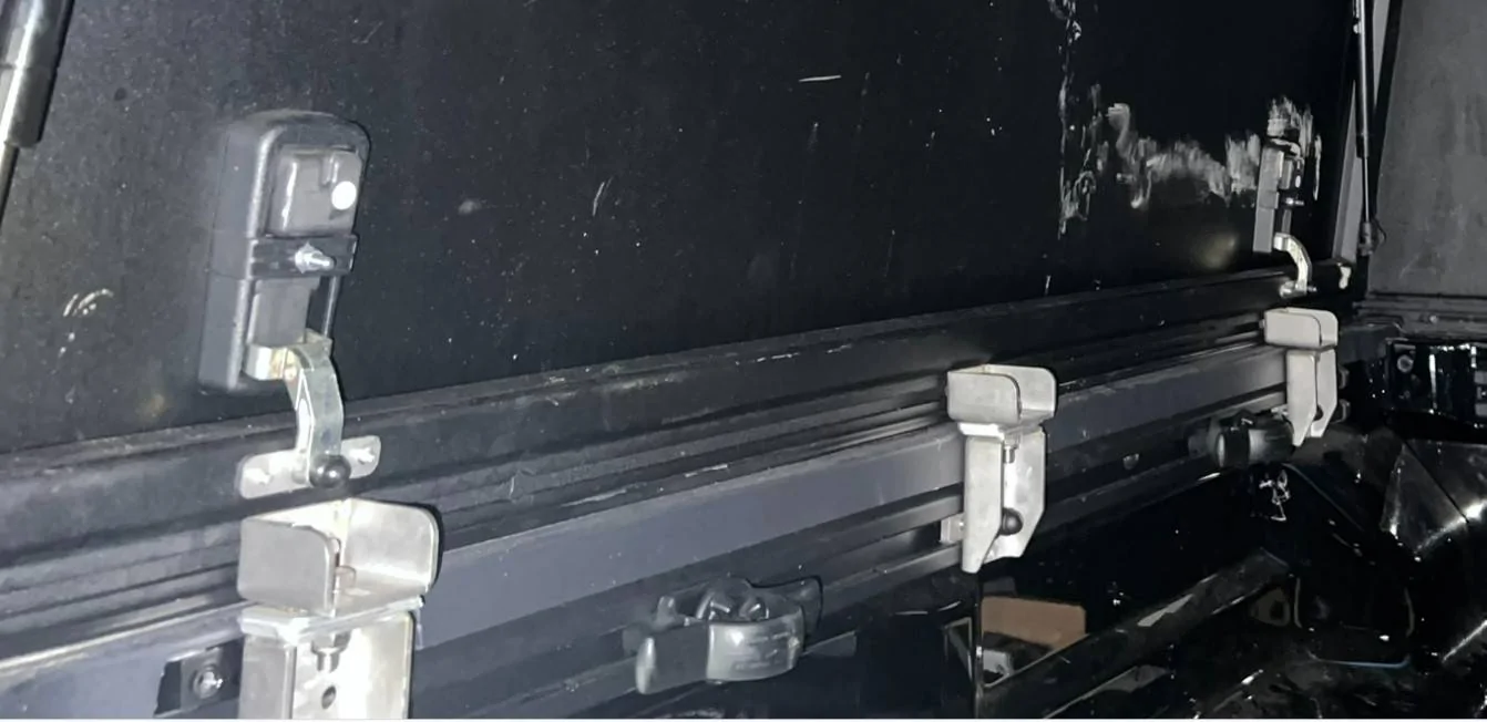

My only complaint is with the latches here in the frozen north they constantly freeze up. I don't even bother locking them anymore.. I'm probably going to replace them with something else...

Now that you mention it, I am having the same issue with the locks. Like you I just stopped locking them this winter. Need to find a solution for this though as it is a bit frustrating.

Early in the winter my locks on my RLD camper iced up a lot. They are the same style of lock as AluCab and others. The first several times I took a small torch to heat it up. Then used some WD-40 and that temporarily resolved it until it hit -20 and the WD froze. So went back to the torch and since then, it's still been freezing at night and morning, no problems. I picked up some graphite lock lube a few weeks ago and will put some of that in this weekend. If you're not familiar it's a nice dry lubricant that won't freeze. Might work for you as well. Worth a try.

I ran into the same thing this winter and mine is garaged 99% of the time. Kind of at a loss as to how they didn’t think to incorporate something like this into the standard package.
https://www.alu-cab.com/product/push-button-lock-cover/
I’ve been meaning to pick up a tube of the graphite lock stuff.^

I too will be buying the lock covers. I found out, in addition to them holding water & freezing, they attract tiny dust/dirt & can get gummed up with that trail debris if it's raining.
WD40 spray attracts dirt so don't use that. Graphite spray sheds dirt... but with the lock covers maybe I wouldn't need to spray them very often, if at all all.

Yeah, being developed in SA probably didn't lead to much winter testing lol, but I definitely wish those covers were included for how much these things cost.
The graphite lube was a game changer for using the locks day to day, but I haven't seen any improvement in the winter.
I carry my dewalt cordless heat gun as my "winter key"
Bottom line I hate having up to 6 fiddly locks to deal with when I'm using the cap a lot. My current plan is to replace each of the existing latches with one of these (well one per door anyway) and add power locks that work with the jeep fob..
